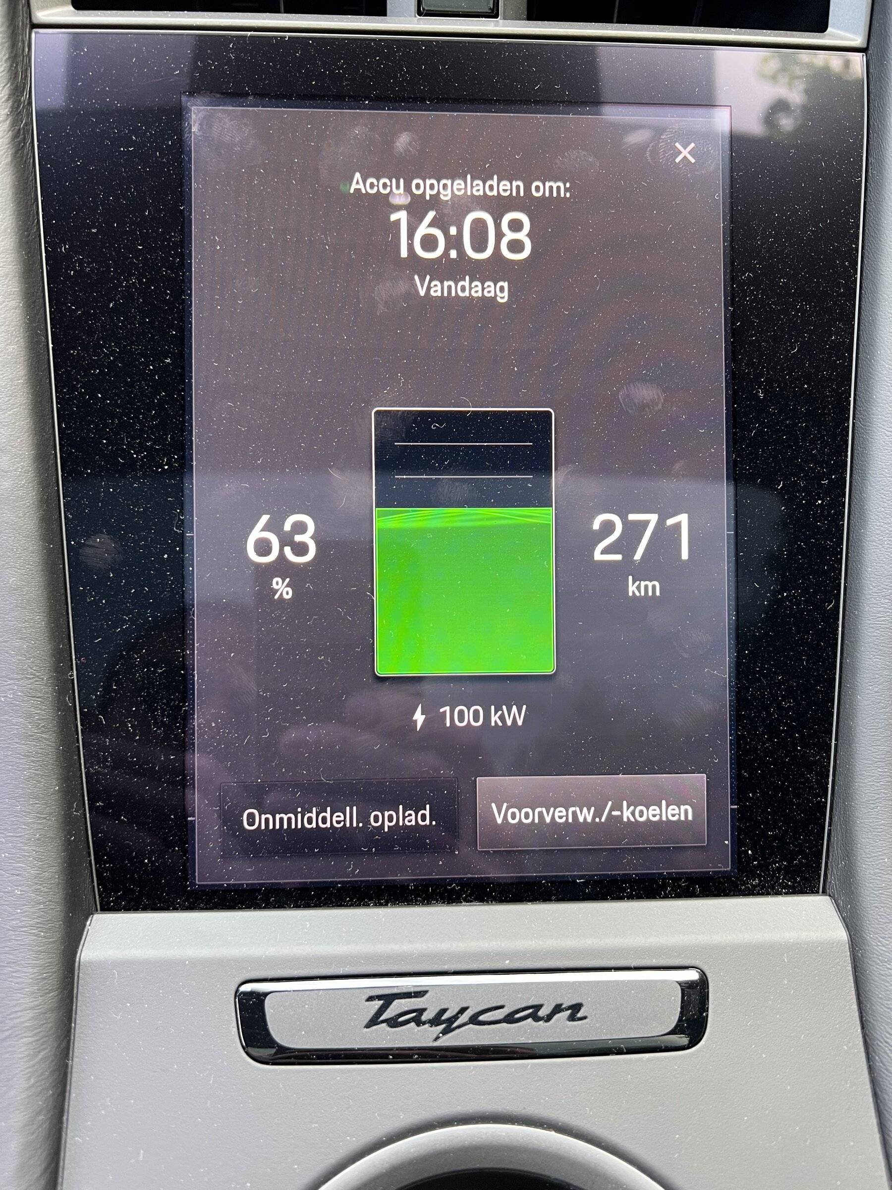

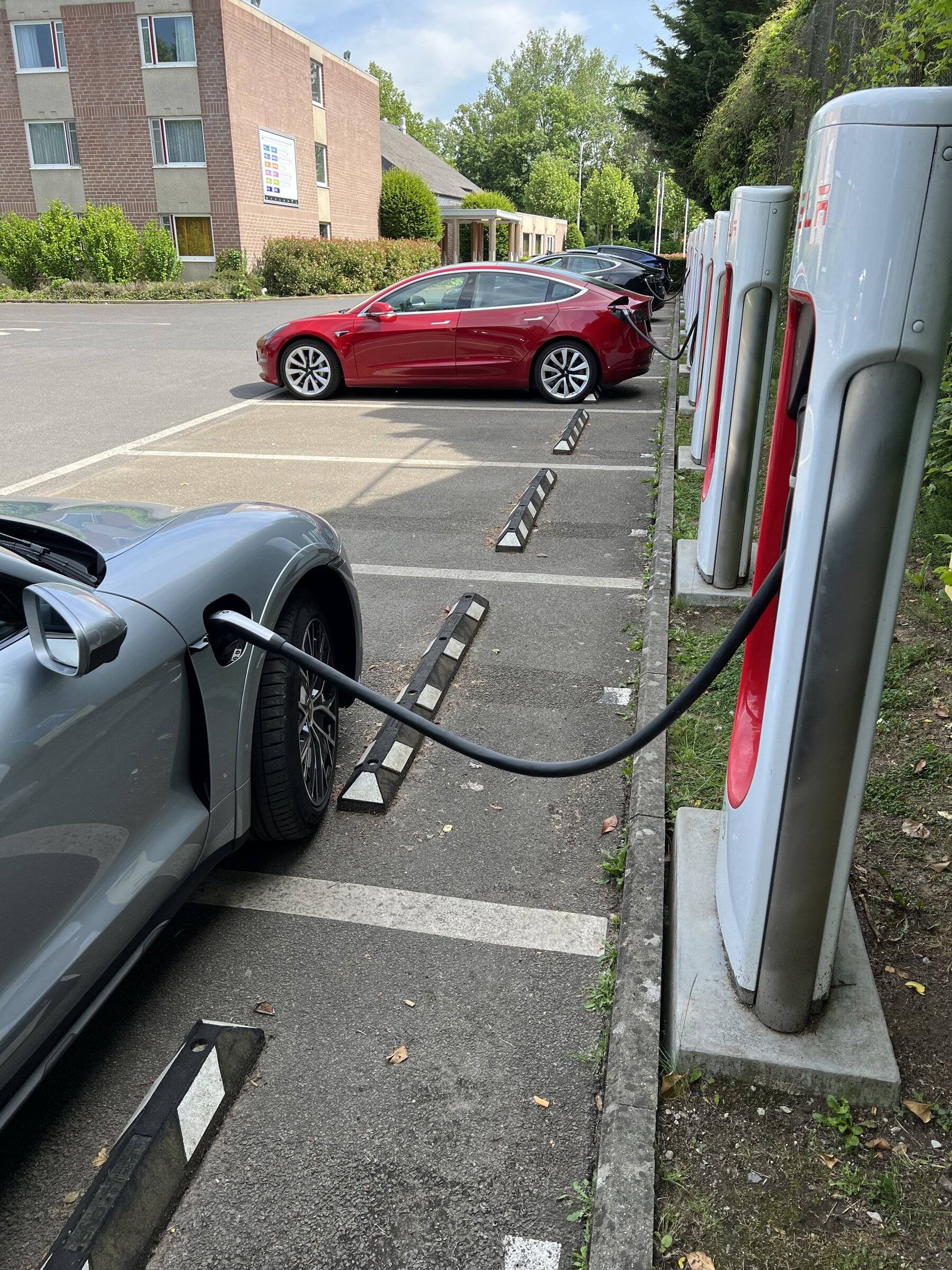

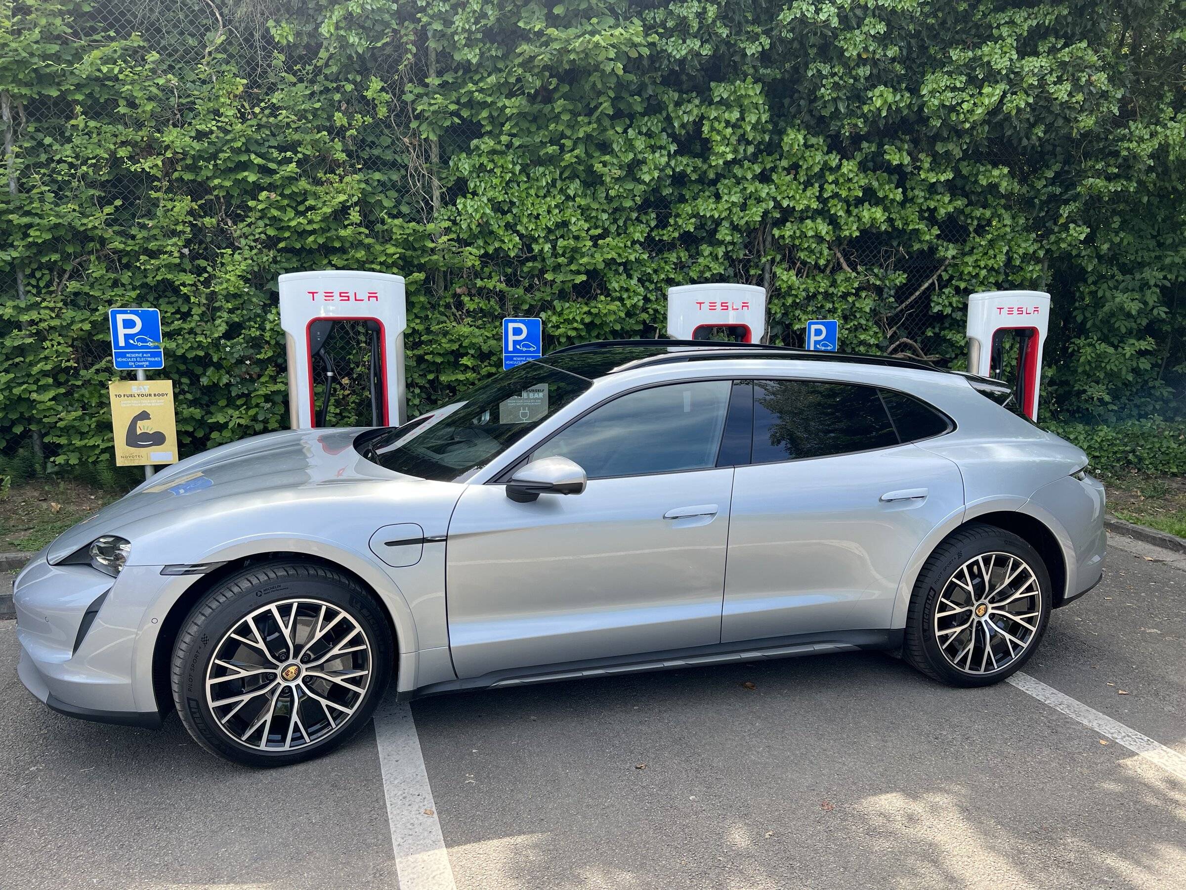

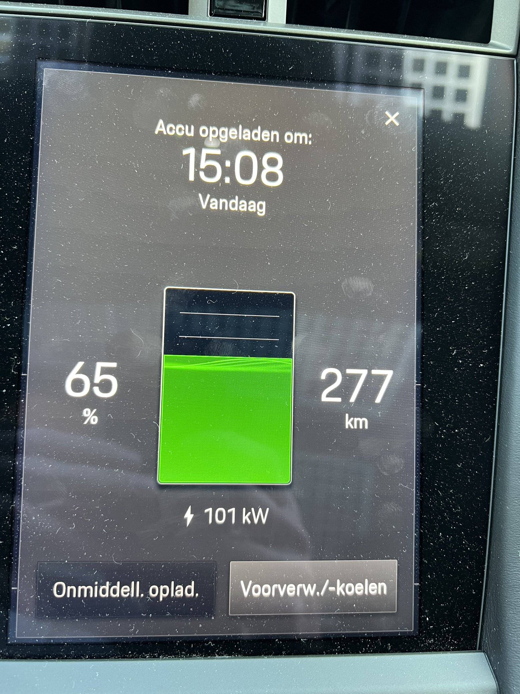

Gave it a try today. The cable was too short. There were a lot a free stalls and I asked the charging Tesla guys if it would bother them if I put my car in the wrong position. I al ready made an account at home. Connected within a couple of seconds. And I was charging at 100 Kw with 60 SoC on a 150 kW charger. Disconnect after 5 minutes and didn’t leave my car not to upset any Tesla driver.
To conclude, I was able to charge, it worked well but not for busy holidays and I wouldn’t leave my car and drink a coffee.
One stall was the other wat aground and could have helped me but it was taken by a model x.
I think I could have charged with only blocking 2 spots but still no good solution. I only did it for a test today. I also clearly say that if you can’t put your car correct you can’t use it. I wonder what car would be able to charge with this configuration. I think I saw a Renault Zoe somewhere on the net. They have a port in front of the hood.
I think the one I tried now is a 150 kw v2 charger. On my way back I saw a v3 250 kw charger with the chargers between the cars and that would be more suitable for charging a Taycan. That one wasn’t open to everyone and I couldn’t try.
So for all Taycan owners. If you plan your trip with a Tesla charger, make sure you have one with V3 chargers between the parking sport or you could end up not being able to use it. Unless lots of unoccupied places and Tesla owners wanting to close an eye.

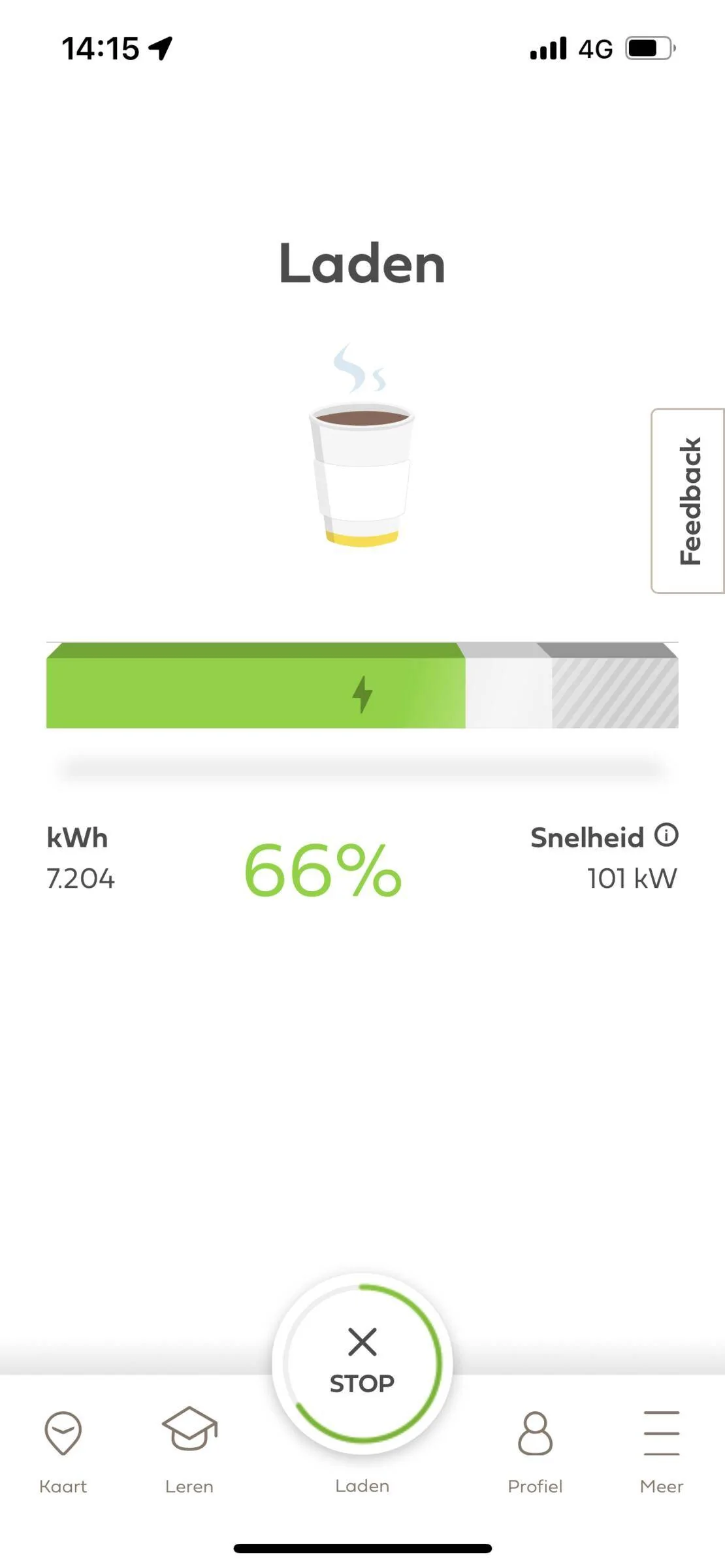

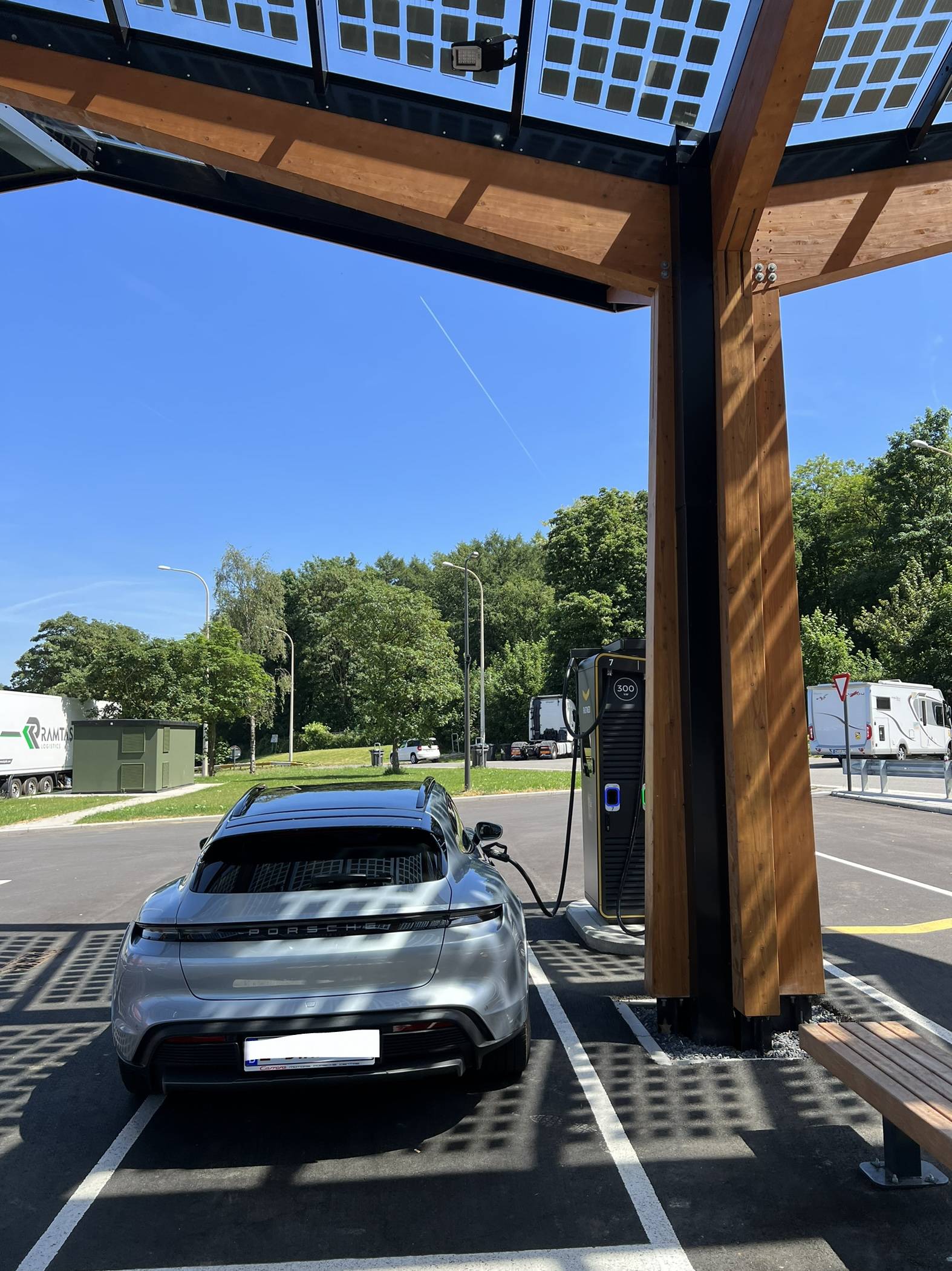

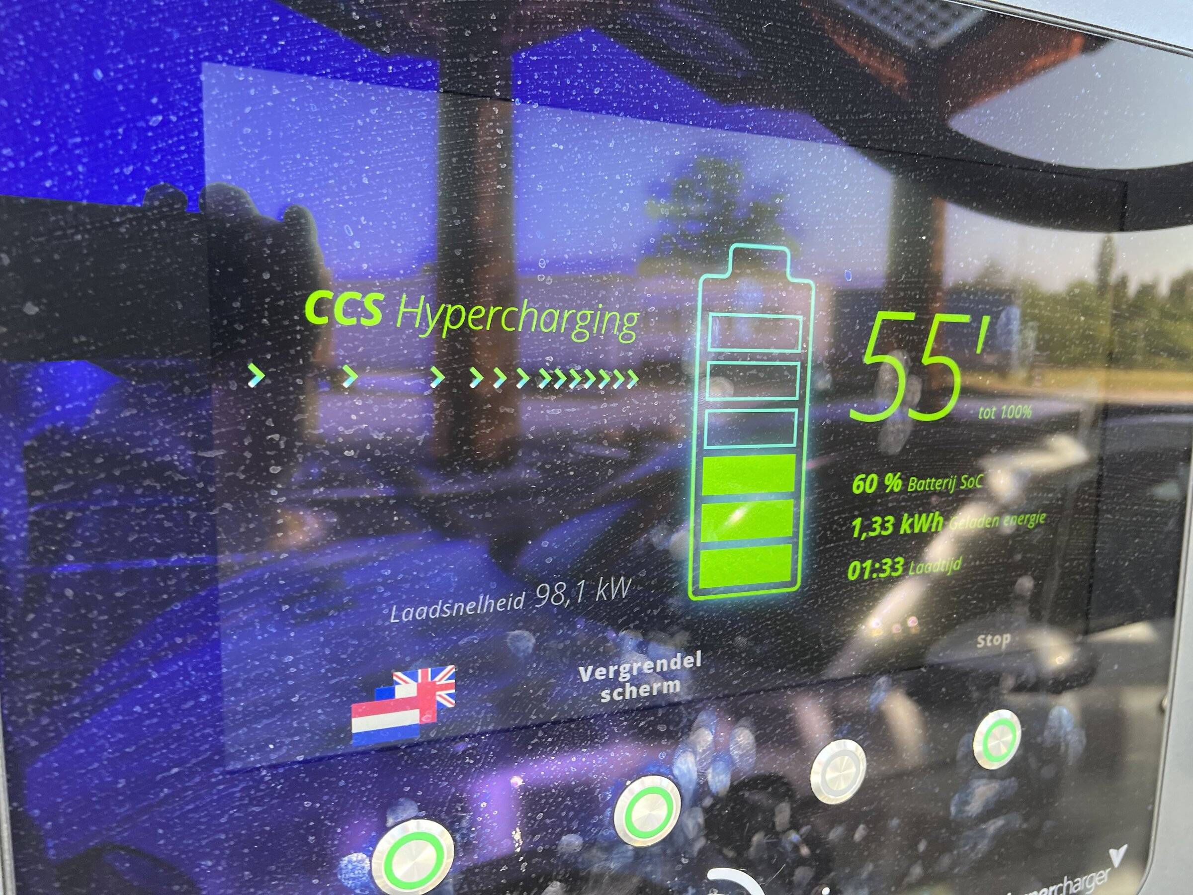

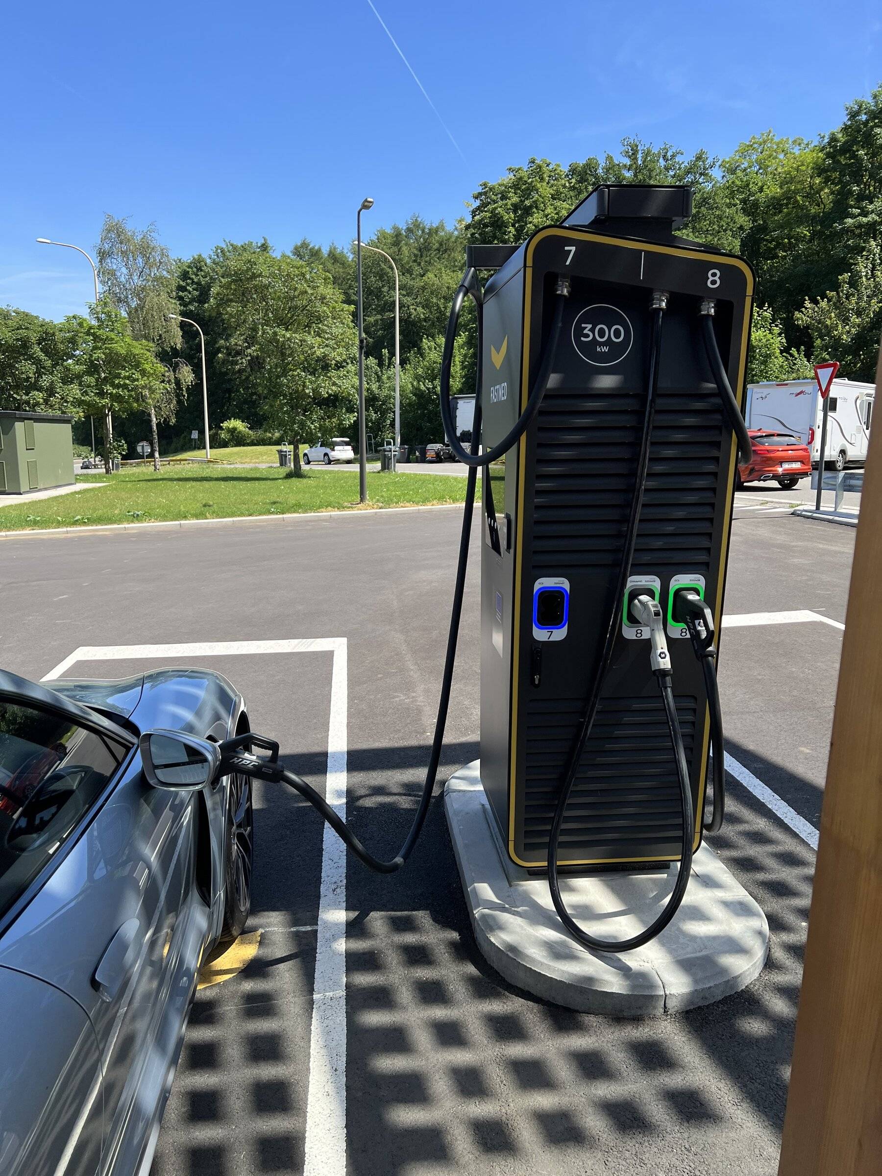

Also tried a Fastned 300 kW on my trip. Very good experience. On a highway parking also 100 kw with 60 SoC. Connection also with the app within a couple of seconds. Very easy to use and very intuitive. Better location and faster connection. However only 4 positions. The Tesla I would like to use in my holiday trip has 30 and half of them V3.

Yes. Very nice design. On a highway parking. Only downside is that is doesn’t have a restrooms or a shop. Many trees however.
