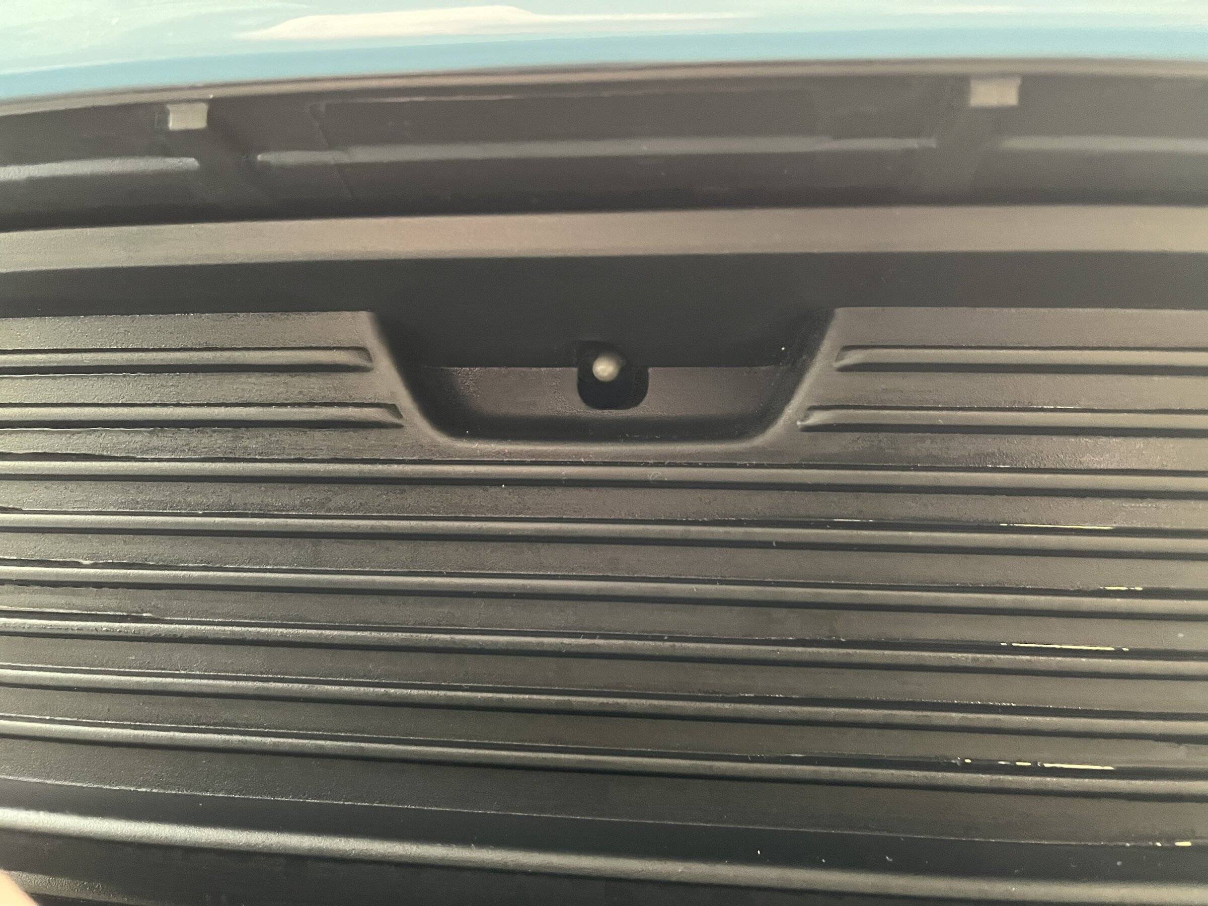

My MY22 CT4 is not equipped with the surround view option. I am contemplating adding an aftermarket front facing camera and possibly a backup camera as well. Can anyone provide any guidance with respect to removing the front center cover? I think the part number is 9J1807823COK1.
I am trying to determine if the center cover simply snaps into place, or if it is secured from the back side with bolts. Also, Is the sensor in the recess at the top edge of the center cover an ambient temperature sensor? I believe the factory front facing camera is directly in front of this sensor so it should be safe to mount a camera directly in the middle of the top edge of the center cover.

My car is not optioned with surround vision. I am learning to live with basic rear camera, but I would like to mount a WiFi camera on the center grille cover to facilitate parking at the EA stations. My experience is that the closer I park to the charger the easier it is to plug in the cable.
I have seen a few pictures of accidented Taycans where this grille cover has popped out of place. But I am having a very difficult time figuring out how to intentionally remove the cover. It's fairly easy to release the two tabs on the bottom edge. But the tabs on the top edge are a real challenge.
Is anyone able to offer some hints to remove the cover?

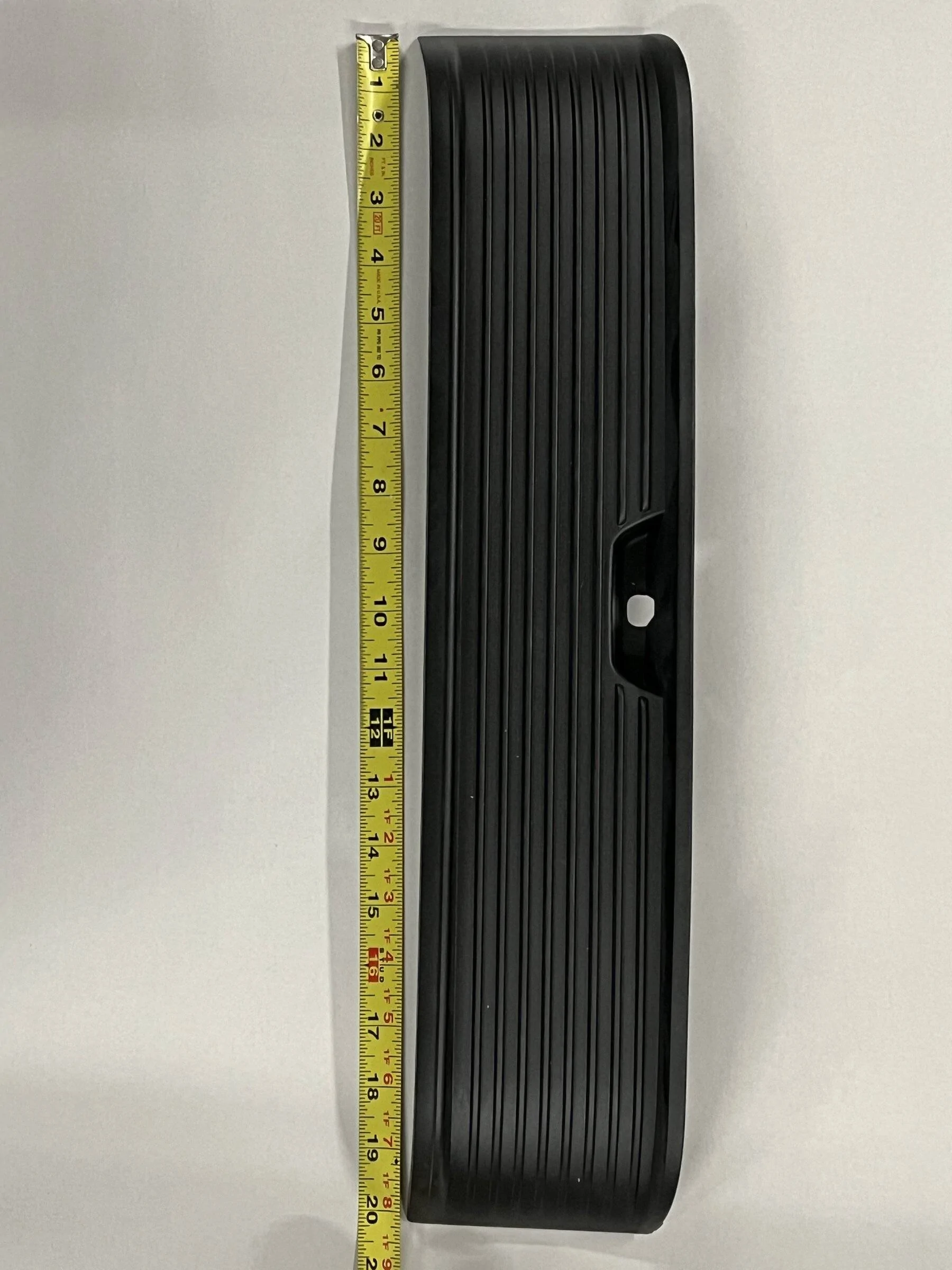

I received the 9J1807823OK1 part from Delaware Porsche a couple days after placing the order. This part number is for the "entry" level version of the part without holes or cut outs for options. The part is about 20" long and will more or less fit in the rear license plate area. However, the shape of the part may make it awkward to attach to the rear bumper.

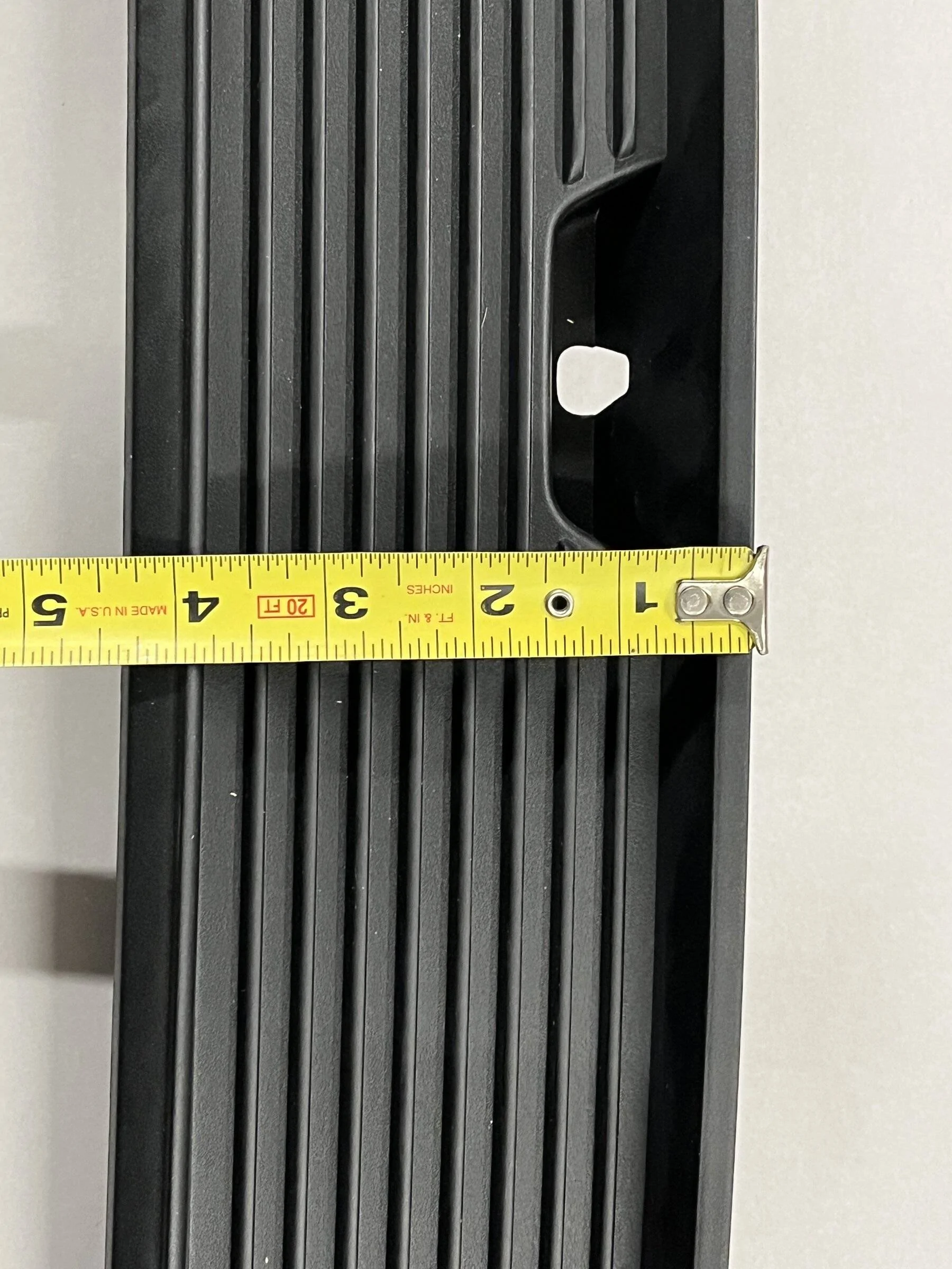

Thx for the update/share - any chance you could fire offf a pic or two? In hindsight I'd prefer to replicate the 'ribbed' design on the CT but still interested to see this piece if possible (maybe with a tape measure/scale beside it to get a better understanding of rib spacing) - asking a lot I know :)

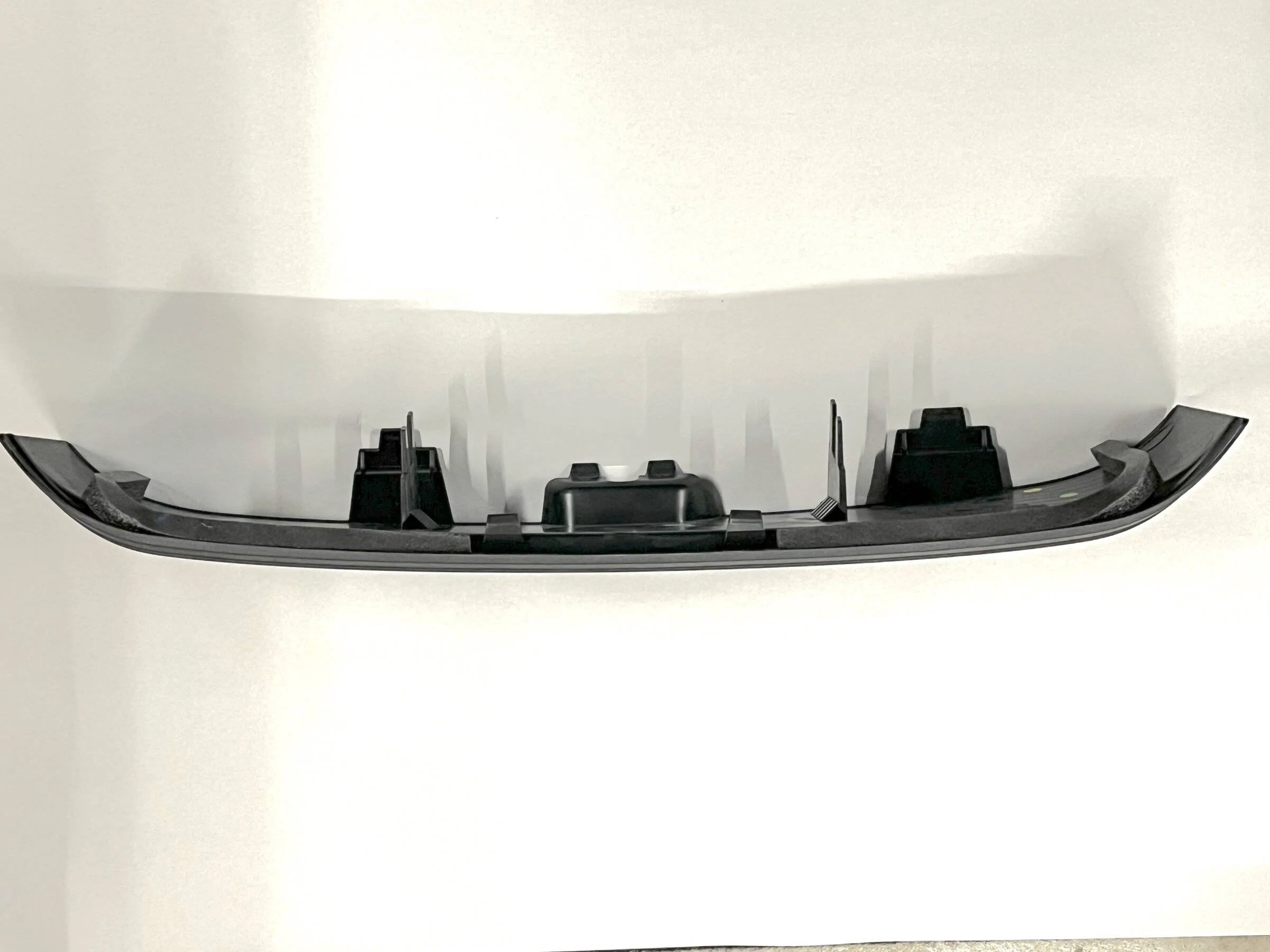

Here are three photos of 9J1-807-823-OK1. The length and height will more or less work for your application. But the depth of the part will probably not work well.

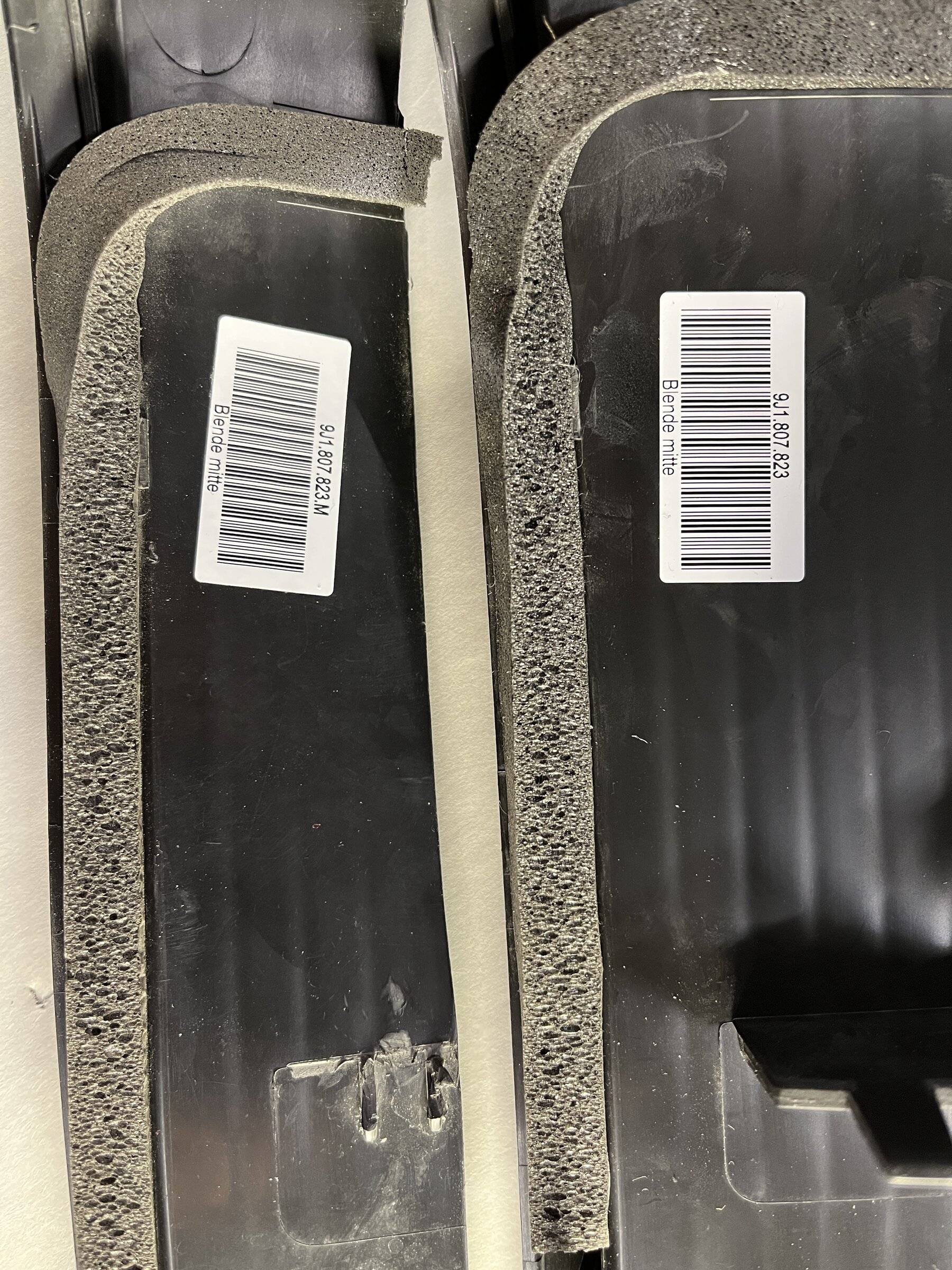

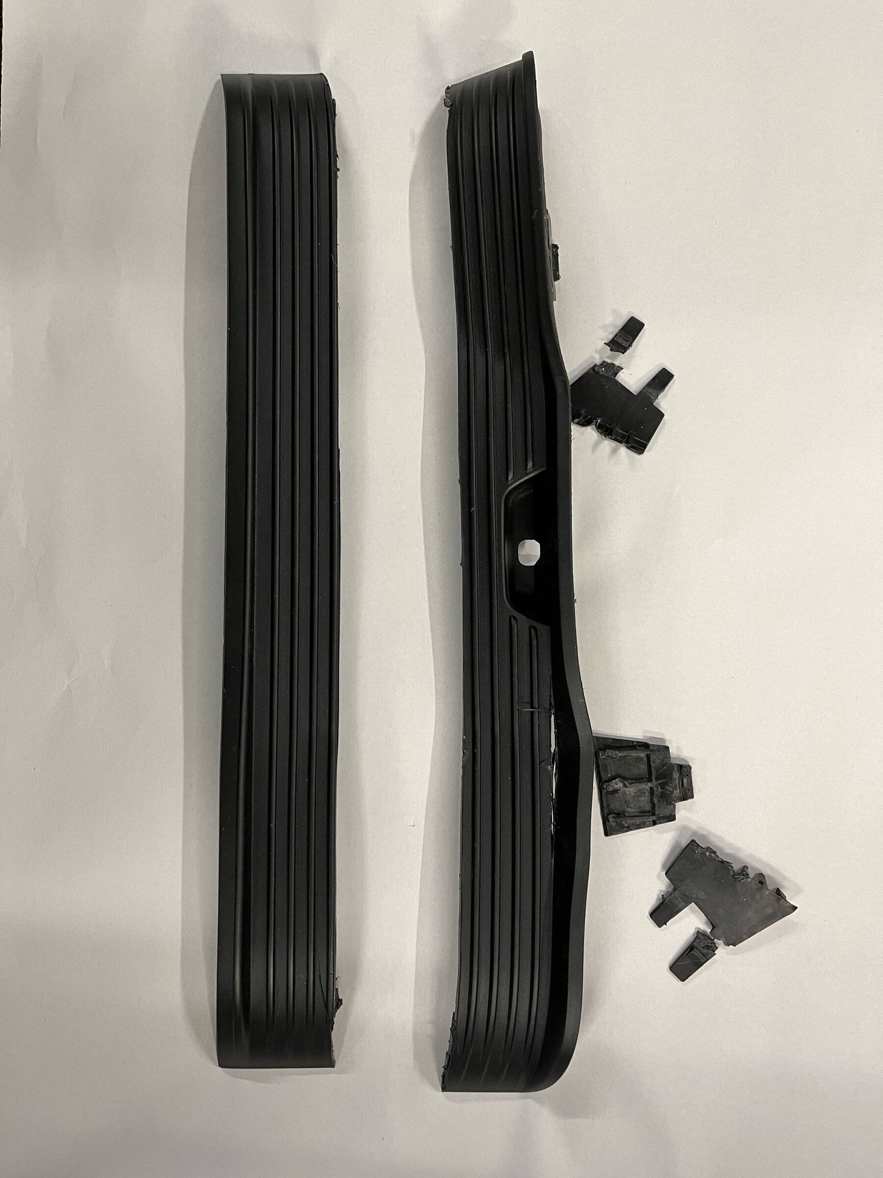

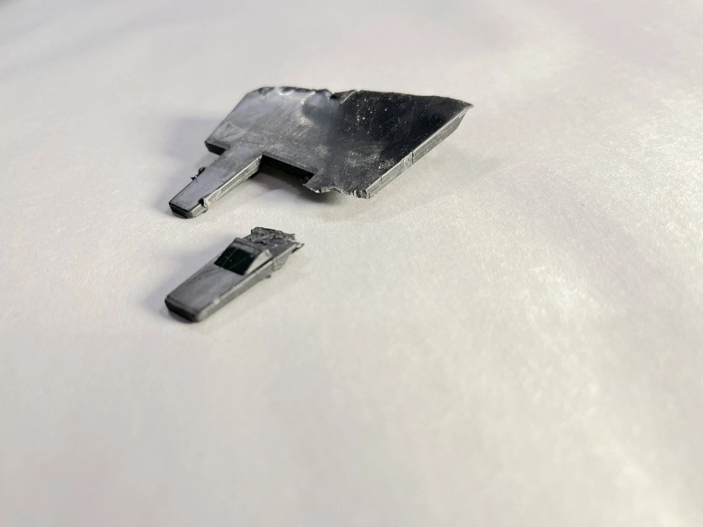

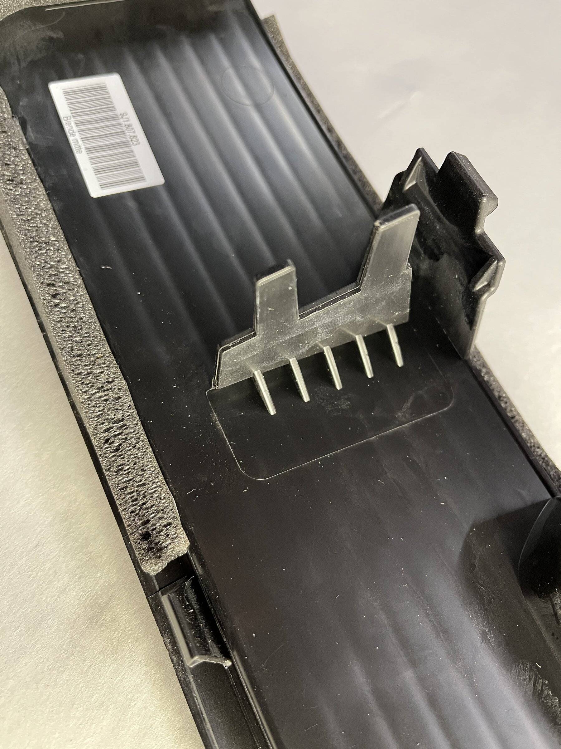

I tried unsuccessfully to remove the bumper cover following the instructions in the link Klepper provided. It seems that my October 2021 build CT4 has a slightly differently designed center cover. I ordered part number 9J1-807-823-OK1 which was the designated part for my VIN. Even with a spare version of the part in hand I could not figure out how to remove the part. As it turns out the factory installed bumper cover was part number 9J1-807-823-M. The replacement part I ordered from Delaware Porsche did not have an "M" suffix.
I gave up and cut the cover into two pieces using a utility knife. I discovered that the two vertical alignment fins each had one "leg" with a "barb" securing it in place. After cutting the cover off I was still unable to disengage the vertical fin and carefully cut the barbed leg off from the front and pulled the small piece out from the back side.
Hopefully this information will help anyone trying to install a 3D printed front license plate bracket which requires removing the center cover. I am wondering if this part was popping out of place too easily and the "barbs" were added to keep it more secure..
