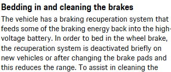

Make sure that your dealer 'beds-in' the brakes. There should be no noise whatsoever.
The dealer doesn't need to bed in the brakes. You can easily do that yourself. But you don't need to unless you are tracking the car...
It normally takes about 600 miles for them to do this on their own (with normal driving) but you can run through the bedding process by doing a bunch of high speed stops (almost a full stop) while allowing several minutes of cooling between them. I am familiar with BMW's published procedure and I'm sure Porsche has one as well.
However, you don't NEED to do this at all unless you are tracking the car. Regardless, my brakes have been quiet since the day I got them and I've never had to run through the process...
I'm very familiar with the process, having raced Porsches for quite a while now. You always want to bed in new brakes, track or not, for best performance and wear. Certainly you can do it yourself, but best to follow the mfg. recommendations. Typically you want to accelerate to 50-60 and brake very hard engaging ABS to a slow roll, and repeat a half dozen times or more. DO NOT brake to a stop, since this gives the heat nowhere to go. From the Taycan manual:
