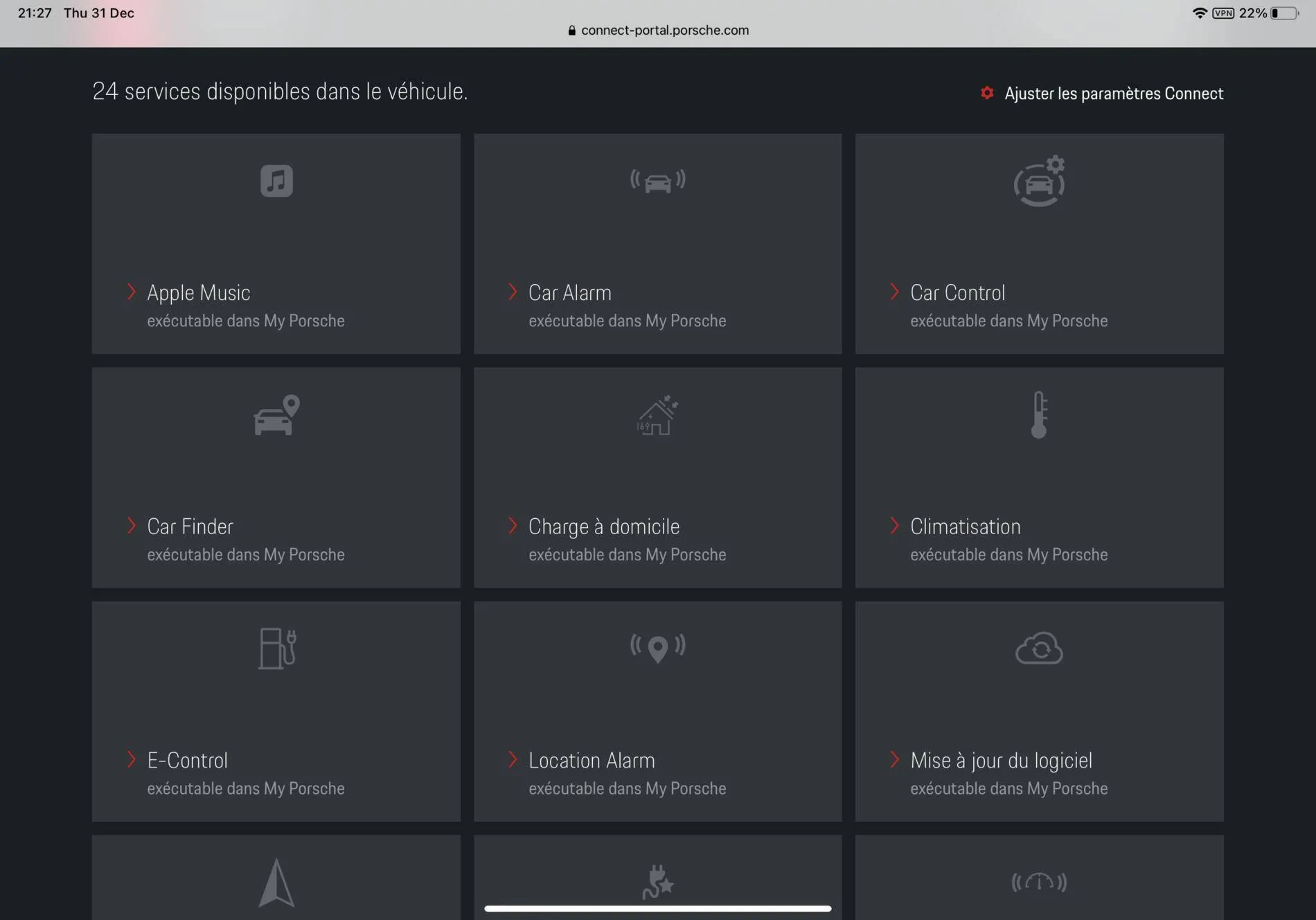

You ned to have logged in to your Porsche ID from the car as well. And the icon seems to nay show up once you have cellular coverage. Have you checked that you have LTE signal? Also check MyPorsche to see the services you have available in your account.
It should look similar to this.
Porsche Taycan Apple Music icon missing D0EBE337-1217-4B3C-9E58-5A5DE243E235
william_j_p
William
Jul 17, 2020
Warren, NJ
2021 Taycan 4S, Range Rover Sport
I logged into PCM at the dealership when I picked up the car. It shows my name on the PCM screen so I'm definitely logged in.
I also see that Apple Music box in Services.
I have an LTE icon on the right side of the display. I thought that could be the issue so I tried outside my garage also where the reception might be stronger.
I'll try checking again tomorrow. I just wanted to make sure there was nothing obvious that I was missing but it seems to just be buggy/inconsistent software.
