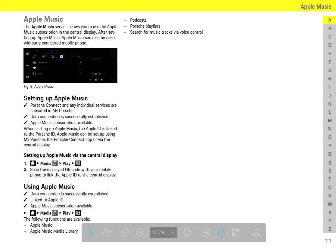

Ok but I don't remember having to link in two places following the original initialisation. Extract below (from Porsche Connect Good to Know Driver's Manual) sort of confirms it is optional where you do this. Probably not being of much help here but I would remove from the PCM, log out and then back in and on the proviso you have a good LTE service the Apple Music icon may re-appear (sometimes it's greyed out when the LTE is not strong enough).
That is the issue, I am set up on the PCM with Apple Music but when you go in to use it, you get the message that I showed in my thread. It seems that others are not having this issue post recall software update for the stopping of the car in mid drive. I am getting nowhere with the dealer on the issue. Resetting the PCM and logging out of the Porsche ID does nothing to change the problem.

Yes but can't you remove it from the PCM temporarily and see if it re-syncs based on what has been linked either in My Porsche or Porsche Connect App?
