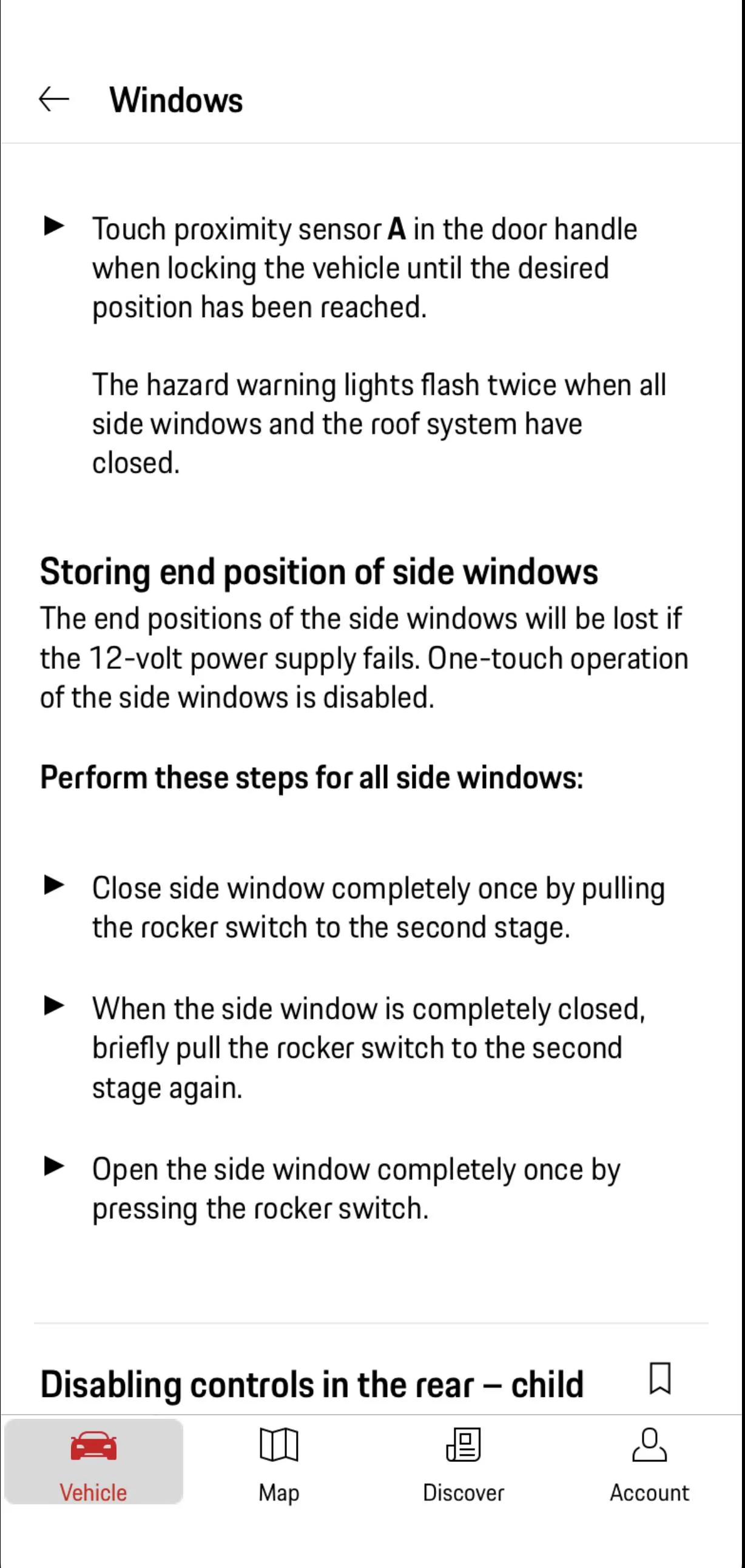

Maybe there is some reset that needs to done for the sensors? I found this in the manual:
Porsche Taycan Apps often says windows are open 16665740-CD0B-417B-A72D-AF130ADC251E

Quick update, the open windows came back after the car was parked overnight. I went to try the procedure @Scandinavian suggested and found one interesting fact - the car seems to have forgotten the window positioning information for both rear windows! The windows auto rolled down, but both would not auto roll up until I went through the programming edge conditions procedure. I know they auto rolled down and up but a week ago, because I did that once the tint was dry to make sure everything is ok with it. So it seems Porsche software is losing calibration data. :(

When I first got my car last year, I experienced the same issue as you, with the app reporting window(s) aren’t closed. I noticed the windows needed reset when 1 or 2 of the windows wouldn’t auto-close when you press (or pull?) & hold. I went through the reset procedure, so the windows would auto-close, and that worked for few times until I realized it the window wouldn’t auto-close again. I did a reset on all windows this time and that seems to have settled it all.
