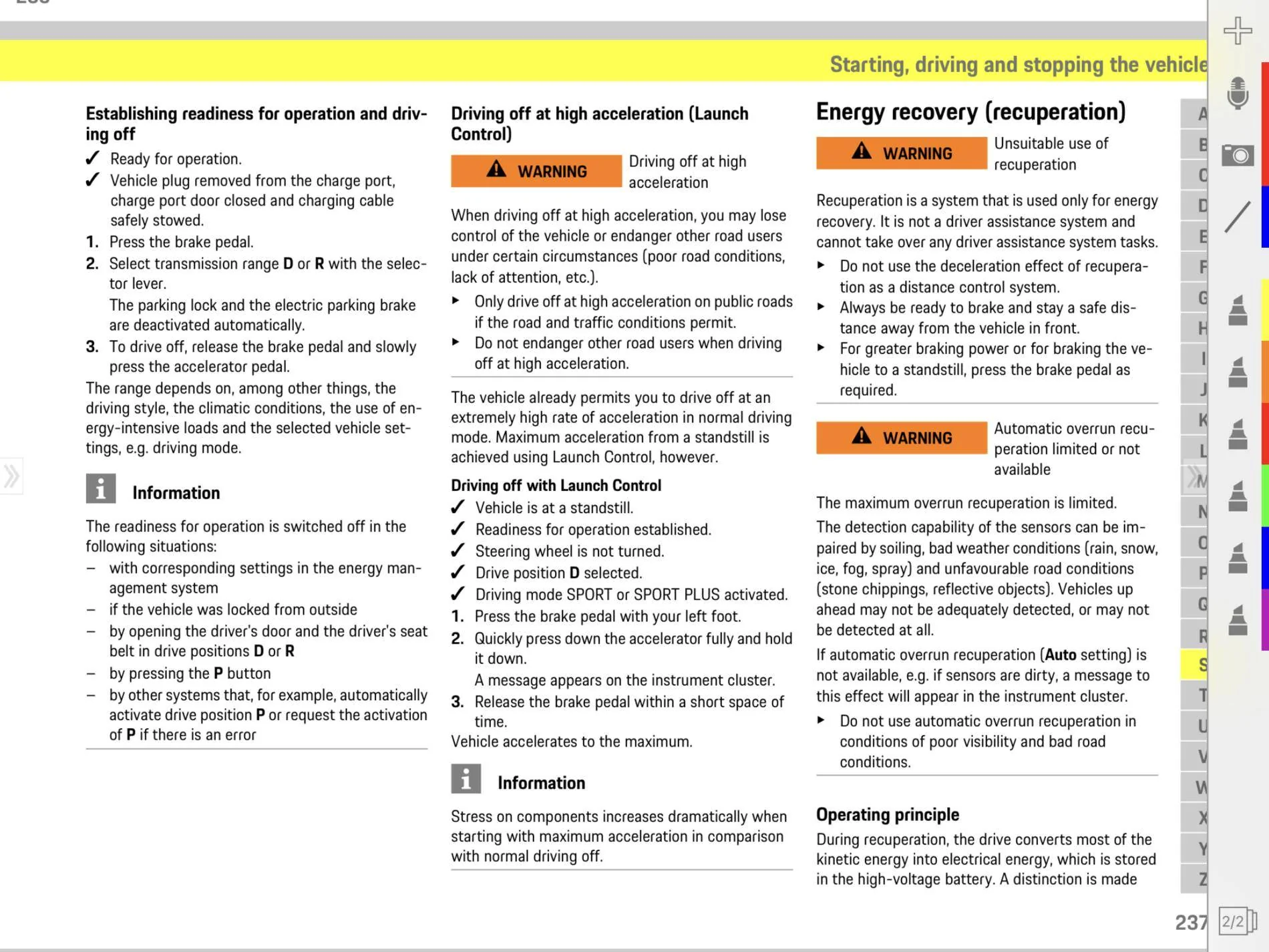

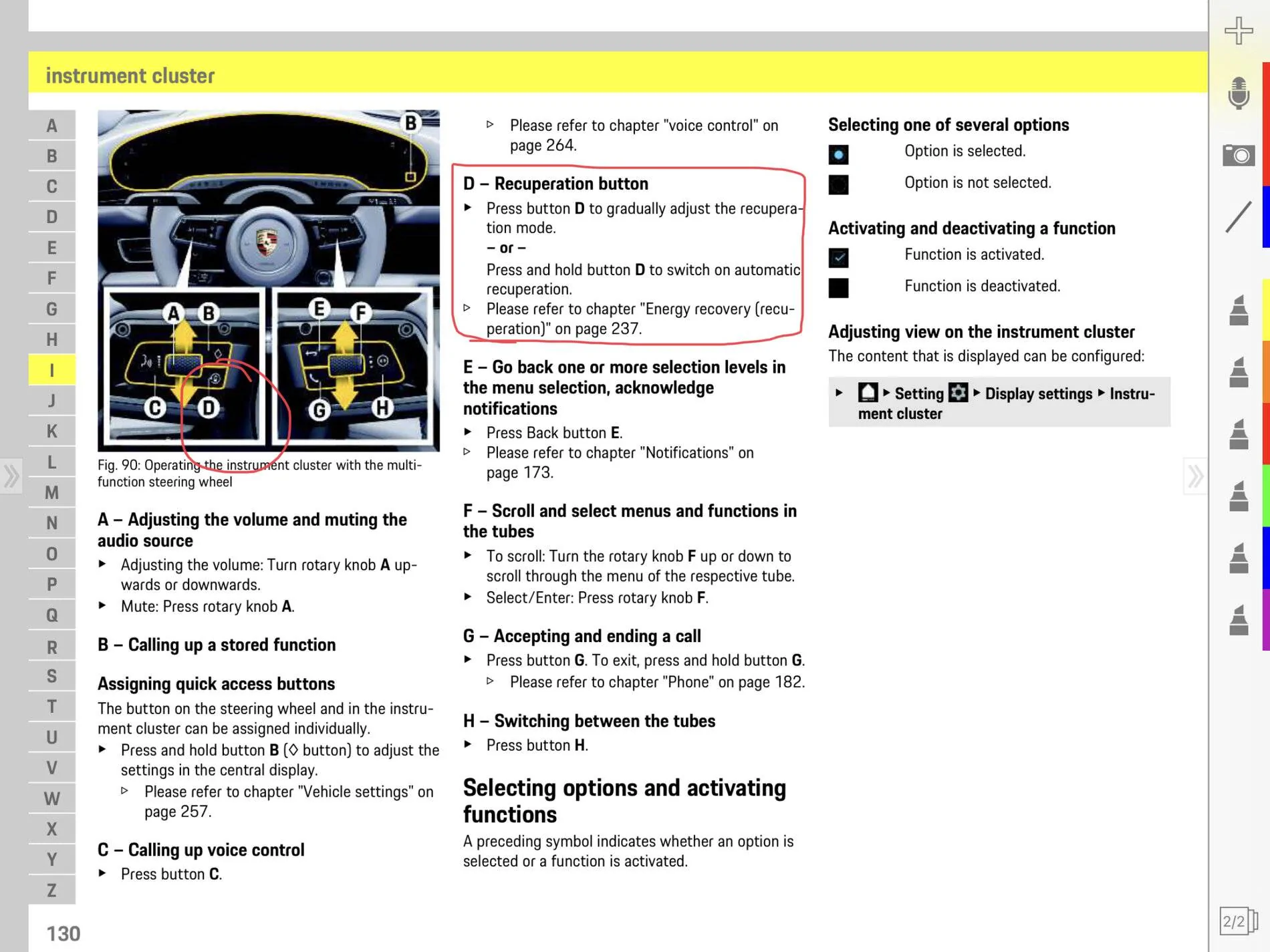

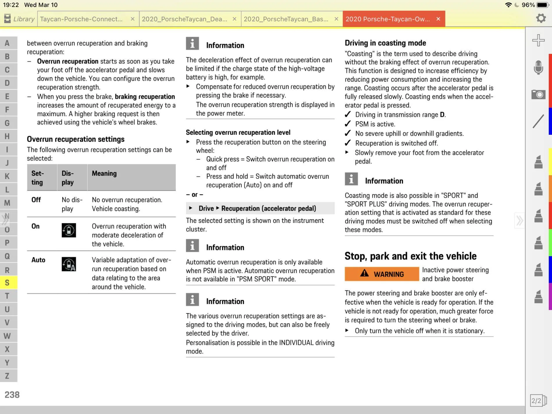

US manual p.130 and Energy recovery (recuperation) p.237,238
Porsche Taycan Auto mode regeneration BB16F5C6-E0D7-4AE6-B9FC-C5AE3F2B003C
Porsche Taycan Auto mode regeneration F6191BD1-AEA3-4A16-AB97-1832F1C1717E
Porsche Taycan Auto mode regeneration 9C4BAD21-4B39-467F-BDC5-06B46A1EF9A0
