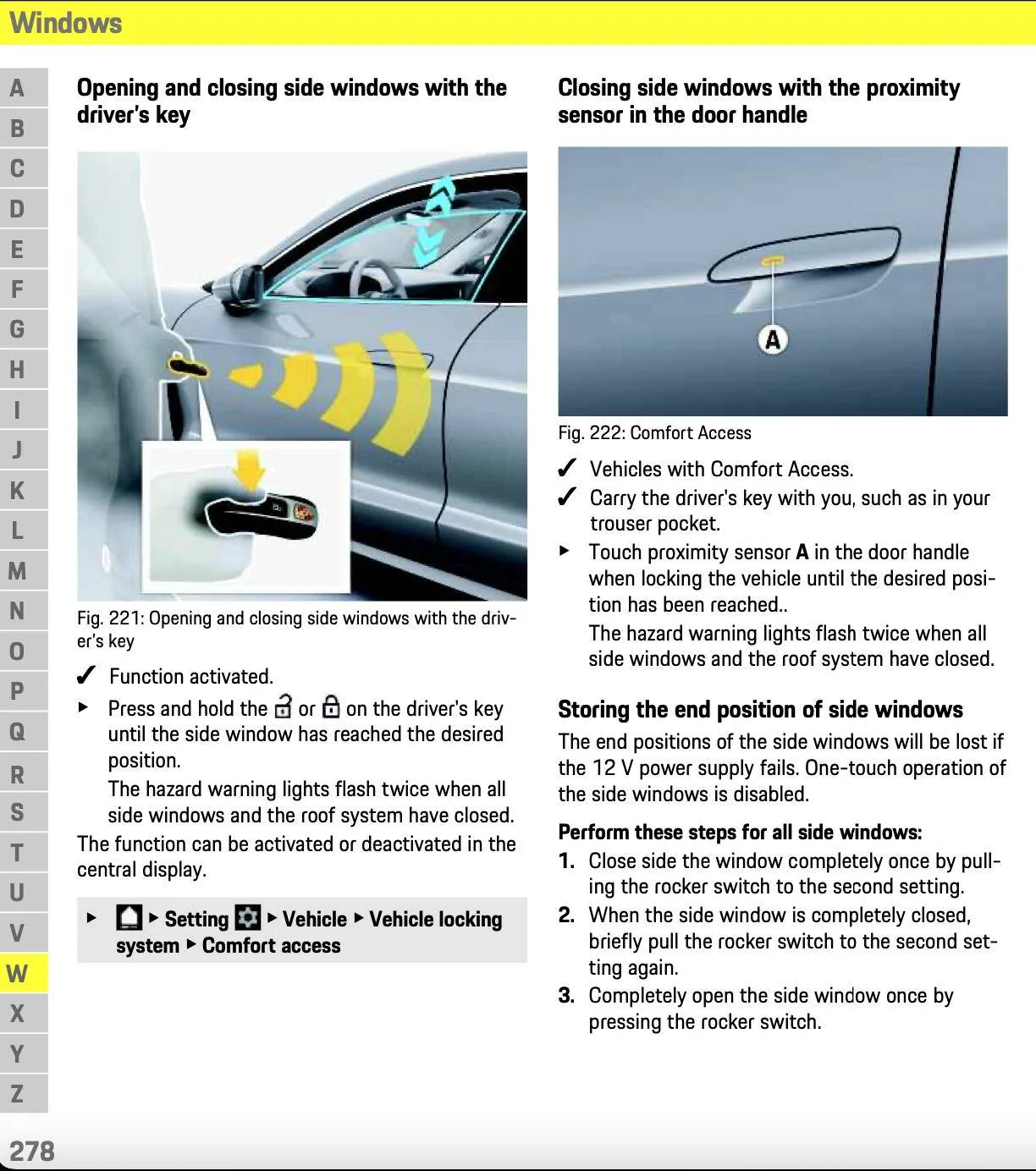

Has anyone had this issue when locking car with your thumb on the door handle, the back window slightly opens. If I lock car with my FOB it’s fine.

Just reset your automatic window end position--page 278 of the manual.
Porsche Taycan Back window lowering on locking Screen Shot 2022-07-30 at 10.16.59 PM
Thank you for the reply. That actually worked. Now the window closes. However, for some reason to close or open windows With my key fob doesn’t work. I have comfort access option but maybe not that feature.
