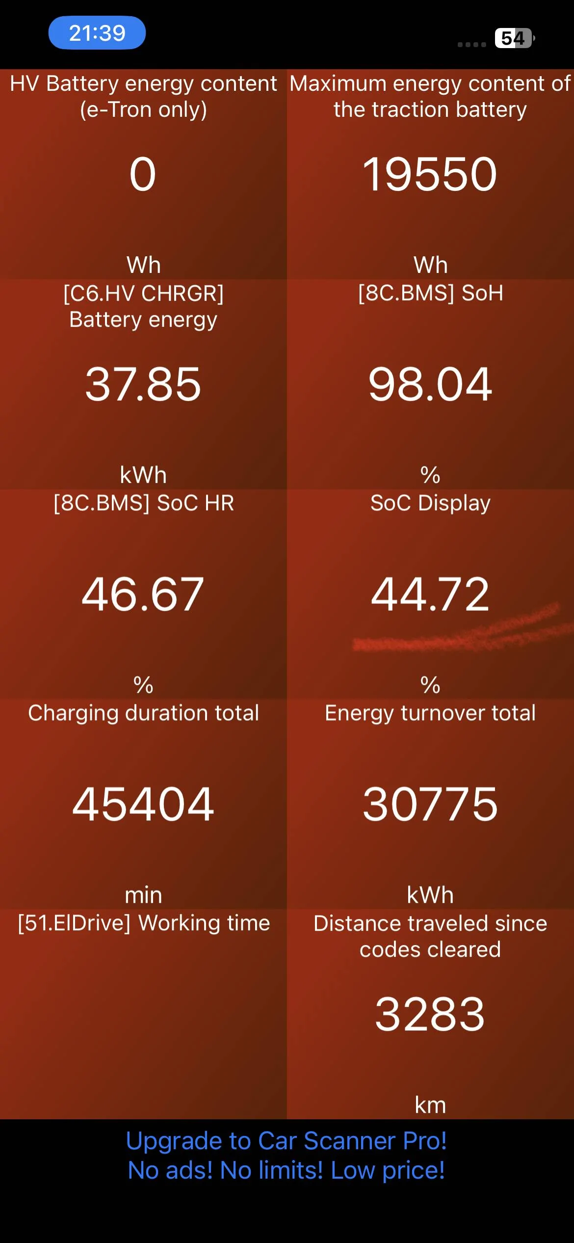

First of all thank you @ciaranob for data collection and organization.
I just received my OBD tool (vLinker MC+) and -as an OBD rookie- would like to know if it is necessary to charge 100% for accurate reading or 80-85% is good enough?

Thanks, it happened:
MODEL: Taycan GTS MY2022
Build date - 06.2022
Country: Hungary
Season: Winter/5C outside. Garage 12C.
Delivery Soh - not known
Current SoH - 98,04 :punch:
SoC at measurement - 45%
Current mileage - 11,655km
DC charging - ca. 12% of total charges
Below 10% - frequently but charged immediately
Charge to 100% - ca. 10 times but driven immediately
