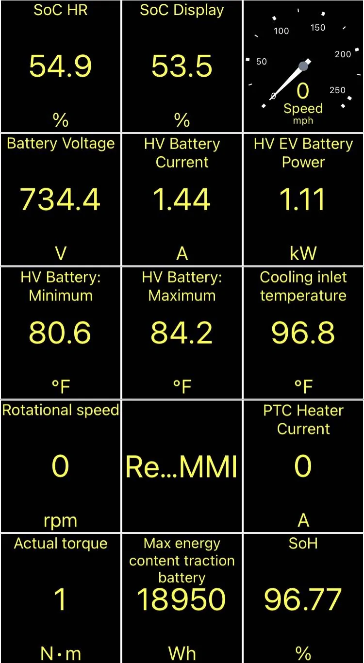

1) Delivery Soh - unknown
2) Current SoH - 99.19%
3) Current mileage - 1560
4) kWh DC charging -minimal, whatever they did at the dealership before I picked it up
5) Build date -July 2022
Current SoH - 96.77%
Current Mileage - 6108
4-6 DCFC sessions.
~5 charges to 100% for trips.
30-85% is my typical SoC at any given time.
Porsche Taycan 🔋 Baseline for HV Battery SoH Performance (Battery Degradation Data by Taycan Owners) IMG_0371

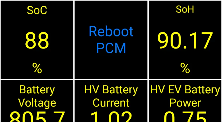

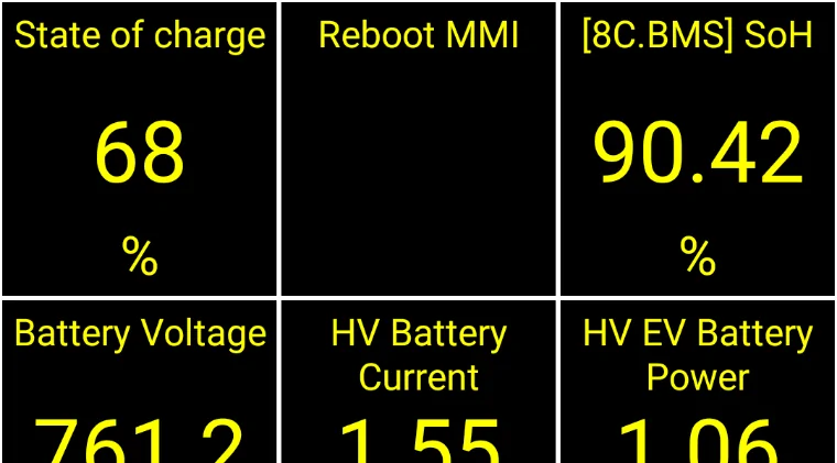

Dee
Dee
Dec 14, 2018
78
3,508
4,050
A lot
Porsche Taycan 🔋 Baseline for HV Battery SoH Performance (Battery Degradation Data by Taycan Owners) Screenshot_20230527-190619
Porsche Taycan 🔋 Baseline for HV Battery SoH Performance (Battery Degradation Data by Taycan Owners) Screenshot_20220726-153754~2
Haven't lost much the last 10.000 km. ?
I'm (very) curious about the next 10.000 km...
