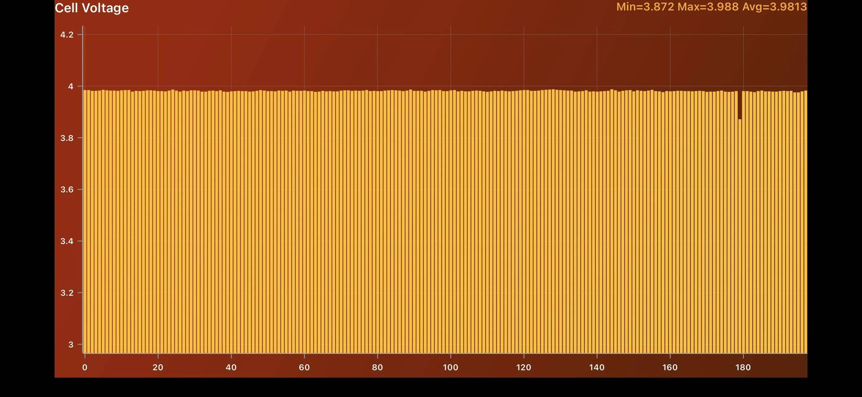

Cell voltage delta is 6.2 mV, pretty high. Could you please post the Cell SOC screen, too?

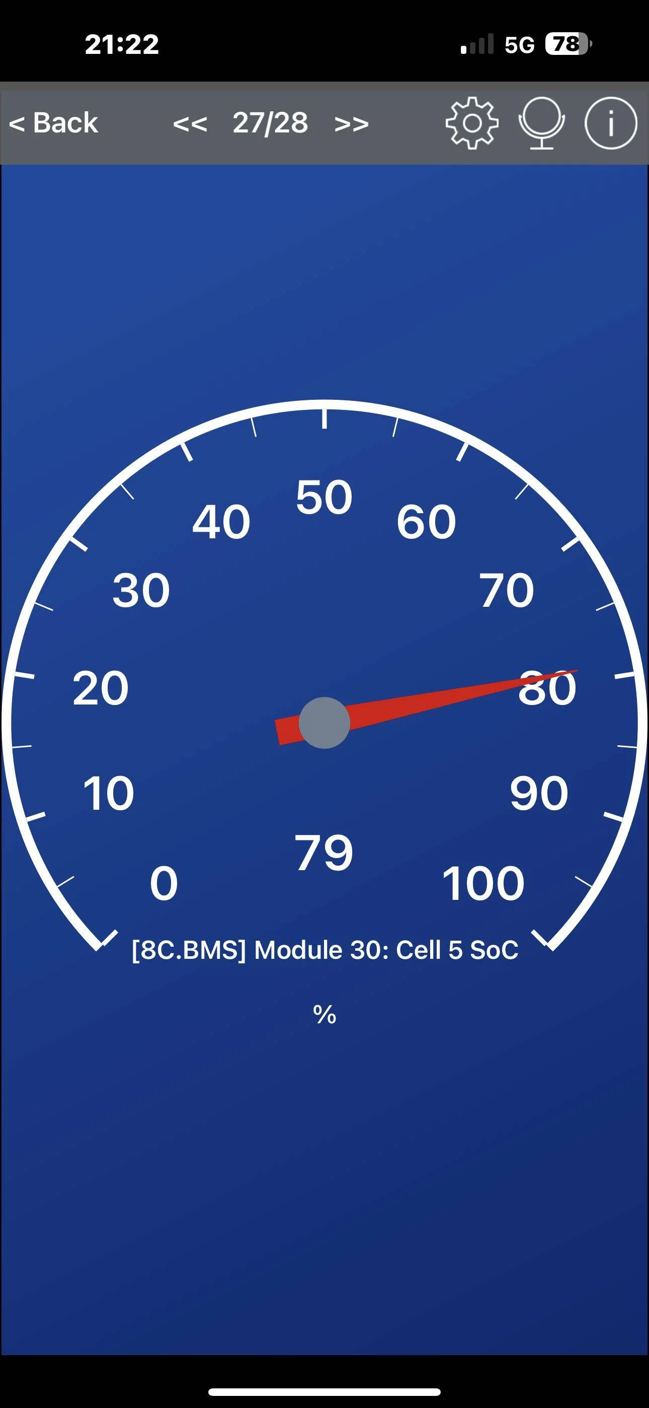

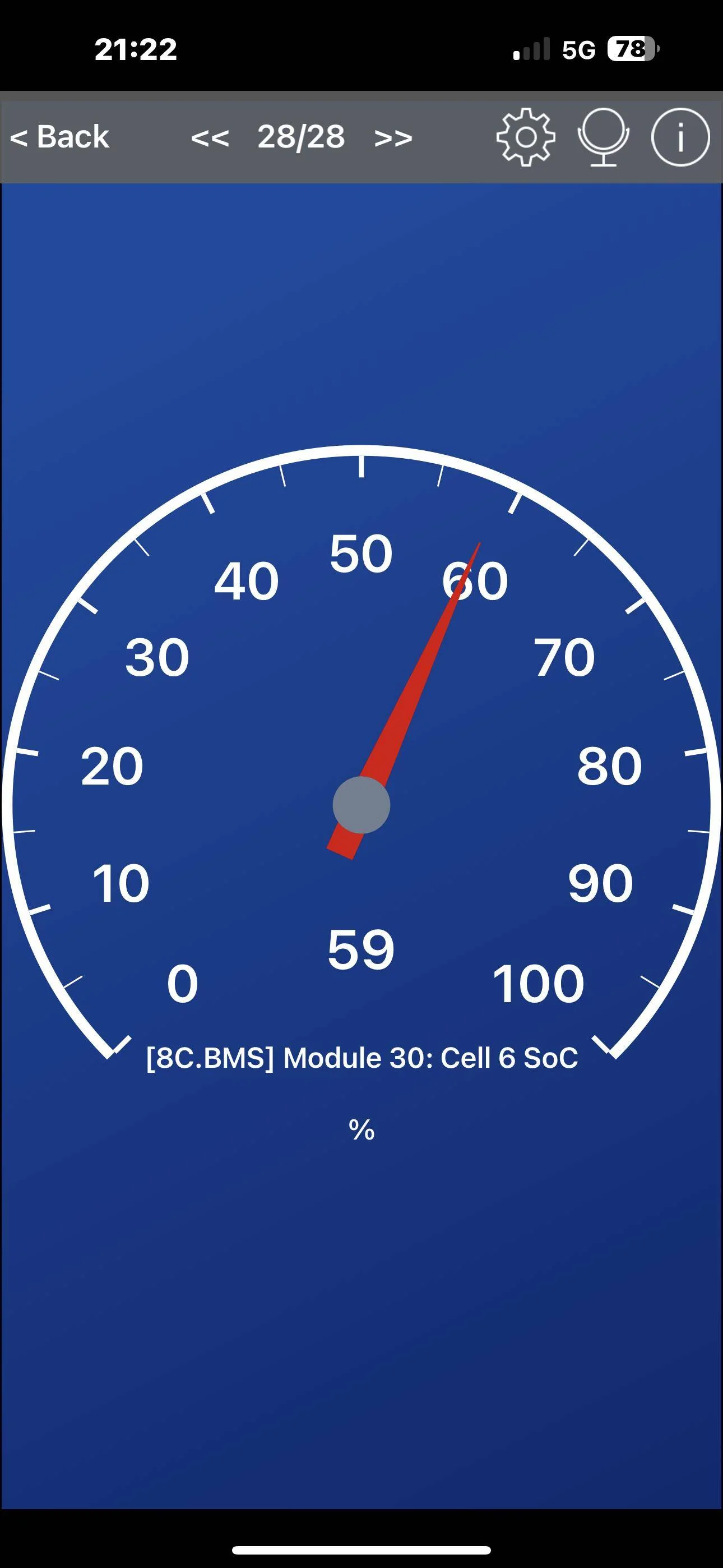

My car seems to have done so and has been fairly stable at around 90% gor some time. I will try to get a new reading later today, as I have seen my range drop quite a lot lately. My consumption for driving similar stretches of 250 + km seem to be stable at 21 - 22 kWh/ 100 km, but the overal range has dropped to around 330km (about 200 mile).
I have also seen a dip in one of the modules lately that is a bit concerning! See screen shot below

Can this module be replaced under warranty?
I hope that it can be replaced under warranty. I used Car Scanner again and have identified the module and also the cell that seems to have the problem. The SOC is about 20% lower in this one cell compared to others.
Porsche Taycan Baseline for HV Battery SoH Performance IMG_0780
Porsche Taycan Baseline for HV Battery SoH Performance IMG_0779
