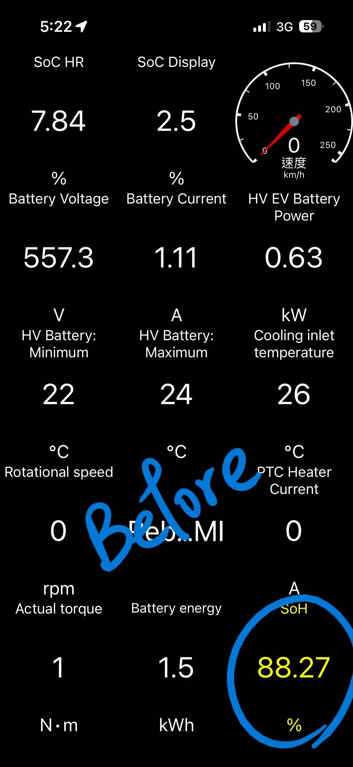

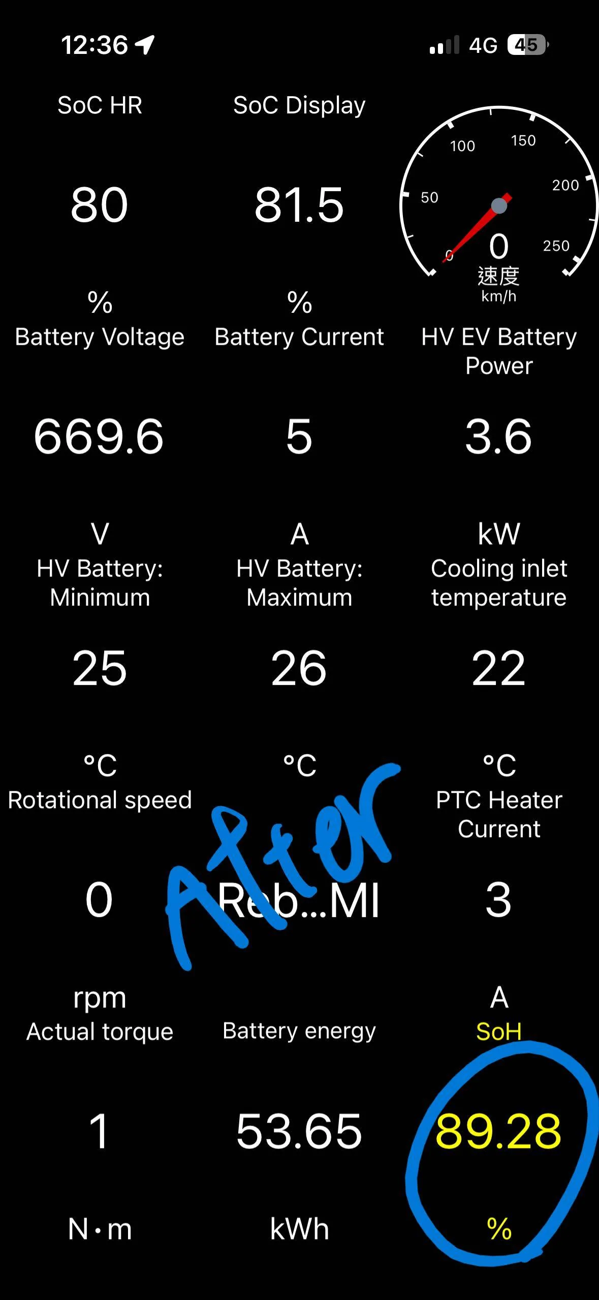

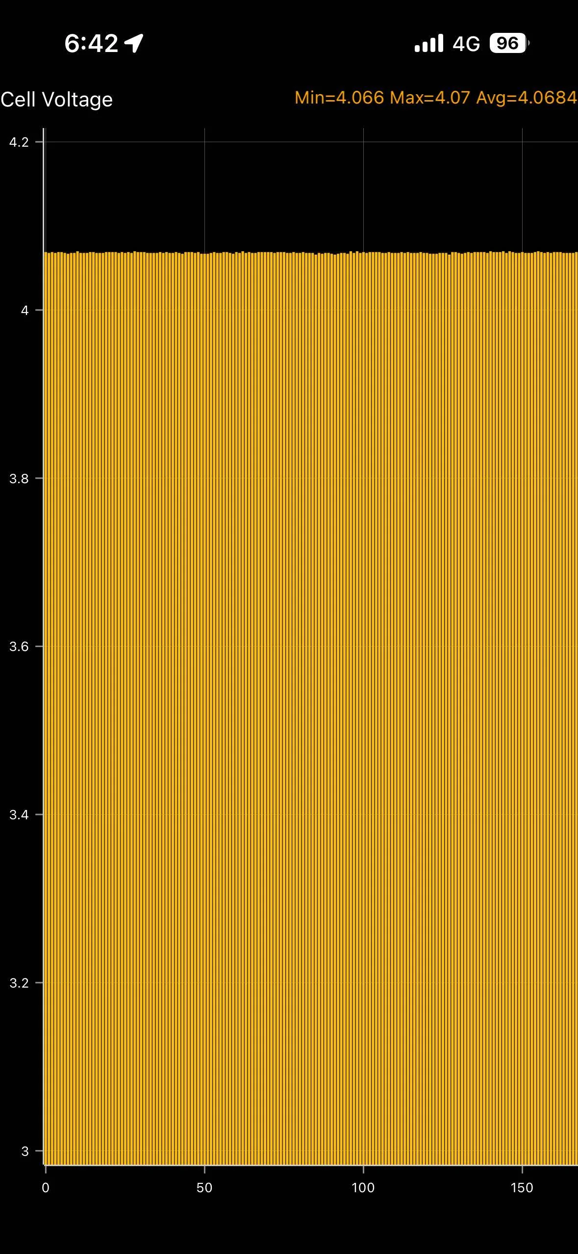

Hi Folks,
My RWD Model with 79.2 kWh Battery.
I've tried the "Manual Battery Calibration" steps.
Run the battery lower then 10% (I left 3%) put the car over night without charging, and charge to 100% (with trickling charge around 5Kw)
1) Delivery SoH: unknown
2) Current Soh: 89.28%
3) Current Mileage: 24,336 km
4) kWh DC fast: forget
5) Build date: Date of Production November 22, 2022
I think the battery health is declining too fast, less a year(Delivery Date 2022/03/01).
Is it normal?

ciaranob
ciaranob
Jul 3, 2021
82
3,440
2,479
Hi Folks,
Is it normal?
Well actually for a Hot Climate zone (as defined here) car you are pretty much in line with the rest of us - my Soh (Houston TX) with only 9200 miles (14.8K Km) is relatively stable at 88.7 (and that is after a recent cell rebalancing!).
I will add you to the chart if that's OK - first from Taiwan :) - need to look at your no.s more when I get a moment.
Cheers, C.
PS: Cell map looks good.
Chiu
Mickey
May 31, 2023
Taipei
Taycan RWD/MINI Cooper S/LEXUS LC500
Cheers, C.
Thanks bro! 😊💡
Yes, I think Cell map looks good with 4.06~4.07A and I thought the SoH will shows 90%+ after calibration. haha
