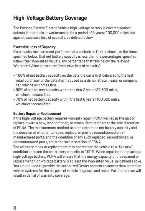

Good topic. Discussed plenty with much data available.
Quick answer, your way of doing it appears to be the best way supported by available data.
My first uneducated guess was to treat it like a phone or laptop battery, discharge deep, and then charge to 85% for daily use. The chemistry of the batteries is different and battery management system is not comparable to a phone/laptop so the recommendation is to keep it centered around 50% with top 65% and bottom 35% if I know I have a short daily route, but if I have a long daily route (extra trips) then I go to 85%. My target is 50% if the car is not driven for a few days, which seems to be recommended at rest SoC.
I am measuring my SoH regularly and due to for another reading at 5k miles next, but at 4k miles my SoH was 93.85% down from 99.95% level at delivery.
The other metric that I am tracking for myself is SoH against warranty levels of degradation as shown below for 2023 model and participating in the efforts by @ciaranob in the link shared earlier in the post:
