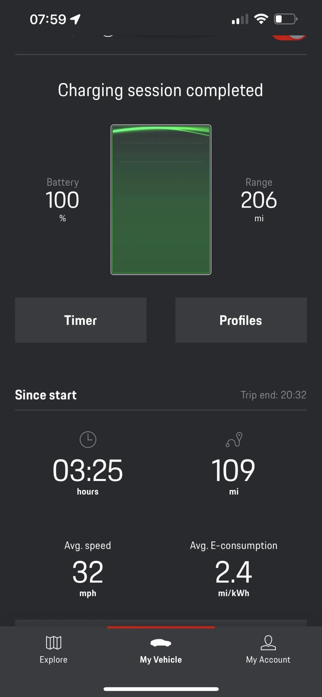

Hi
I’m new to the forum and would like other owners comments. Since new my 4S rarely does over 165 miles from a full charge, which is nowhere near the published figures.
on the Porsche app after 100% charge, I get an indicated 206 range, which plummet’s once in use.
the Porsche centre tells me the battery cells are operating normally and there is nothing they can do.
any feedback would be greatly received.

Pre-heating and Range mode won't make a dramatic change to your range once on the road. The reported range will be higher but as soon as you start your journey your range will adjust and sometimes quite significantly.
CT has the Performance Battery Plus as standard so you have the 'biggest' battery available.
100% charge with an ambient outside temperature of around 12C should return 220 miles - before you start driving.
206 miles does seem on the low side but if Porsche have tested it and given it a clean bill of health then the situation gets a little trickier unfortunately.
How old is you car (mileage)? If relatively new it can take a wee while for the range to creep up (it will never be spectacular in UK climate) but 240 - 250 miles should be achievable in milder and warmer weather.
What settings did you typically have enabled in the car - specifically AC and cabin temp? This can be tweaked to extend range but if starting from 206 (max) then that won't increase (obviously) but can tease out additional miles (e.g. AC ECO / ECO Plus (not recommended), Range mode (potentially).
How much motorway driving do you do?
Sorry no silver bullet in this response but useful to have a bit more detail.

Thanks WINGE
The car has less than 1000 miles and pre conditioning only happens when on charge. AC is on auto with cabin temp set at 20 degrees.
Mixture of motorway and city, but mostly motorway.

Should be as simple as useable battery capacity (about 84kWh from new on CT) multiplied by the average consumption. 84*2.4 = 201.6 (I'm assuming the 209 on the app isn't just based on the last journey but not sure, if it was it would say useable capacity about 87kWh).
Quite simply, if your efficiency isn't dropping below 2.4mi/kWh you should be seeing 200miles real world range (ignore the GoM). If you aren't able to do 200miles at a journey average of 2.4mi/kWh then it would seem to me you don't have the full 84kWh Available.

Thanks for the reply, thats what i've been saying to Porsche as i get 165 - 175 miles which would mean i should see around 2.0 mil/KWH and my average is 2.4 Mil/KWH.
I'll try Porsche again but also try the other suggestions in the thread and monitor during the warmer weather.

Yeah, something doesn't seem right at all. Think all the stuff about weather , driving style should be irrelevant as they just affect the average mi/KWh (i.e. your comment on not seeing 2.0 which you might on a Eunice day). Either your reading of 2.4miles/kWh is erroneous, or you aren't getting the correct capacity of the battery (for a new vehicle) to be that far off.
