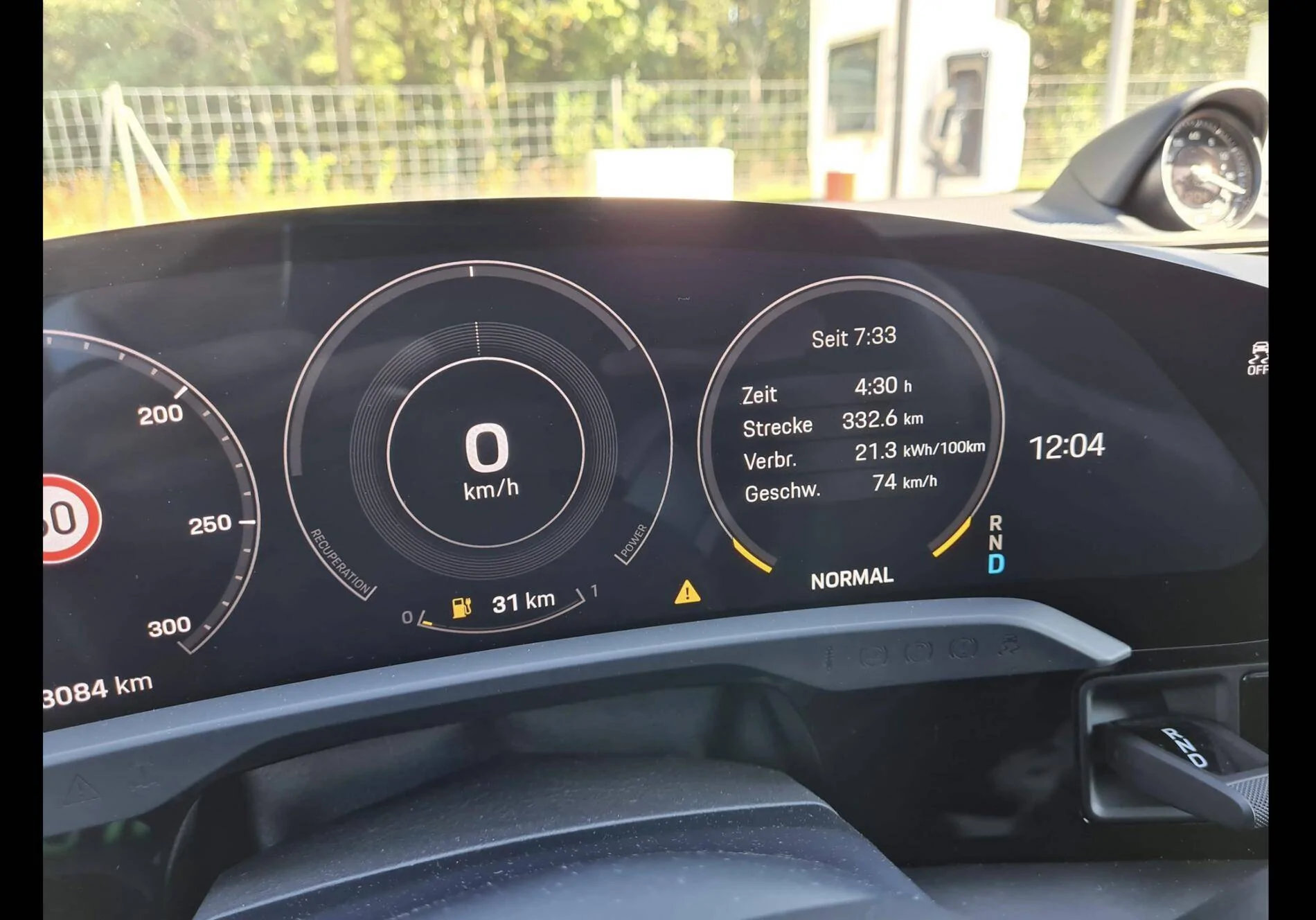

I like my Taycan very much. So I drove about 32.000 Km in the past 6 month.
According to the display I lost about 10% capacity of the battery in 4 month. From 83 KWh in May to 76 KWh in September.
Can this be ?

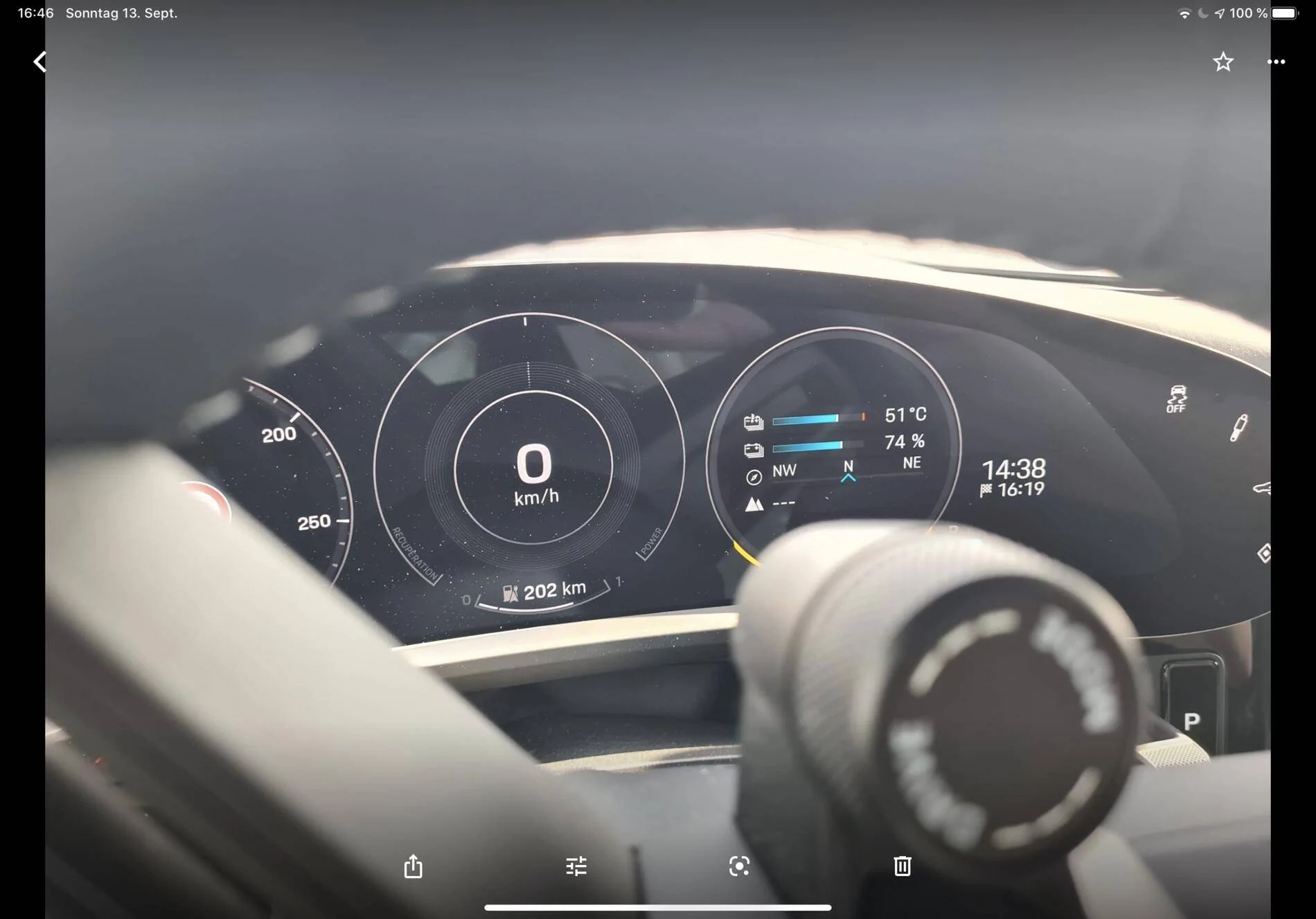

Battery gets very hot, when charging at Ionity. Start with 30-35°C, end (about 80%) with 51°C (123.8°F).

Last long trip with 332.6 Kilometer i hat a cunsumption of 21.3 KWh/100 kilometer.
battery was from 100% to 7%. This give a complete capacity of 76.2 KWh of the battary.
4 month ago I had at similar trips capacities of 82 KWh.
Gotcha. Yeah, that's not good. 11% degradation shouldn't be happening within the first 150,000 km.

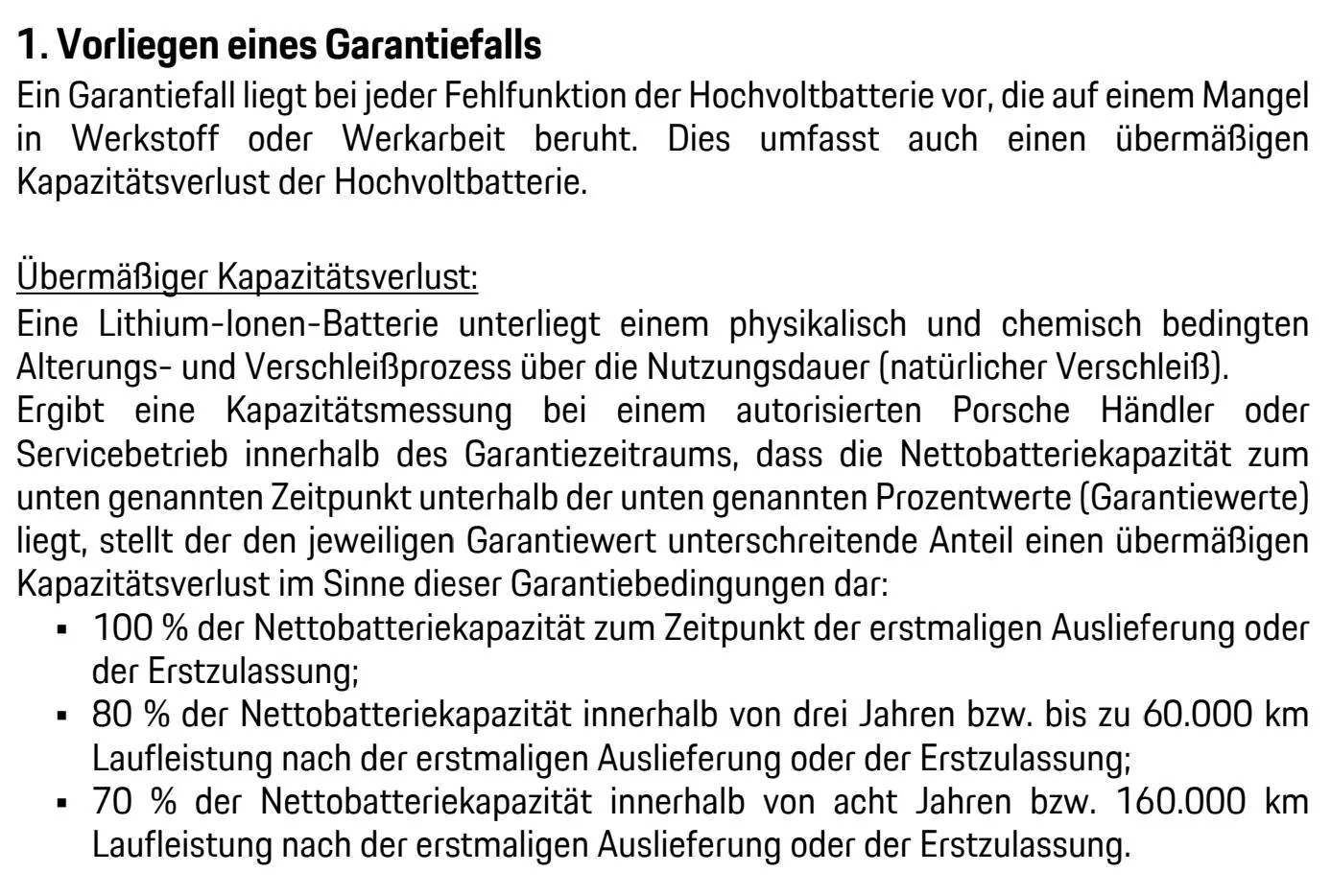

If it truly has that much degradation that fast, it will go to warranty. So yeah I would take it to the shop to check it out.
"Curious" to see if there is that much degradation how Porsche react as the battery warranty is as following:
-guarantee 100% of the net capacity at delivery (83.7 kWh)
- up to 3 years respectively 60'000km guarantee of 80% of the net capacity (66.96 kWh)
- up to 8 years respectively 160'000km guarantee of 70% of the net capacity (58.59 kWh)
