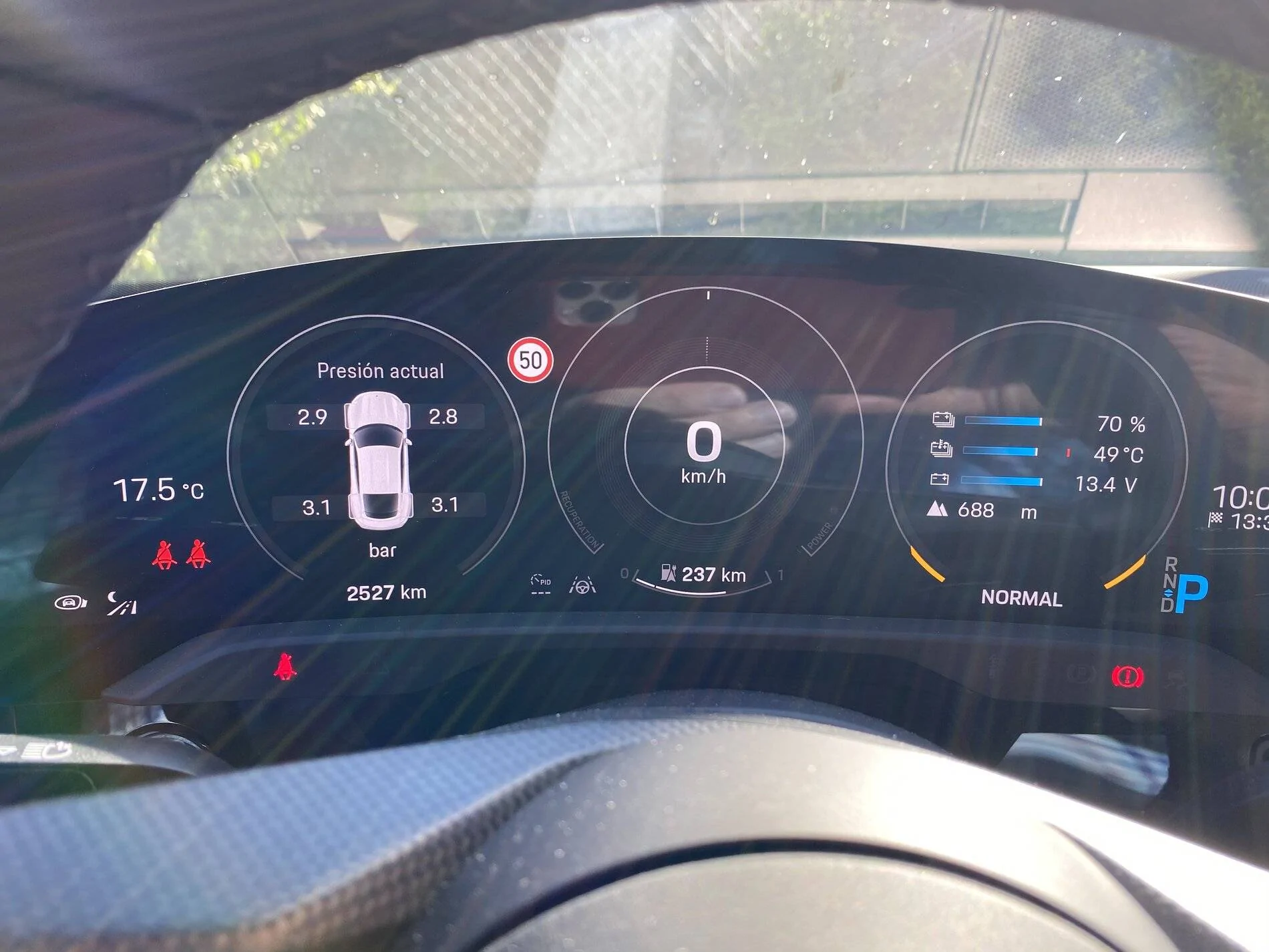

Start with 30-35°C, end (about 80%) with 51°C (123.8°F).
What is the rate of charge you have with those temps?
I just charged yesterday at a 150kw charger and it went from 135kw down to 100kw as the car charged. But the temp ended at 95F, so I wonder if your issue on range/degradation is related to the temps you are hitting.
Do other people hit temps that high when charging?
I certainly did on my only charge on Ionity. Outside temperature was only 17.5°C and battery temperature reached 49°C at 70% charge. If I remember correctly,(this was almost two months ago) it got up to 51° at 85% (no photo to back this up).
