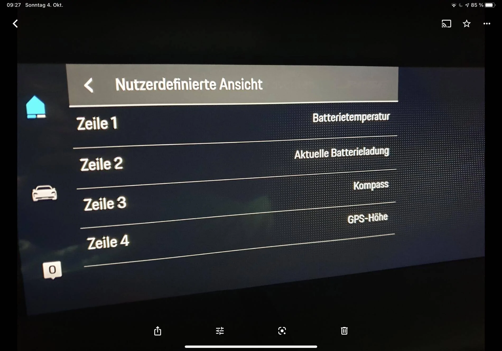

Same here - cannot figure out that either. Mine shows voltage, battery remaining, and that the phone is connected to the car.
You can edit what it shows in the car settings.

you can chance the settings for the displays.

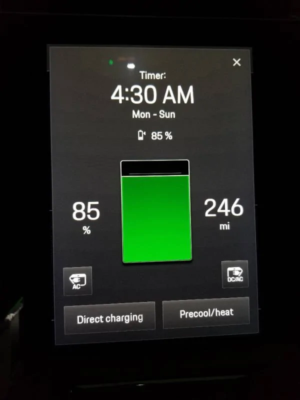

As most have experienced, at delivery the display said the estimated range at 100% charge was about 201 miles. Once you start driving the car, it quickly begins to increase. I have used a mixture of EA DC chargers and AC charging with the PMCC set to 85% SOC. Yesterday, I drove around in Sport+ the entire time. The SOC of charge was 67% when I got home last night. This morning I noticed that the display indicated that at 85% SOC the estimated range even after taking into account yesterday's spirited driving was 246 miles (289 miles at 100%). It is the highest range that I have seen since I got the car in April. Typically it is about 235 miles at 85% SOC.
