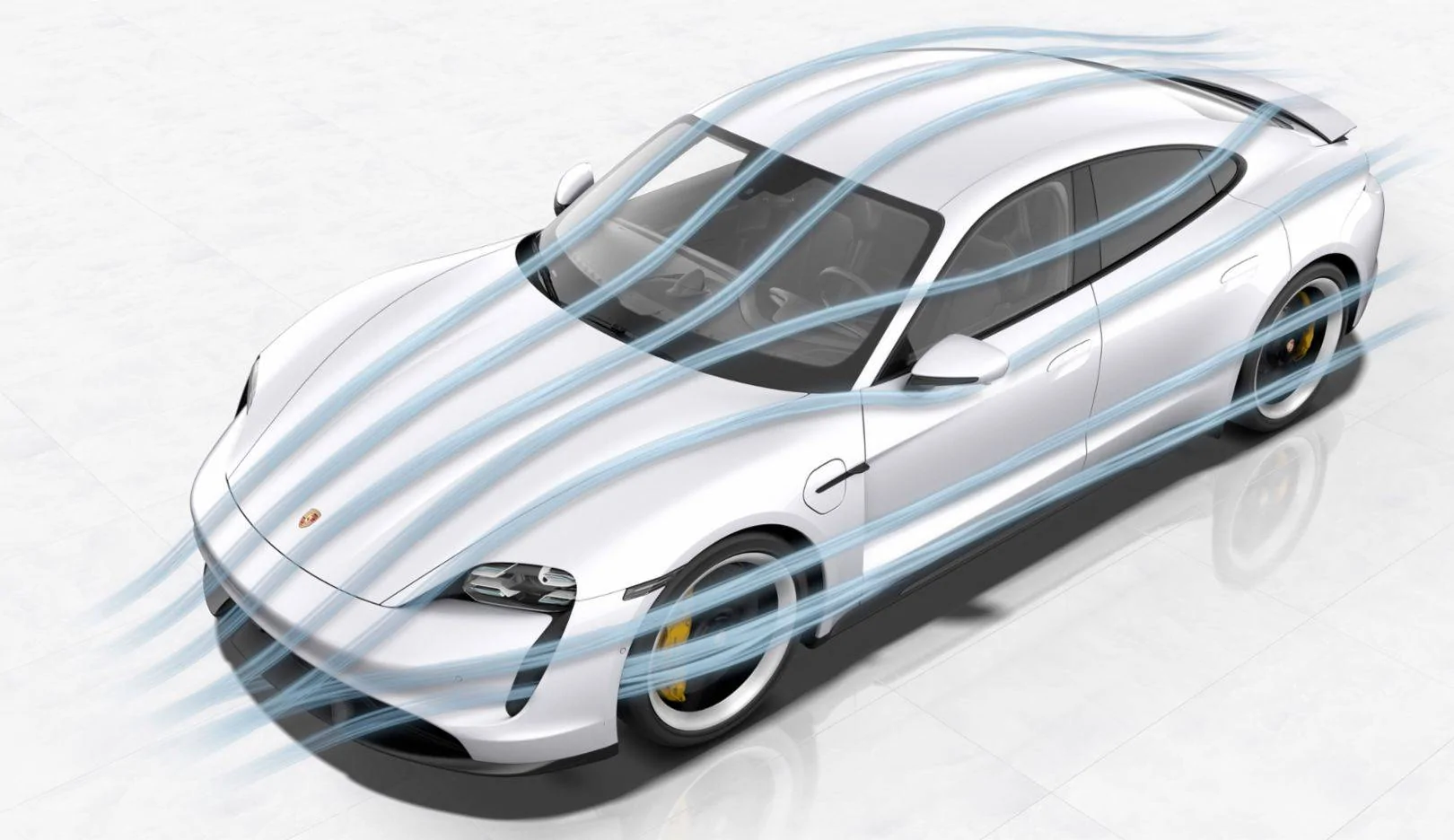

I believe the opening to the rear of the wheel has a negligible effect on drag. As the airflow passes outward and over the upper, faster-moving portion of the wheel and then continues past it, it has already done its work as a "curtain". The wind tunnel illustration below demonstrates the airflow in the powered charge port door configuration, with the air curtain effectively (at least theoretically) reducing the wheel's disruption of the laminar flow.
source: https://newsroom.porsche.com/en/products/taycan/aerodynamics-18554.html
Porsche Taycan Blocking front wheel arch vents taycan wind tunnel
