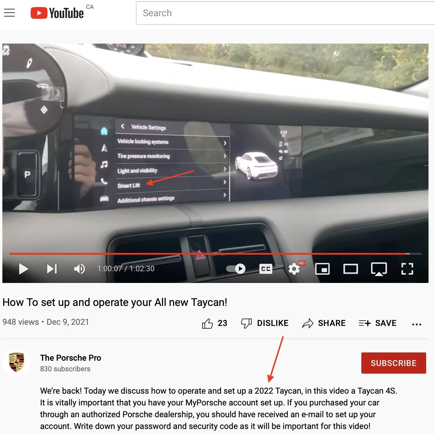

Can you guys see Smart Lift in your PCM menu? I can't. Picked up my car a month ago. But I do get prompted each time I raise the car to save the location, and it does raise automatically each time.

Smart lift needs the Porsche connect service I think.
