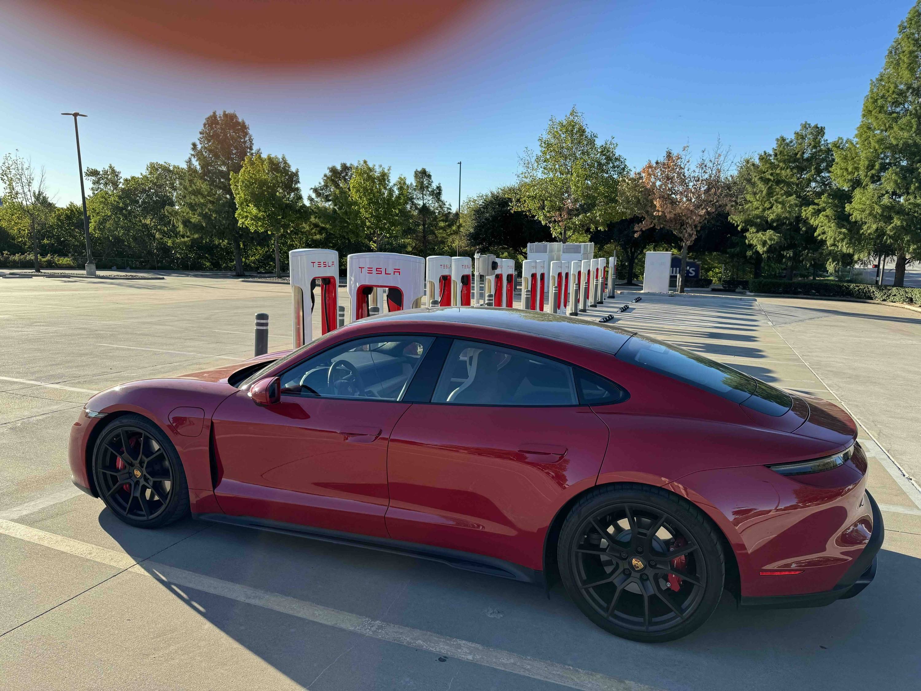

I decided to drive to Fort Worth this morning to try out the Magic Dock Supercharger.
I arrived with pretty low SoC and was a bit stressed, but hey these things work great right?
The app and dock worked, but charging immediately halted with an error.
I tried several times and it would not work. I also tried another stall.
At this point I am experiencing range panic for the first time. I limp to nearby Kroger with a Blink AC charger to find one stall can’t scan my card and the other just didn’t dispense any power.
I’m currently waiting for a tow to get it home and hopefully charge there before I assess further.
if that doesn’t work then I’ll have it towed to the dealer Monday morning.
I’m sorry I tried this.

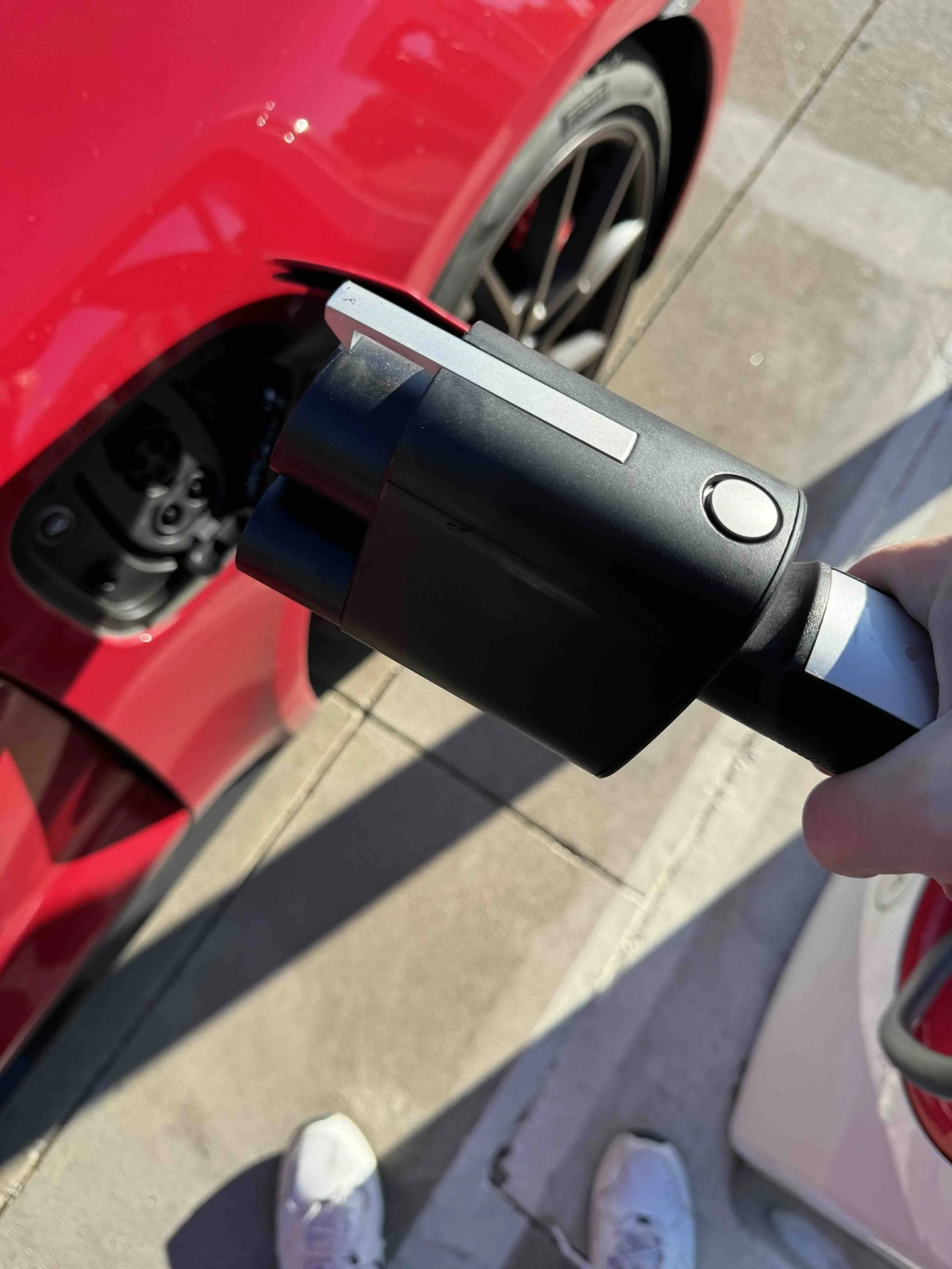

EDIT: What I think happened here is I broke the DC flap while plugging in the Magic Dock, which put some plastic debris in the channel around the DC pins preventing a solid connection. Car is fine both AC/DC working as expected. I'll try it again one day but with more overhead for contingencies.

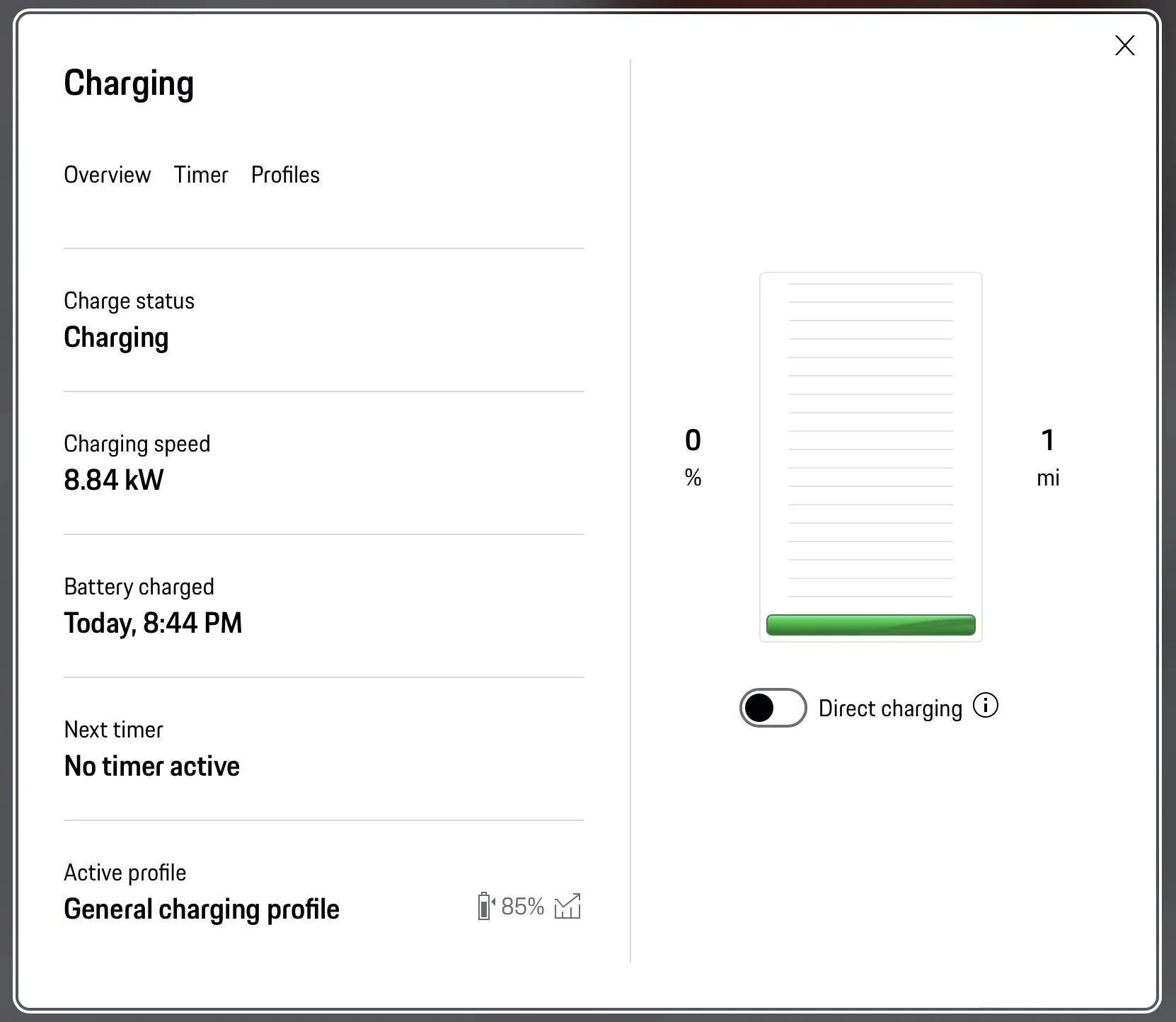

Is Porsche assistance towing you or AAA or someone else?
I called 1-800-PORSCHE to get a good flatbed.
Nearly $500 to get it towed to my house. Free to a Porsche dealer, but they are all closed today.
The car just made it home and thankfully is charging successfully at home, so at least that still works! Will assess fast DC after it gets a healthy charge.

3. Me/Tesla - The Magic Dock broke my DC charging flap; it no longer stays down on its own.
My hope here is that the broken flap (which did result in a piece of plastic in the DC channel) was the cause for the Supercharger failure. I'll know more later.
