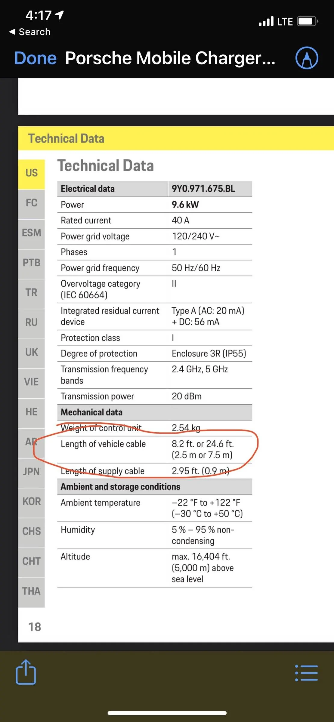

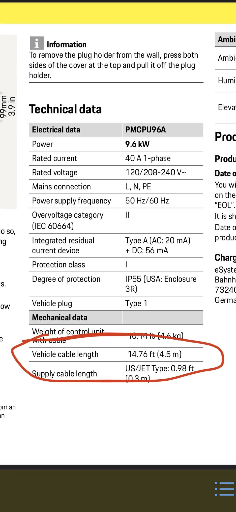

There are two cable lengths to connect your EVSE to your car - std is the one you have but you can order the 7m (23' one).
No, the PMC+ (at least the US version) only has one vehicle cable length.
The PMCC has two different vehicle cable lengths.
Jhenson29
Jeremy
Feb 9, 2021
2,805
4,198
St. Louis, MO
PMC+ Manual:
Porsche Taycan Cable length on Porsche mobile charger plus 412FBC5D-52B9-4041-B6CD-04BC4EFF6D25
PMCC Manual:
Porsche Taycan Cable length on Porsche mobile charger plus BF71D9BD-2B70-4EEC-98C5-025F7C5BB818

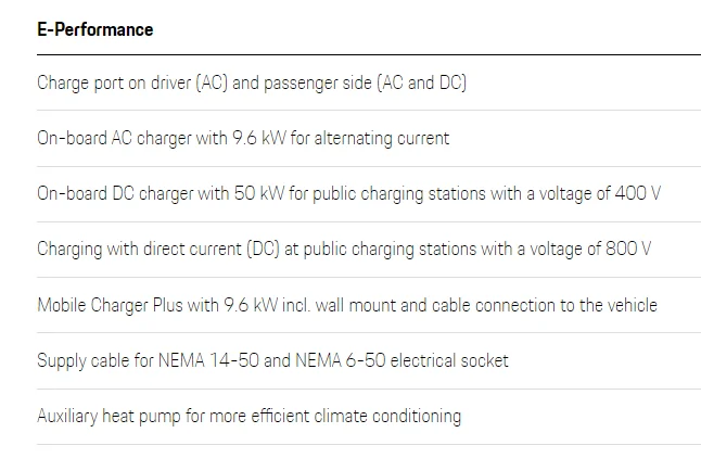

Clearly some folk are on a mission to pick fault first before doing their homework but here's something taken direct from the Canadian Porsche website which confirms 2 cables. Now maybe I'm not reading this correctly but I do see 2 supply cables listed.

Both NEMA 50A cables and neither a “standard home plug” which I would interpret as the 5-15. Also was not the case a few months ago as per my screen shot in my link that showed only one cable. So, for at least some time, it only came with one cable. I was also careful to qualify my confidence in my statement with “I believe” rather than stating it as outright fact.

I posted screen shots of the specs from the manuals that showed this is not the case. I don’t understand why you’re still arguing the point. I’ll be home tonight and can look at my PMC+ to check/confirm if it will not accept the cable you posted from SunCoast.

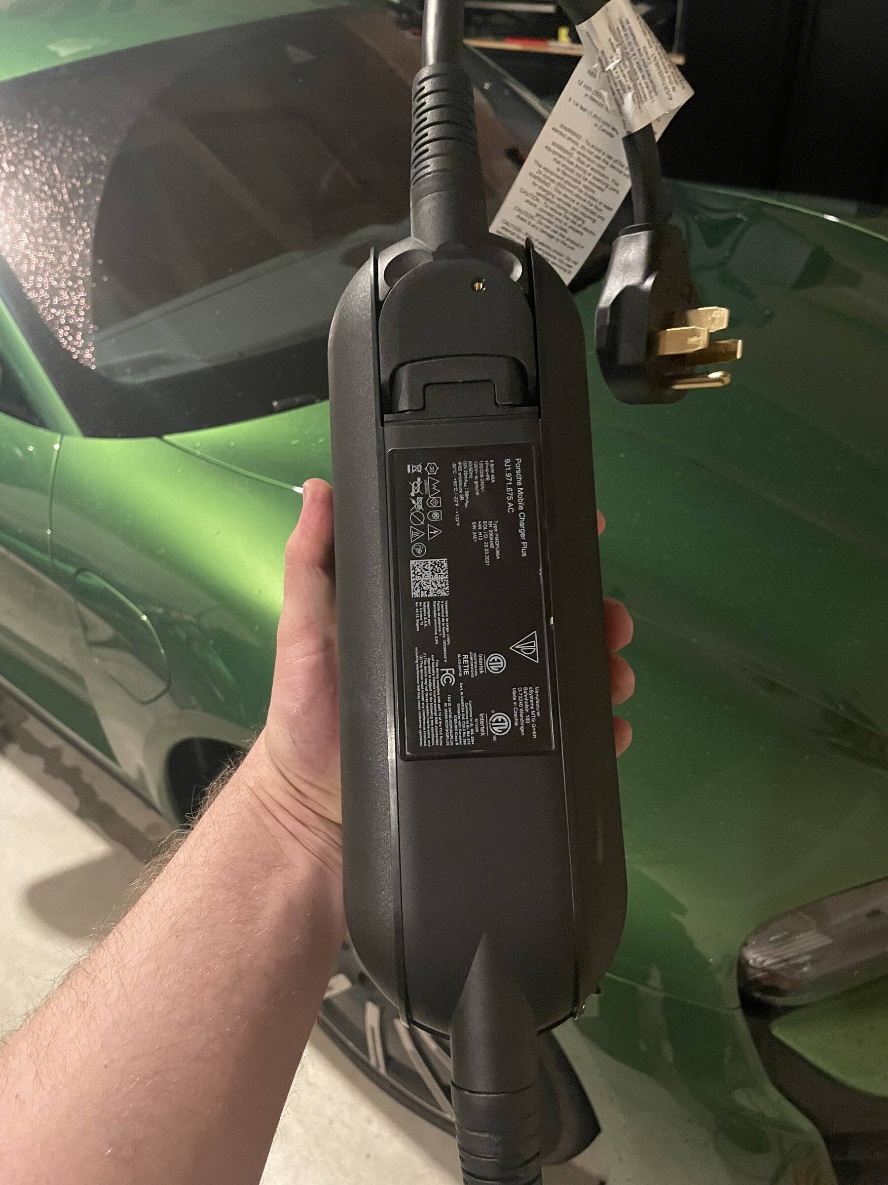

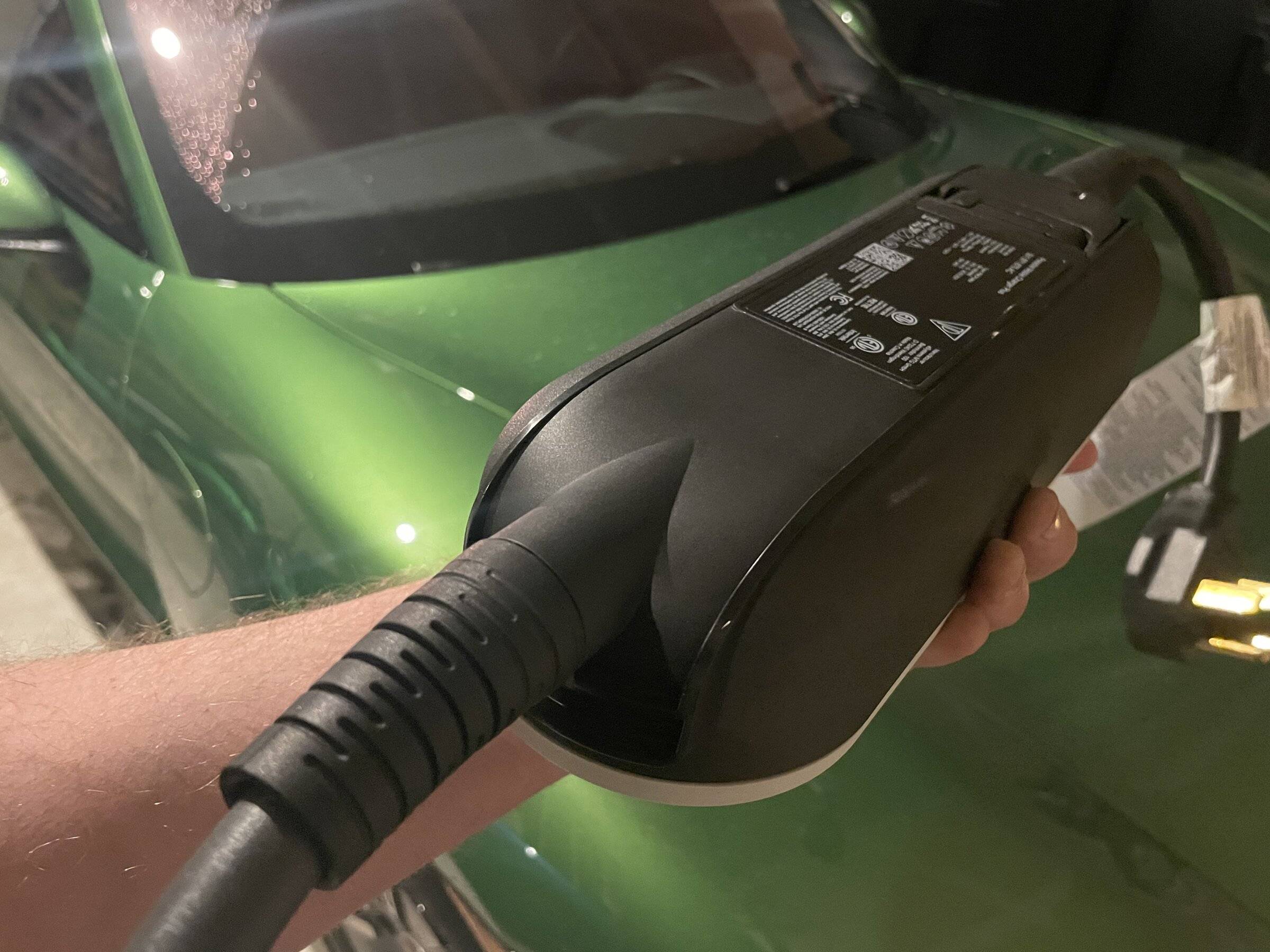

PMC+ below. Are we able to confirm whether this is the same vehicle cable connector as the PMCC as claimed?
Porsche Taycan Cable length on Porsche mobile charger plus F2B3766D-8776-4290-912B-3DE0C6DBC2F6
Porsche Taycan Cable length on Porsche mobile charger plus 16CF15DD-4E29-47FF-852A-27921FFD3CAF
160
5,810
8,647
same ”supply cable” (from the wall plug to the EVSE) - but your PMC+ has a different “fixed” vehicle cable - my PMC+ has the same modular cable that comes with the PMCC…
pictures soon when my wife returns with the car…
so it appears there are at least two versions of the PMC+ - so beware when purchasing the charger to vehicle cable - some PMC+ may not have the “modular” vehicle cable…
more investigation is required…
however at $500 or more - I’d still suggest simply purchasing a separate EVSE w/25 ft cable for less money that what Porsche charges for the 25ft cable…
thanks to @Jhenson29 for posting a picture of his PMC+ - never seen that model.

My PMC+ - received with 2022 Taycan delivered in Dec. 2021 - has J-1772 connector cable to EVSE body identical to @Jhenson29 photo above. No ability to switch that 14+ foot cable. The two one-foot-long supply cables can be switched. I read somewhere online about "Gen 2" PMC+, implying that there was an earlier version.
My point is: if you want to use PMC+ connected to a receptable, the cable with the J-1772 cable is almost 15 feet long (at least for USA version).
