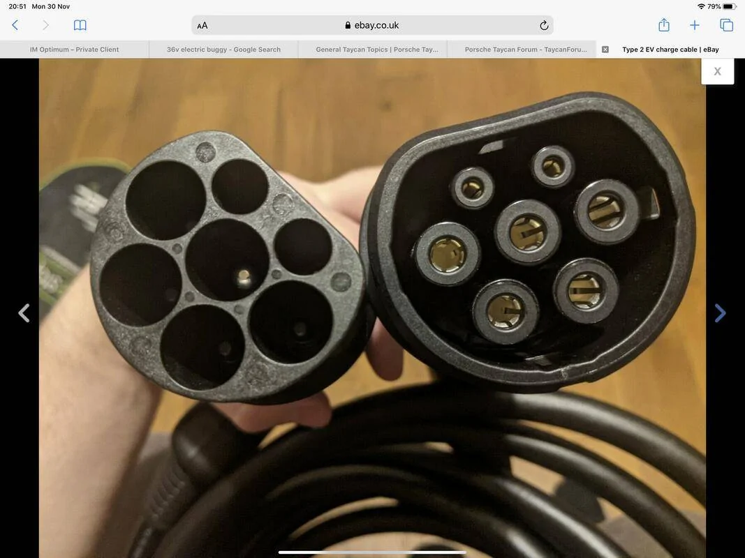

Is this what I need?

That's a mode 3 public cable so should be fine, bit cheaper than the £210 Porsche one I included in my spec...
What’s a mode 3? (pm’d you back) It’s new on eBay for £60 and local pick up? Will it be ok? Says it’s from a Renault Zoe but phase 3?
