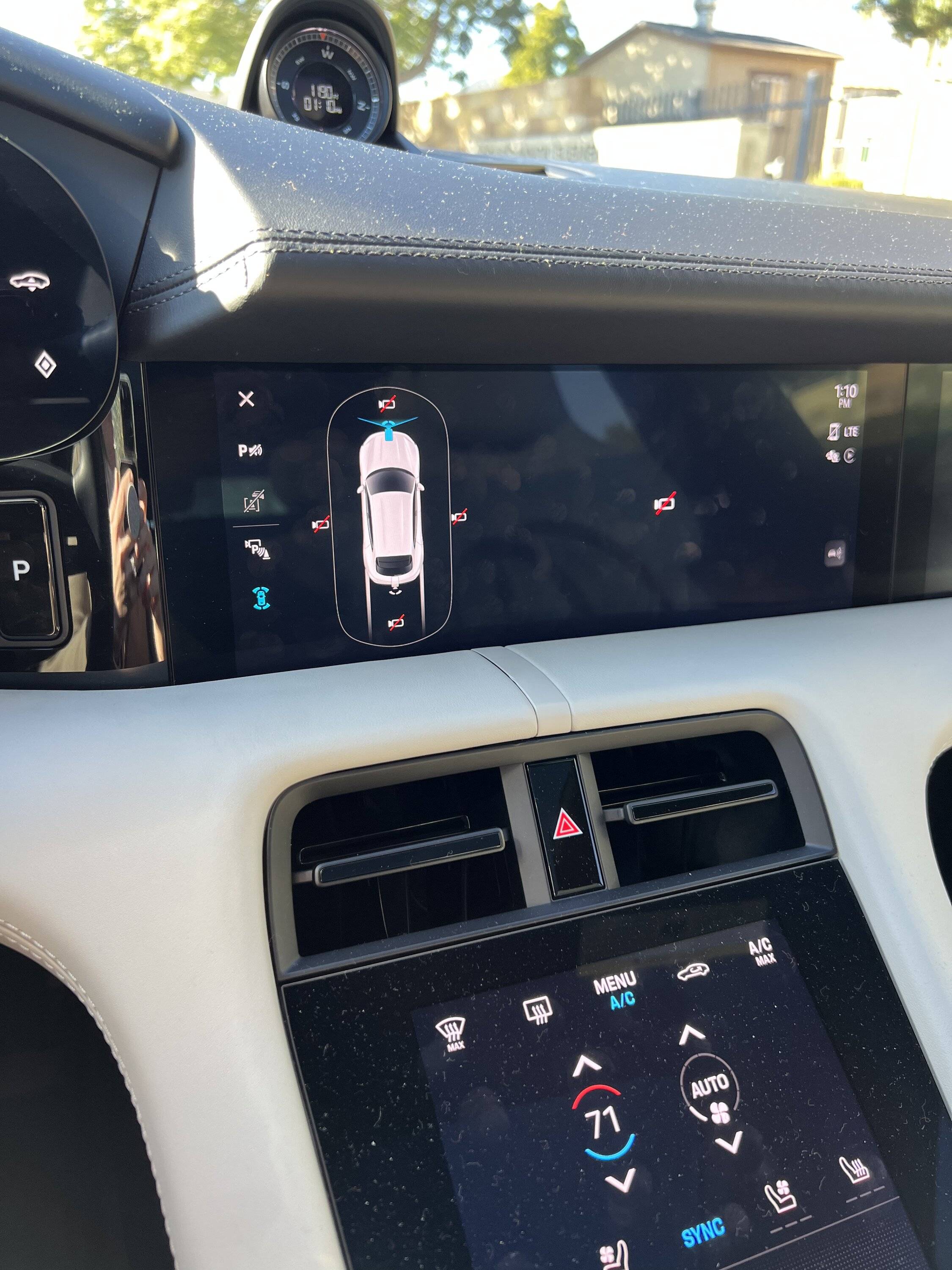

Has anyone had this happen - front camera intermittently won’t work and to a lesser degree, all the cameras?
thanks for any input.

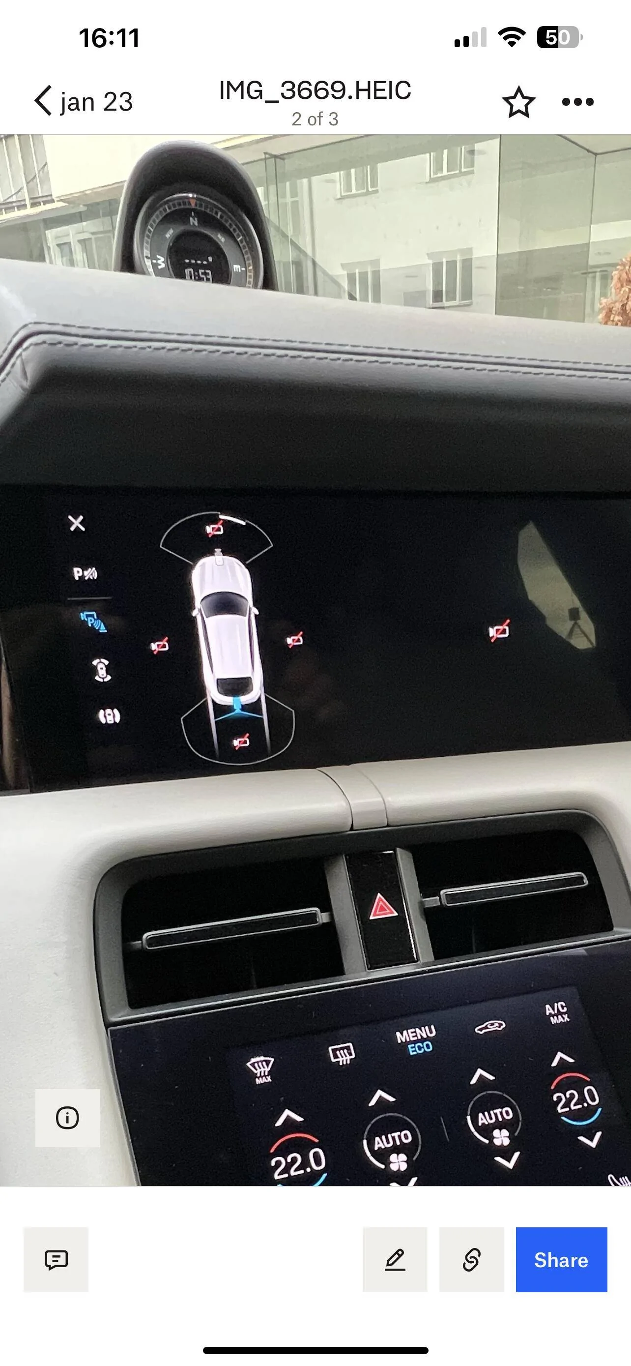

Hi, IT happens to me every few days.
Porsche Taycan Camera malfunction 086FAD1A-F352-410B-8C6F-499D942CE5F7

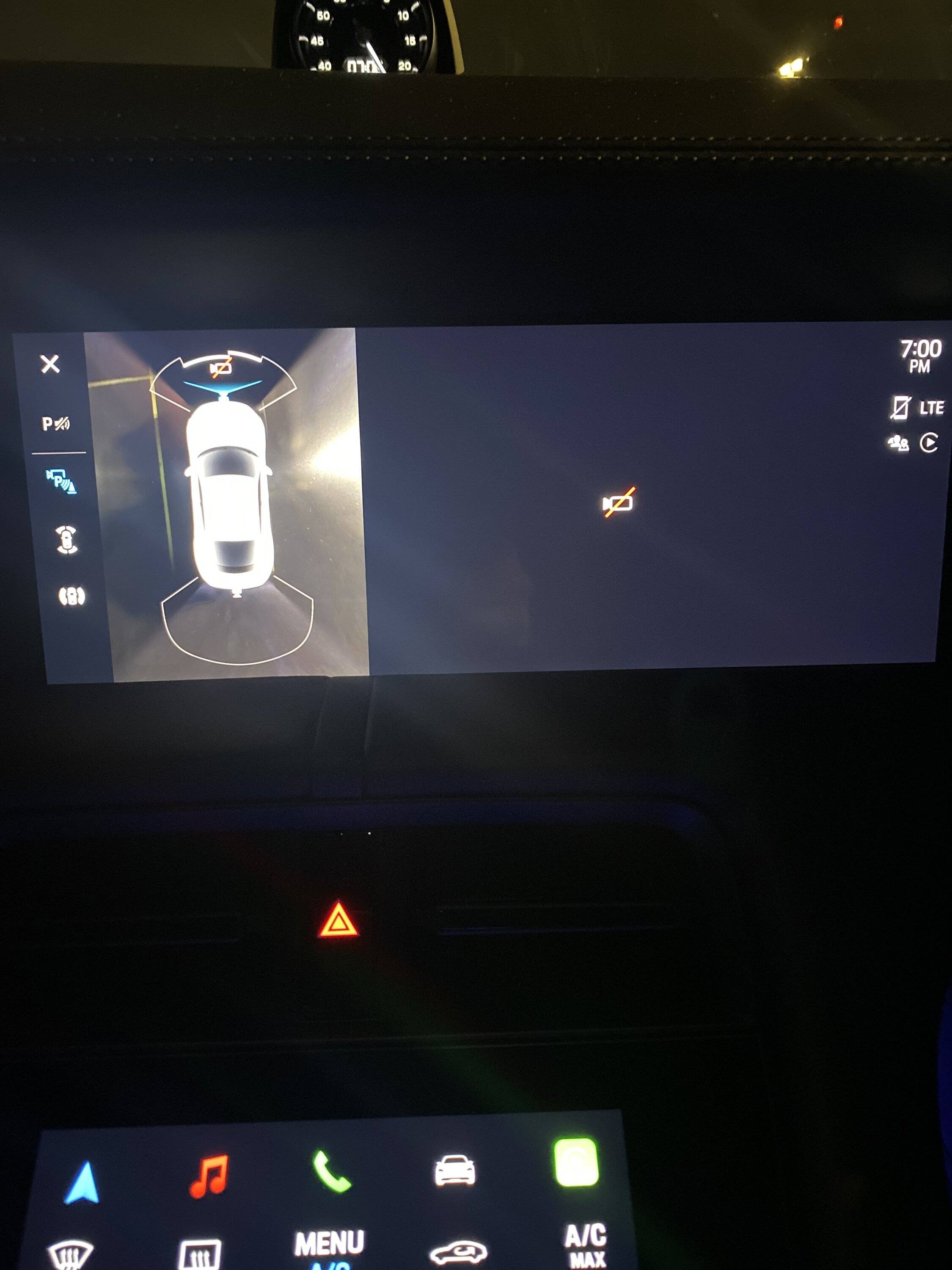

Does it self resolve? My front camera has not been functioning for a few days now. Have a service appt I. A couple of weeks.

Happened to me twice (all cameras)
Tried 2 fingers reset but didn't work.
Seems to solve itself by parking the car, locking it, wait 2 min (till everything is off) and coming back in.

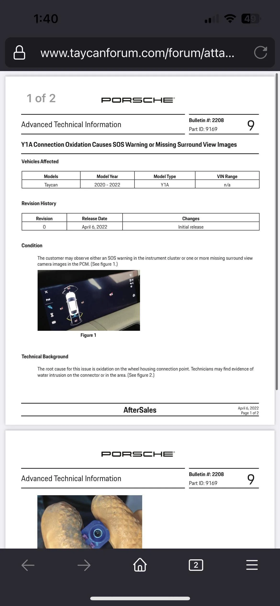

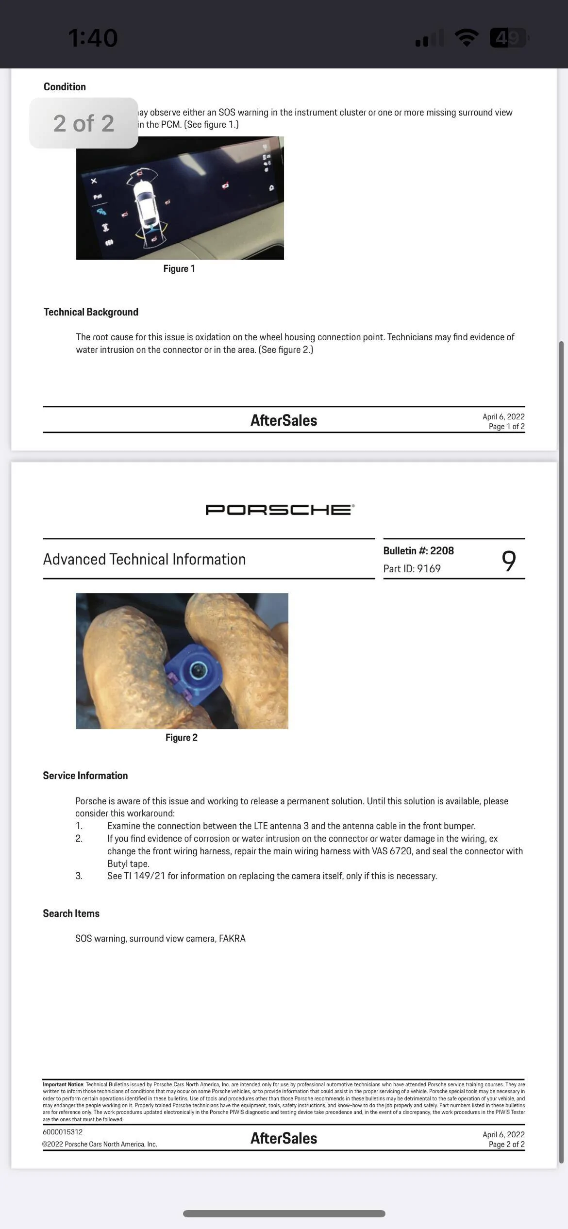

Yup!! My car is at the dealer since last Monday for this issue. It was happening to me daily, quite a few times. Apparently they can’t repeat the issue and I’m suppose to hear more from them today.
Porsche Taycan Camera malfunction 9D063D93-F9A5-40C6-900C-165F60A0B14A
Porsche Taycan Camera malfunction 5DF617F1-A137-459A-B99C-5CF9C531F5A7
Porsche Taycan Camera malfunction 1031D907-1808-494B-B346-DCC0B502BDAF

My car goes into the dealer tomorrow. Thanks for input. The SA told me it may be related to the antenna issue.
