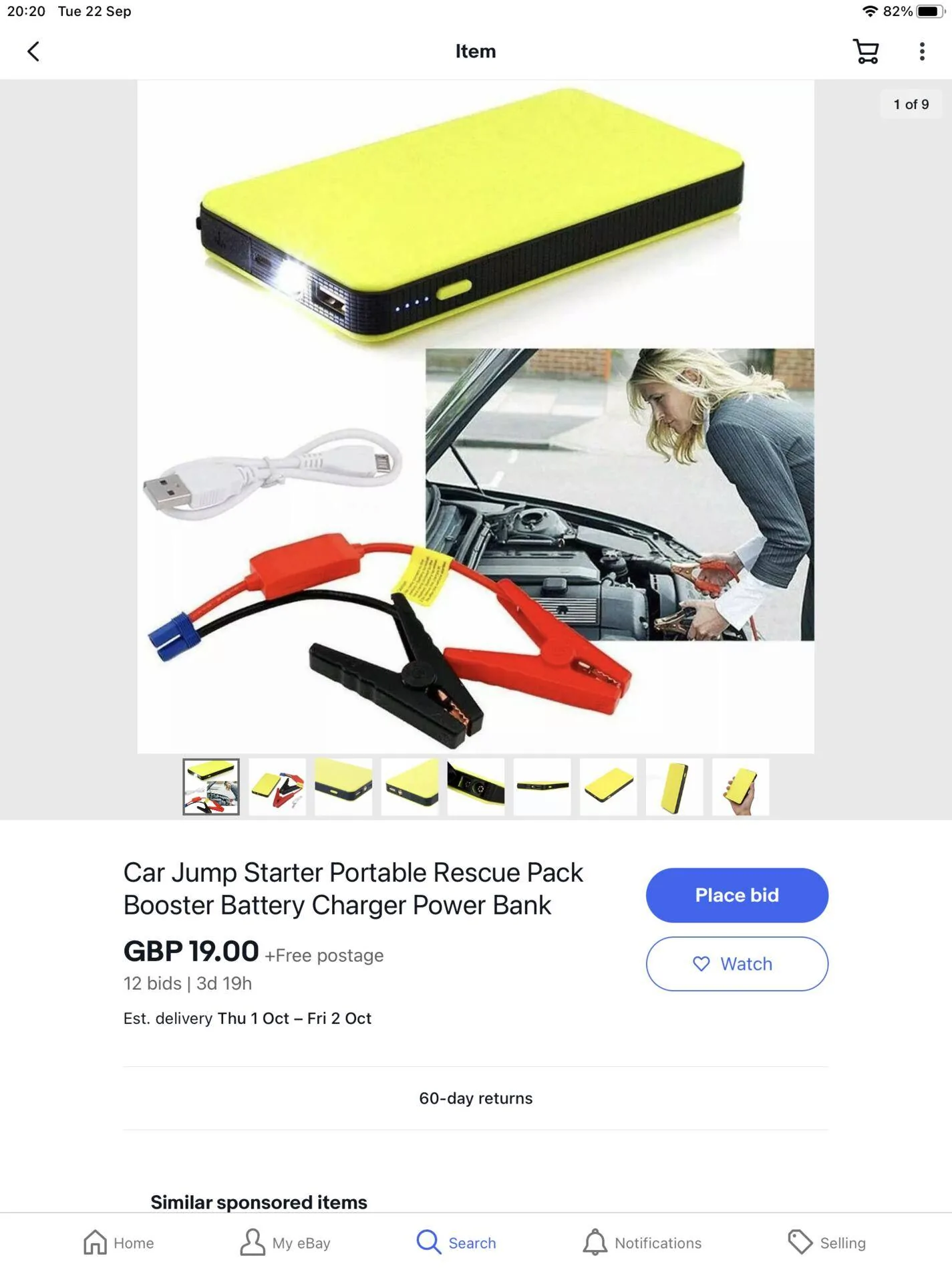

That is significantly cheaper than a Noco!
And all that is likely required to wake up the car - it does not have to crank a starter motor.
