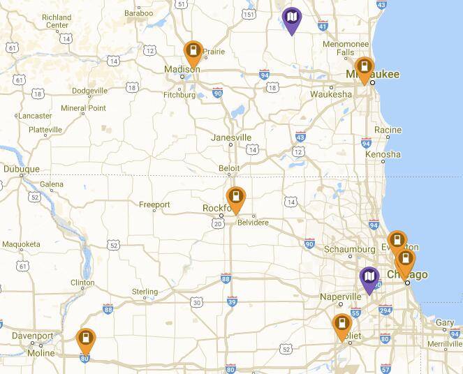

I highly recommend the PlugShare app and website. For instance, here are all of the CCS DC Fast Chargers with at least 120kW output in your vicinity:

I agree that 50Kw is pretty slow, but the the PlugShare map allows you to filter based on output. The map above shows 120kW+ chargers only, for example. There would have been many more pins had I shown 50kW units.

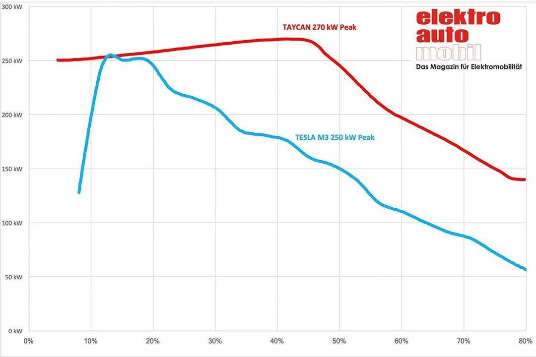

here is a picture of the fast charge taper for the Taycan vs. the Model 3 - please please please - I’m not trying to start a Taycan vs. Tesla conversation - this just happens to be in my opinion one of the best, most straight forward and informative charts as the taper that the BMS software implements as the battery gets closer to full - Porsche owners will be gratified to see that the Taper on the Porsche is signficantly less than the Model 3 - this is due to Porsche’s 800V technology, better cooling, and more conservative “buffer” as to how close to actually full they let the battery get.
both cars get to about 80% charge in less than 25 minutes - which is pretty good and more than acceptable for road tripping - and both cars the charge session from 80% to 100% would be at least another 20 minutes…so charging above 80% while road tripping is very expense from a time management point of view.
but there _IS_ a taper, and the car slows down the charging rate as it gets closer to full for battery management reasons…
