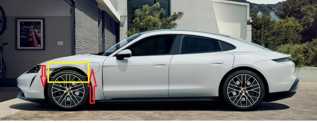

Is it possible to left up and down taycan body to increase and decrease the tyers and body space? not sure how to explain it in words but here i try to explain it:
Porsche Taycan Can left up and down Taycan RWD performance ? taycan left up and down
3,728
6,381
With the air suspension option yes, with standard coil springs no.

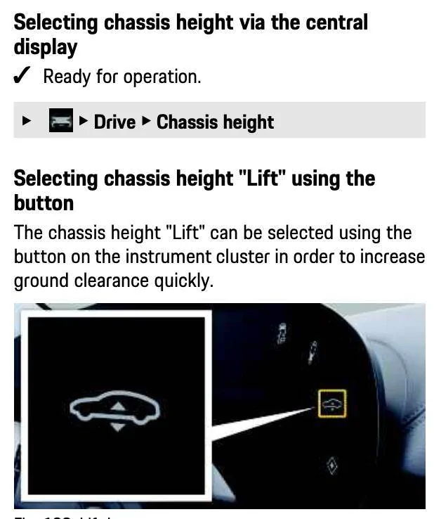

If you ordered the Taycan RWD with Air Suspension Option, then you would have this feature.
This option is called Porsche Adaptive Air Suspension including (PASM) Porsche Active Suspension Management. The option code is 1BK
There will be a button on your instrument cluster as shown below.

With the (air suspension) option fitted on the RWD, you have 4 ride heights.
3 are optional and 1 (Lift) is temporary - selectable at low speed (<19mph) only.
Above 19mph, it reverts back to 'medium'
1. Lift
2. Medium
3. Lowered
4. Low
In Range Mode, the car will also automatically lower for increased efficiency.

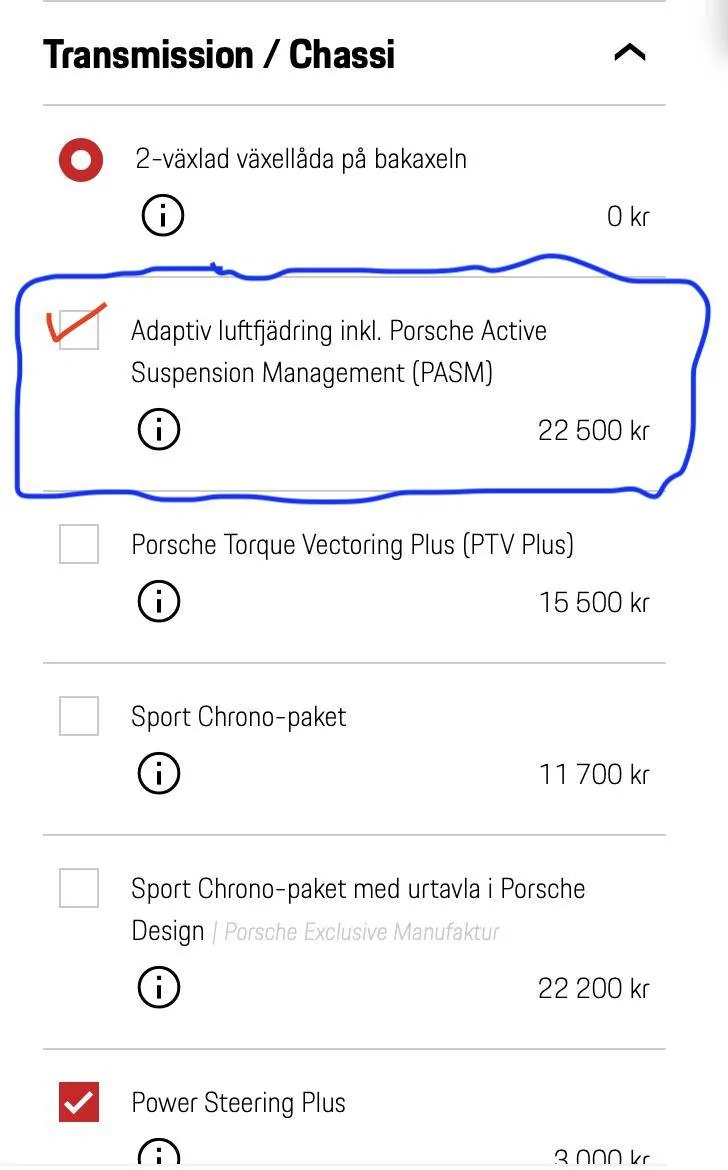

Your current build will not let you adjust the car up and down. You need to add this:
Adaptiv luftfjädring inkl. Porsche Active Suspension Management (PASM)
