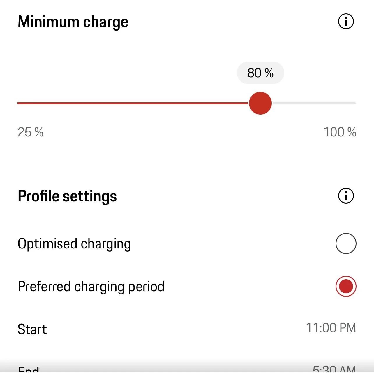

Millionth of topics on same thing. I have set my timer to 85% and general profile to 85% and prefferred time to 00.00 - 06.00, but car still chargers to 100%?
I dont think i have changed any setting and is used to limit to 85%. Do i do something wrong?
see mine and it went to 100%
What do I need to change?
I dont have a timer
I dont have a timer
Turn off preferred time or add a timer.
It will charge to 100% with preferred time and no timer.
In your case, you probably don’t want a profile. You can probably just use a timer set to 80% @ 5:30am.
