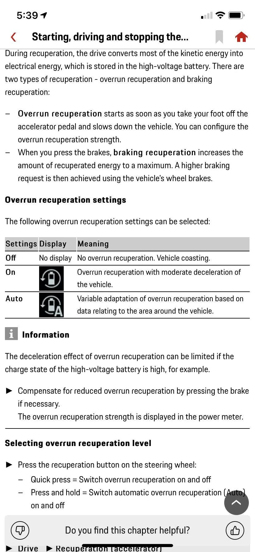

The good to know app says recoup starts when you lift of the accelerator

Thanks for the pointer, I have also read much of the Good to Know app content, very handy.
in my test drive that region that it does when you take your foot off the pedal is pretty much like an automatic transmission in drive mode. It is very subtle and would most likely not light the brake lights at all. You would need to press a brake pedal. In that automatic mode then I assume it is able to apply significant region at which time it would light the brake lights.
in my post I did not mean to intend that it does not slow down when you lift off the accelerator oh, it is just that it is not a strong regen like some EVs have.
I wanted to make another point that the brake pedal will always be available as one could never have the accelerator apply 265 kilowatts of braking Force when you lift off, or the car would be scary for drivers that are not extremely well in control of feathering the accelerator.
