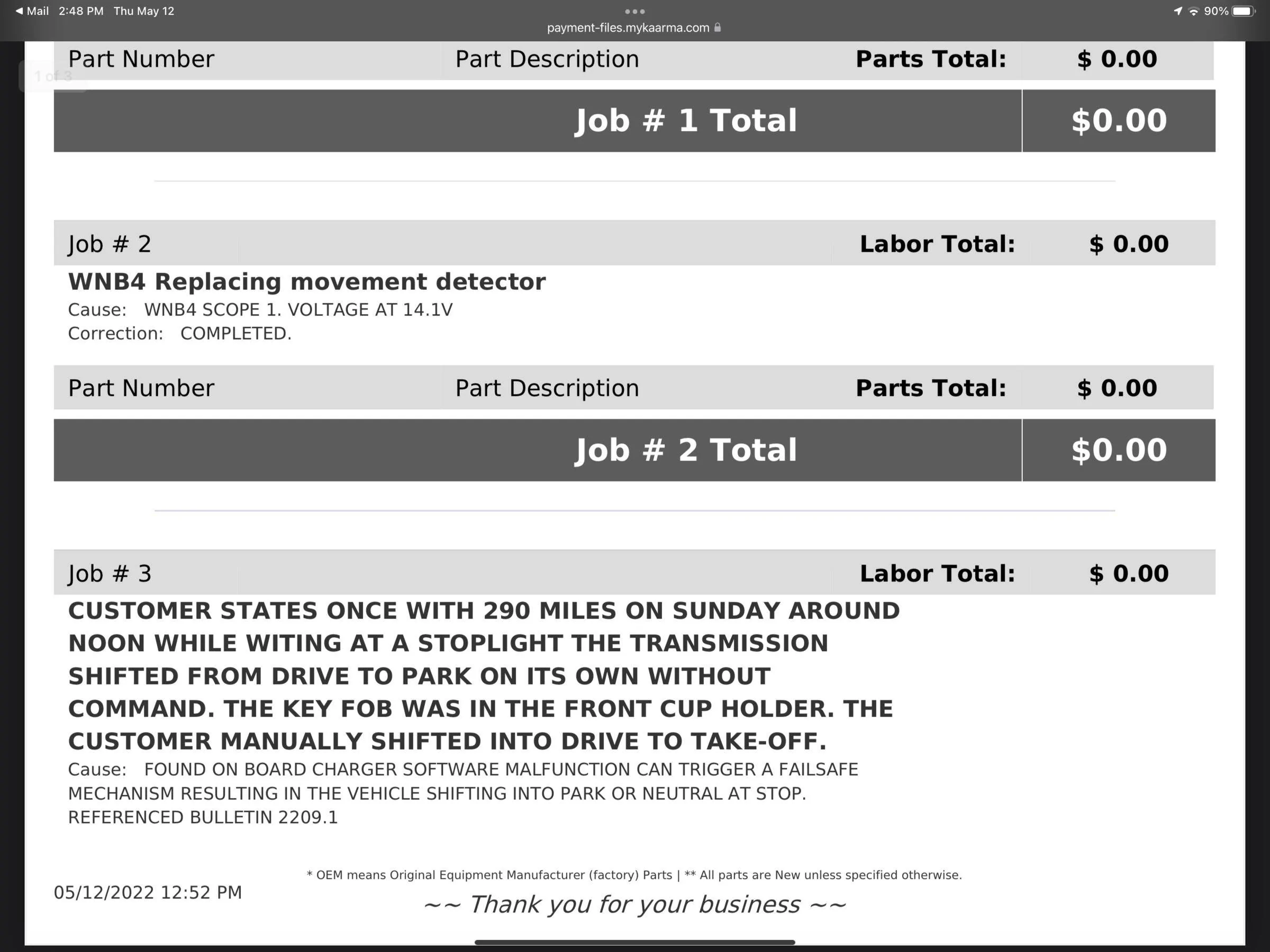

Ugh…I was afraid of that possibility….I’m monitoring our car on the app…it hasn’t moved since I dropped it….no change of charge status.
Fsudoles
Tom
Dec 27, 2021
444
267
Lauderdale by the Sea, Florida
2022 Porsche Taycan RWD
I got a text late yesterday….they are performing a “software update” this morning….I’m picking up the car early this afternoon…we shall see.
