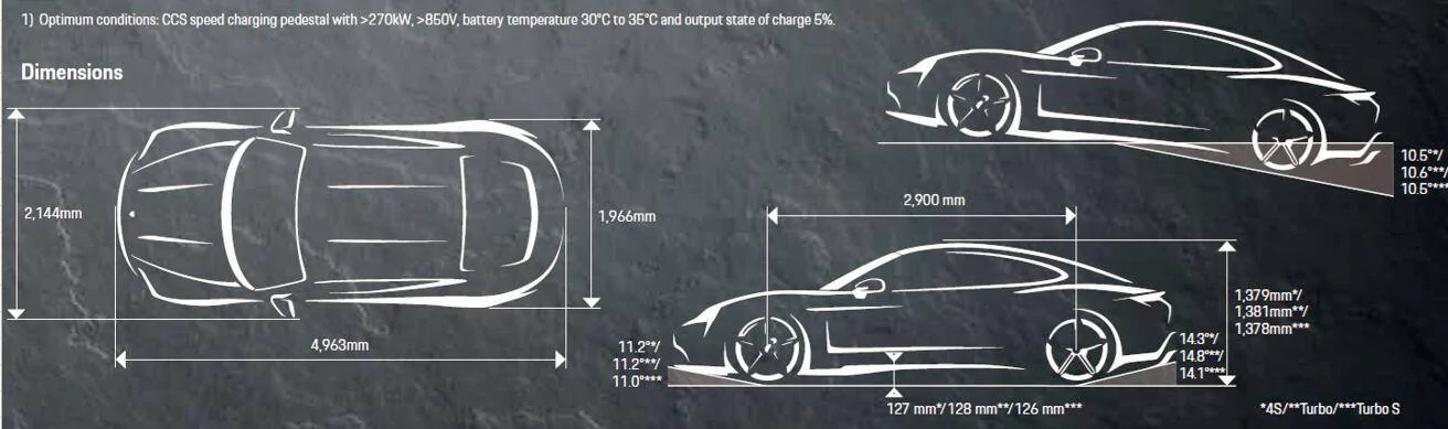

Anyone know...... Is the overall car height quoted in the Technical Data section of confuserator (1381 saloon and 1412mm CT).... measured in 'Normal' suspension setting? or Lift? or Lowered?

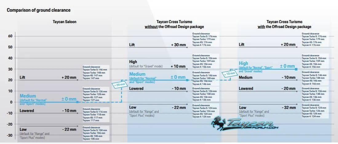

Thanks for this Fcmbr - Sorry I must be missing it - How does this relate to the height of the car?
It seems to be about ground clearance.
Thanks
My mistake. I was a bit too quick in reading and responding. The only useful thing about this chart as far as overall vehicle height is concerned is that you can at see what the difference between the different ride modes is.

If you use this chart with the other 'ground clearance' chart it would suggest the height used here is in medium suspension setting.
Also height varies between models.
As 1381mm is for the Saloon Turbo on medium setting (128mm ground clearance) so would assume the 1412 for CT would also be medium setting.
That is perfect thanks Mr F. - Many thanks
