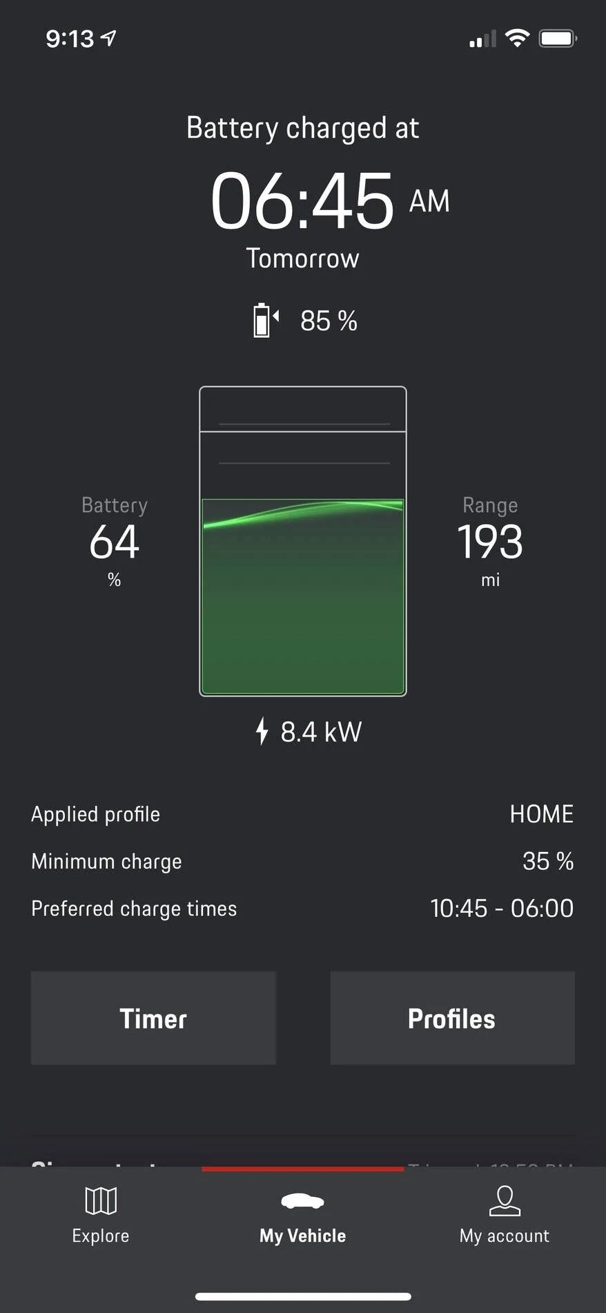

As you can see from the photo, my car is supposed to start charging at 10:45 PM. Even though the car is supposed to charging at 10:45 pm it begins charging at random times. It will then stop and eventually get to the preset charging level of 85% by 6:45 am. The car is above the minimum state of charge. Any thoughts as to why the car starts charging before the preferred charge time? Thanks

Set the departure time to match the preferred charging window.
Check you don't have Direct Charge enabled as this will ignore profiles and timers and start charging straight away.
Check you don't have conflicting profiles and timers enabled.
The car calculates how long it needs to charge based on state of charge, temp, available supply to be ready by your selected departure time. Therefore the charging cycle is variable within the parameters you set. It won't start charging straight away unless it needs to.

No direct charging and no other profiles.

What EVSE do you have PMCC, PMC+, other?
Random thought, is the departure timer not set to 24HR (I can't find where you choose 24HR or not) - mine is set to 24HR.
Nuclear option would be to delete all timers and profiles then start over.

Minimum charge is actually maximum charge. Set that to your desired SOC.

Solution for me was no profile, timer only. Timer set to end of low rates (6AM), SOC set to 80%. Works every time. Starts when it thinks it needs to to be at 80% at 6AM.

Minimum charge is the percent it will charge to when plugged in regardless of timers. Let's say he comes home with low SOC, say 10%, the car will charge up to the programmed minimum level (35%) then follow the set timer.

I am aware on how to set up profiles. The problem is the car disregards the profiles. I have wiped out all existing profiles, reset the charging unit all to no
avail. There is also no consistency as to when the car will stop and start charging. It generally comes on two or three hours before the preferred start time, charges for about a half hour and then stops. Then starts again some time during the preferred charge time. Again it does not make sense.

I don't think their software is very accurate. I have a profile set similar to yours, 85% by 6:45am. My car has never charged more than to 84%. Yesterday it didn't stop, kept going past 84% and 6:45am. I'll monitor it to see if it snaps back to the program, but seems like it starts on time for the proscribed max and time, it may just be that until there is a software update, I'll have to check the charge at 6:45 each day and possibly manually stop it.

Which brand / model of charger are you using?

Disable all profiles and see what happens.
