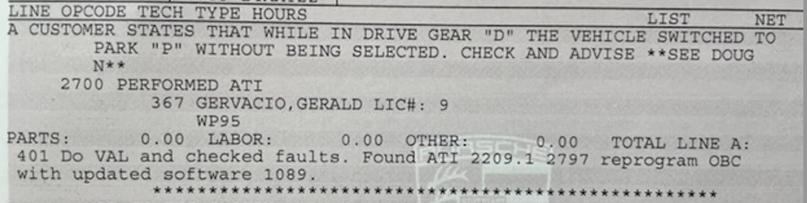

Have you showed him the screenshot of the update applied to my car a few weeks ago? I posted it below again. Wonder if there's a new update coming up somehow?
My car has not had any issues since the update.

We got the update for this issue….and we haven’t had the issue since. Ours went from Drive to Park at a traffic light…2022 RWD with 500 Miles on the odometer. It did take several days, they wanted me to leave the car because they deemed it a safety issue, they had it ten days or so….but they gave us an Macan loaner. Car is at the dealer again for Auto Recuperation shutting off several times per day…various driving scenarios…we are on day eight now. I could’ve dealt with this issue, but I want the car perfect, not 99% perfect. Anyhow, hopefully getting it back soon.

Update: it’s been nearly 3 weeks since this update was applied. Our CT4 is a daily driver and this problem has not re-occurred. Hopefully it stays that way.

I was just days away from taking the buy back check for this happening only once. Canceled the buyback and got the software fix. No problems since.
