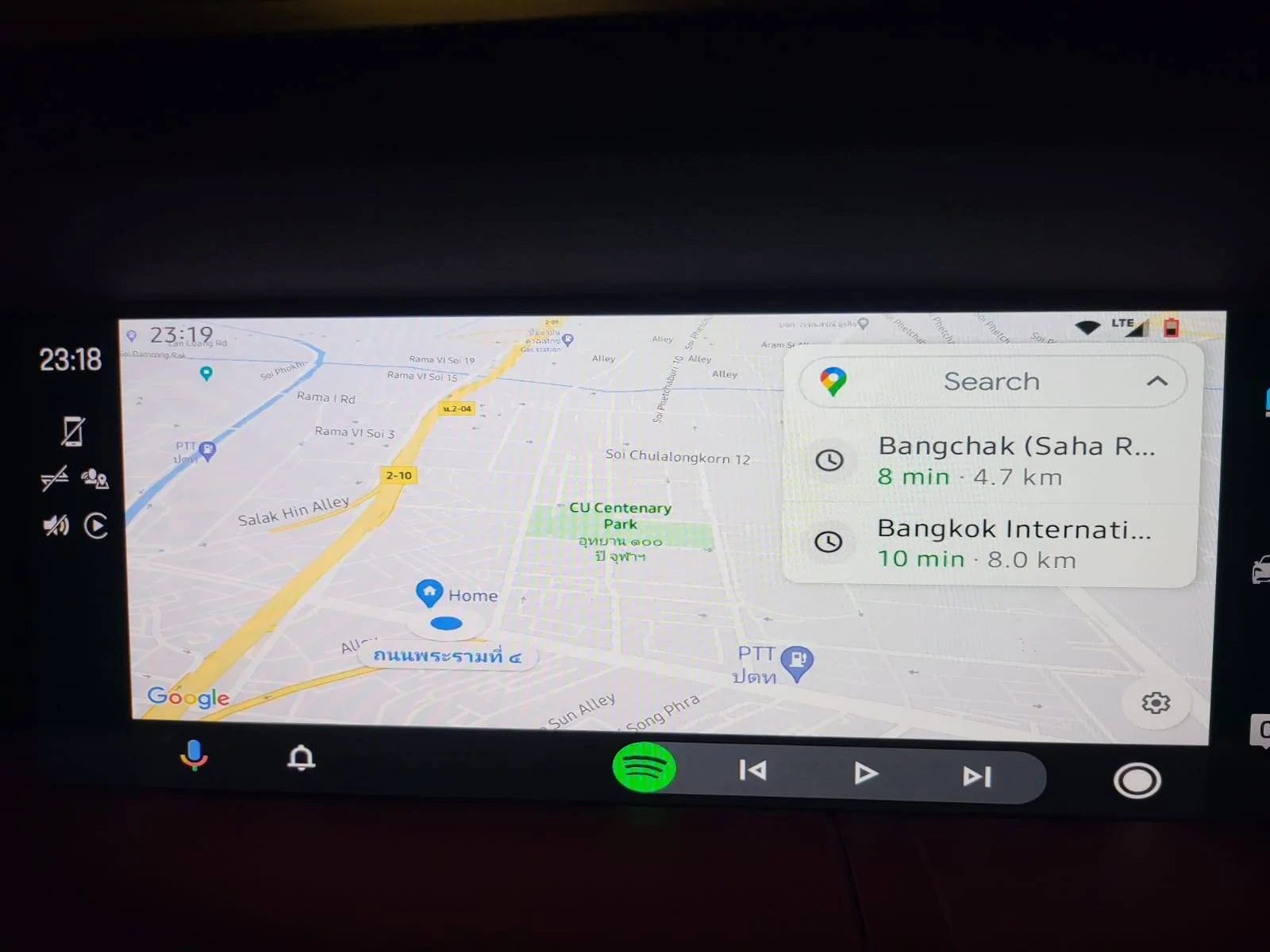

However, the box has an app called "Speed Play" which acts as a bridge for wireless android auto for my phone and the PCM. Due to Taycan's widescreen resolution (1600x720), the android auto screen got stretched a bit to fill the space. Latest android auto update brings split-screen support for the widescreen resolution, but I cannot make it appear on UX999.

Additionally, the Zlink5 app for wireless Android Auto/CarPlay which superseded the Speedplay app does support a high-resolution display with a newer AA split-screen feature.
All of my previous gripes from the previous iteration (UX999) are fixed on the APM888. I'm pretty satisfied with my purchase and would recommend other Taycan owners to get one, at least for wireless AA/CarPlay support.
