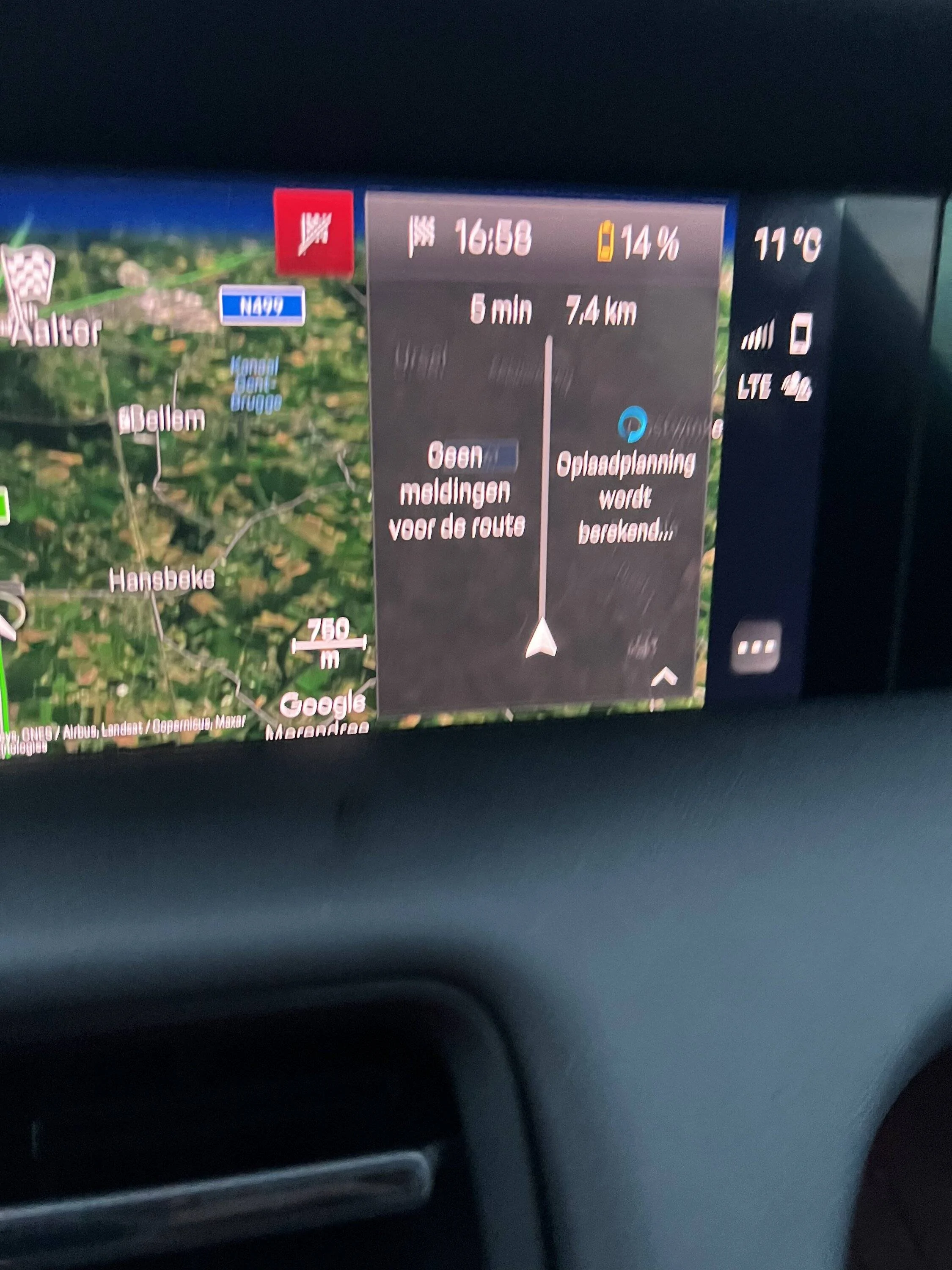

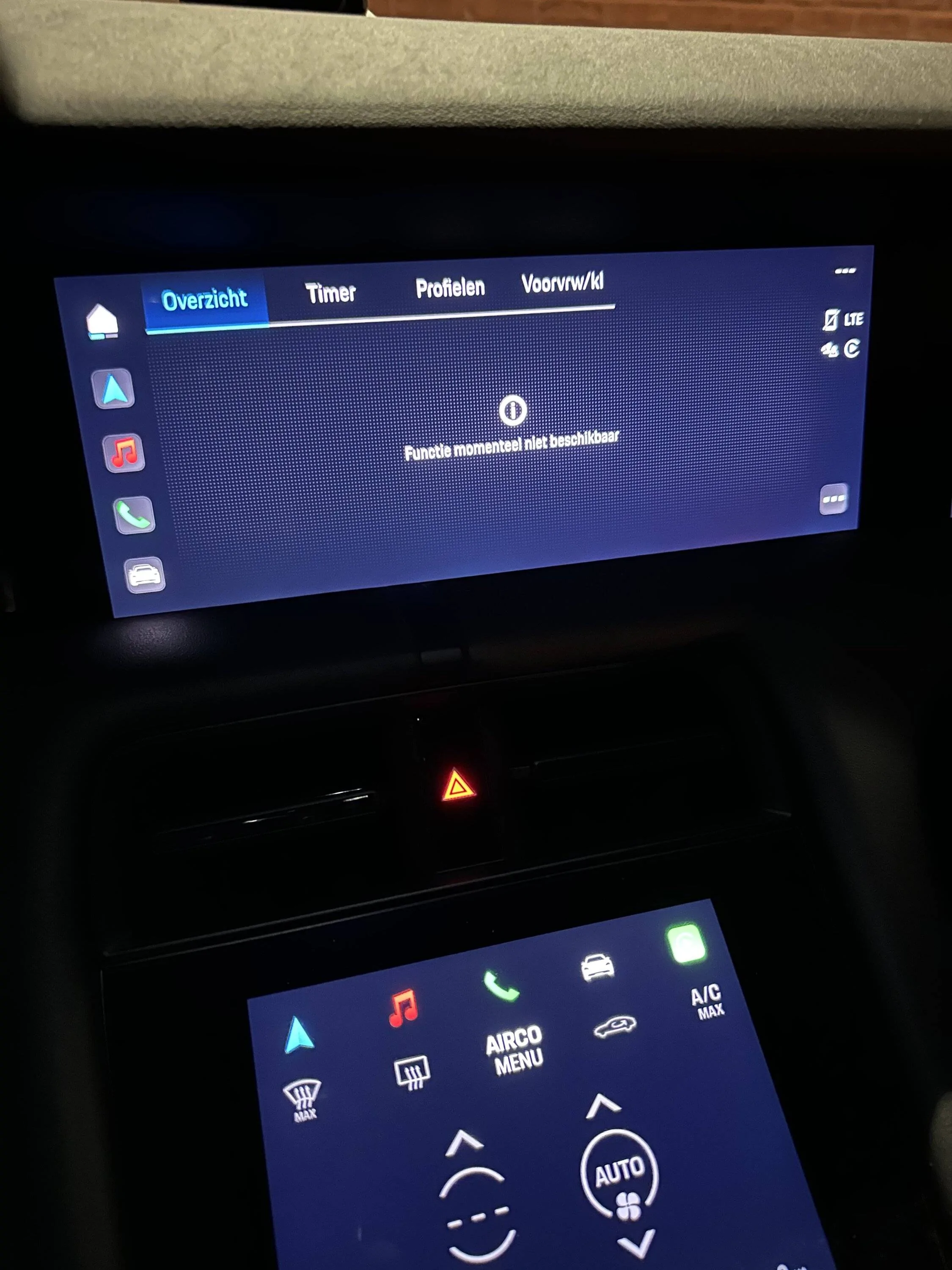

also,when you are waiting in the car with ignition of and listen to radio or you’re calling,after a short period the pcm will get in reboot mode. Also pre heating charger doesn’t work in pcm gps. Last pic.
