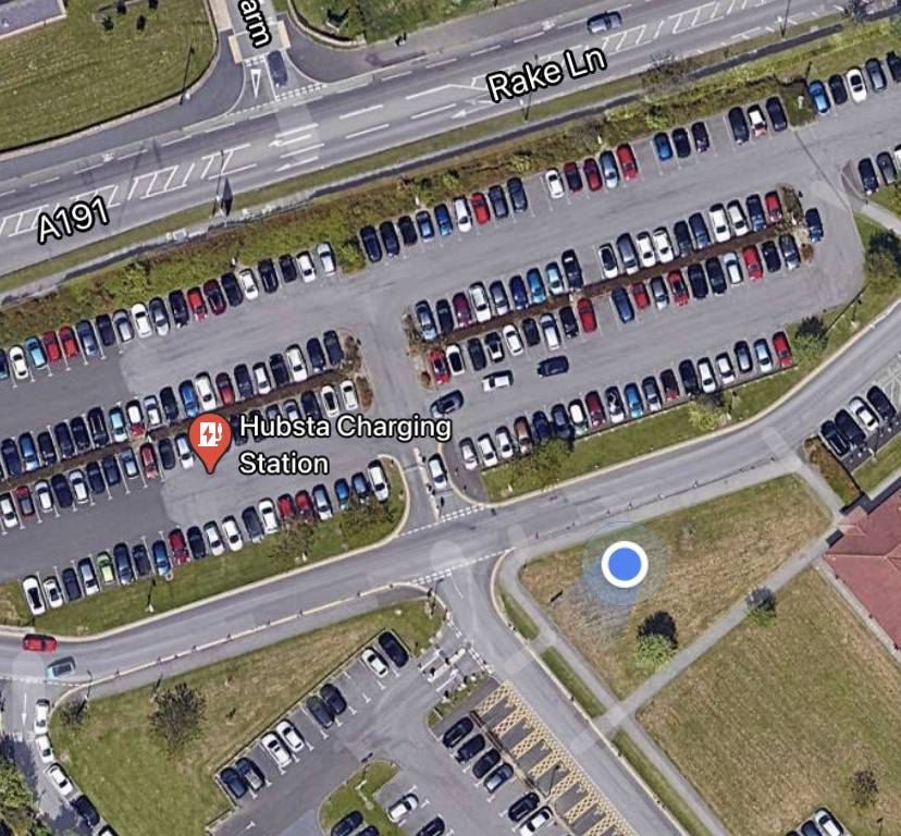

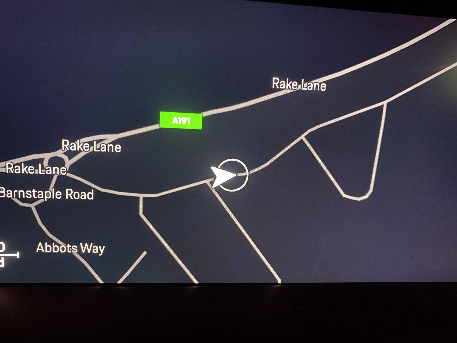

How do you tell the car that the stopover is a charger ?
Even though on google maps there’s a charger, the car powered by google maps can’t see it.
