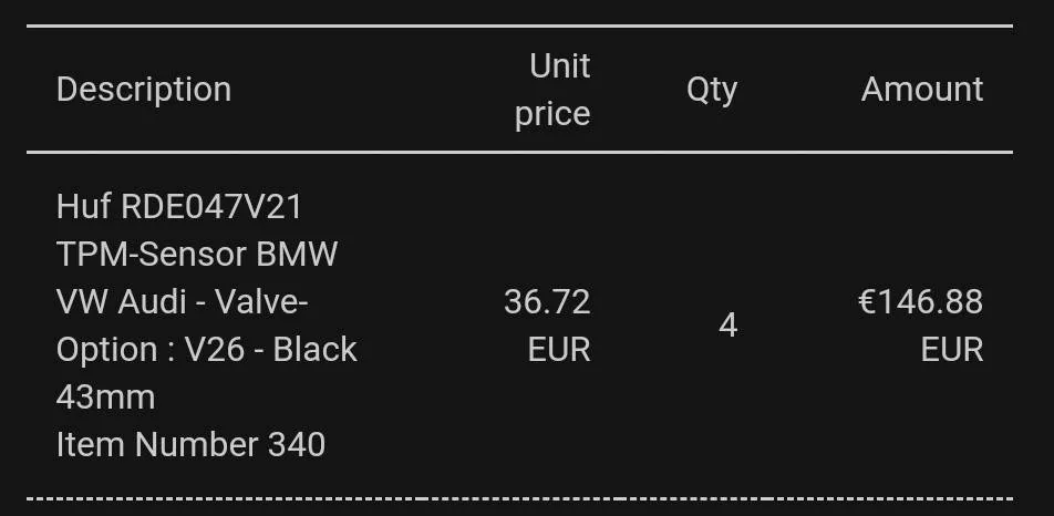

I have bought the same wheels a few months ago for use in the summer - which is not yet :) so bear in mind I haven't actually installed them and confirmed they work.
The TPMS model is HUF RDE047V21, the last 3 digits of the part number are the valve stem colour and I got V26 which are black. This HUF model is preprogrammed and should in theory "just work". I ended up buying them off a German shop on eBay (this was the place https://autotechnik24.de)
Porsche Taycan Changing from 20" to 21" Wheels + TPMS PSX_20210315_124301
Beware that suppliers may substitute in a model they say is equivalent, one shop I initially ordered from subbed in a totally different sensor which would need reprogramming and if I recall correctly had a plastic valve stem.
Like I say while I have the parts I haven't used them so good luck!
