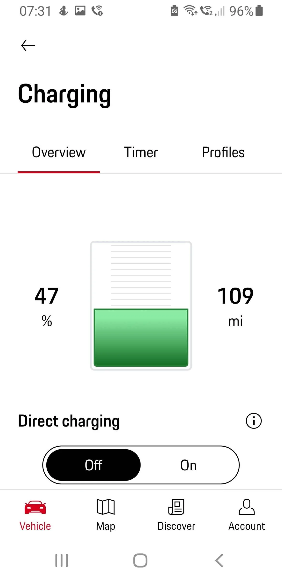

Porsche Taycan Charge over the 80% I setup Screenshot_20220408-073124_My Porsche
As I said it is gone and I do not have any profile in the car. Even if I create a profile I can’t enter the charging percentage.

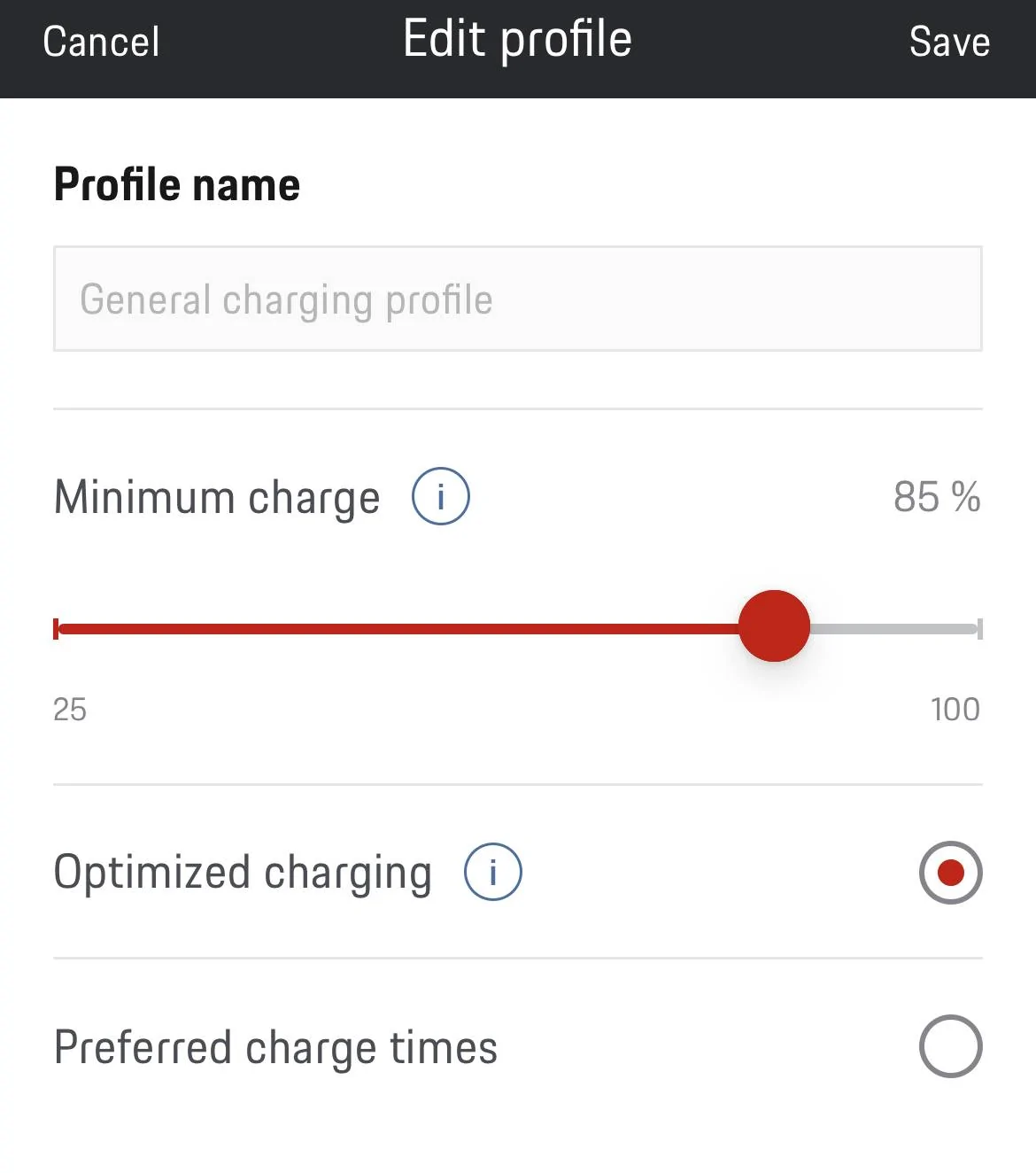

Porsche Taycan Charge over the 80% I setup B0220321-31AC-46CF-B5FF-8ECD75F72E69

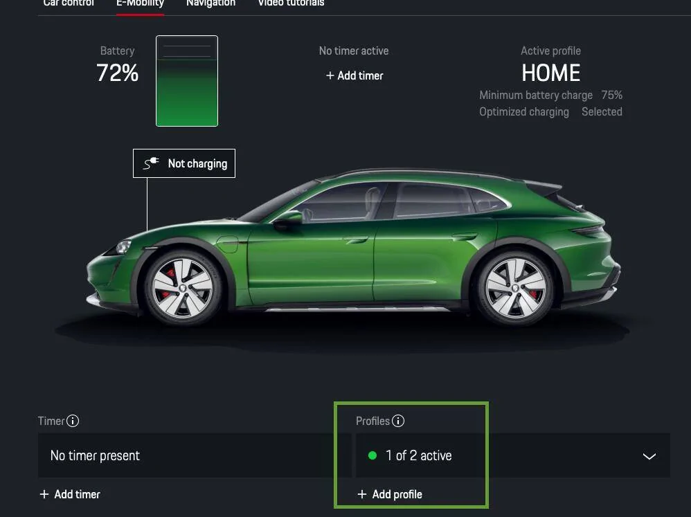

Porsche Taycan Charge over the 80% I setup Screen Shot 2022-04-08 at 2.57.37 PM
What about from your desktop, are you able to visit my.porsche.com and see this under e-control?

I had to create a profile and the direct charging appeared again. As far as setting up to percentage charging threshold 80 or 85% I do not find it.
I should missed something but I’m not sure what.
If you don’t care what time it charges, use the Profile and set the Min Charge to the value you want the car charged to. Also set the profile to Optimized and not Preferred Times
If you want it charged at certain times, use the Timer and set the Target Charge to the value you want the car charged to and the Departure Time to the time you want it charged by.

I found it on the profile. I get misleads because of the header saying mINIMUM.
I Changed the 25 to 80 in the car. It works now but the option is not available on the app anymore.

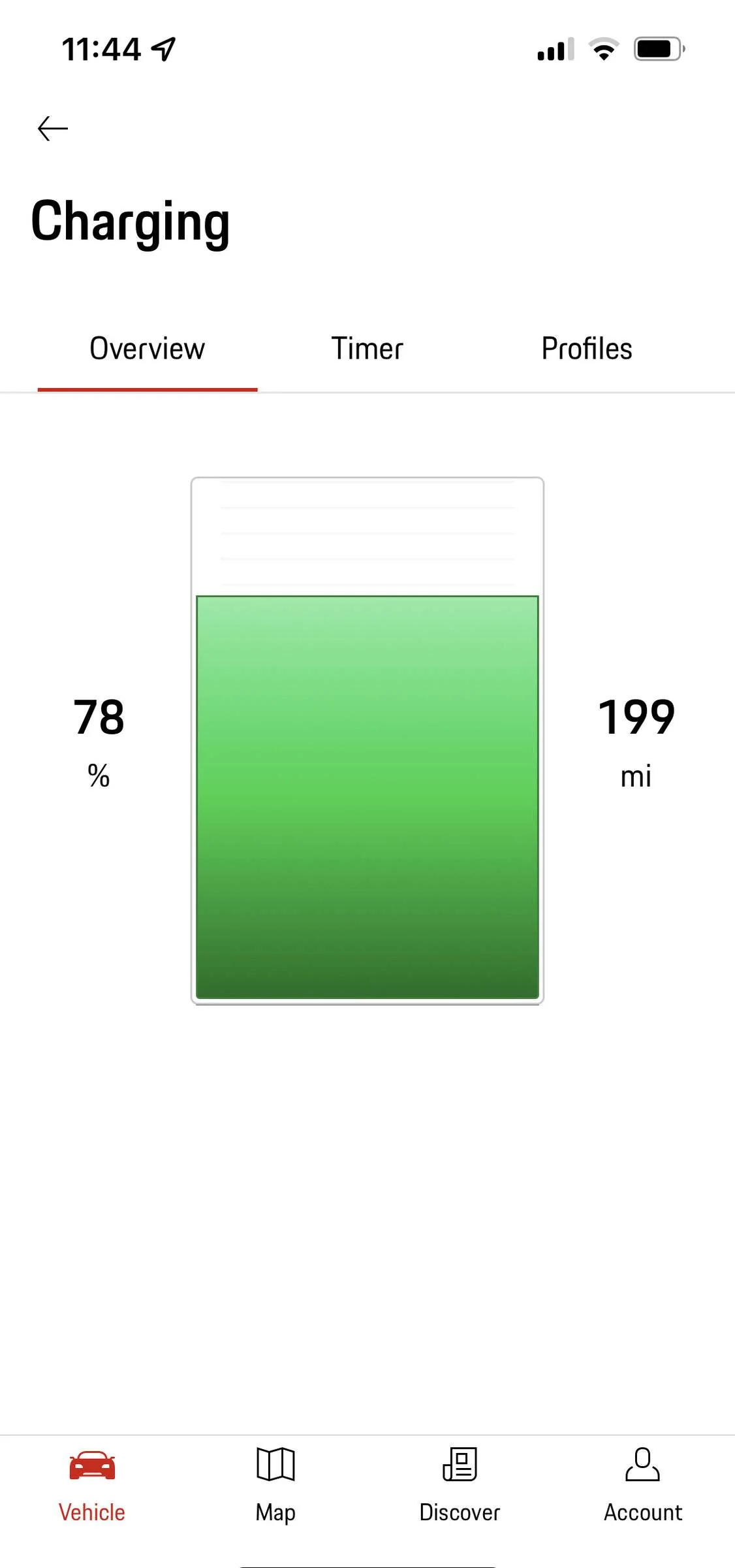

I think you’re using the My Porsche app. I’m still using the older Connect app and it’s still present on there.
Porsche Taycan Charge over the 80% I setup D12E85FA-CA84-4CA0-9C3E-AAAC98A1431A
A lot of people get confused by this. It is the minimum charge for the car; the value the car will charge to immediately. After that, other things will take over if applicable, like timers, to continue charging beyond that minimum. If no other functions are set/active, then the charging will just stop at the the profile min.
