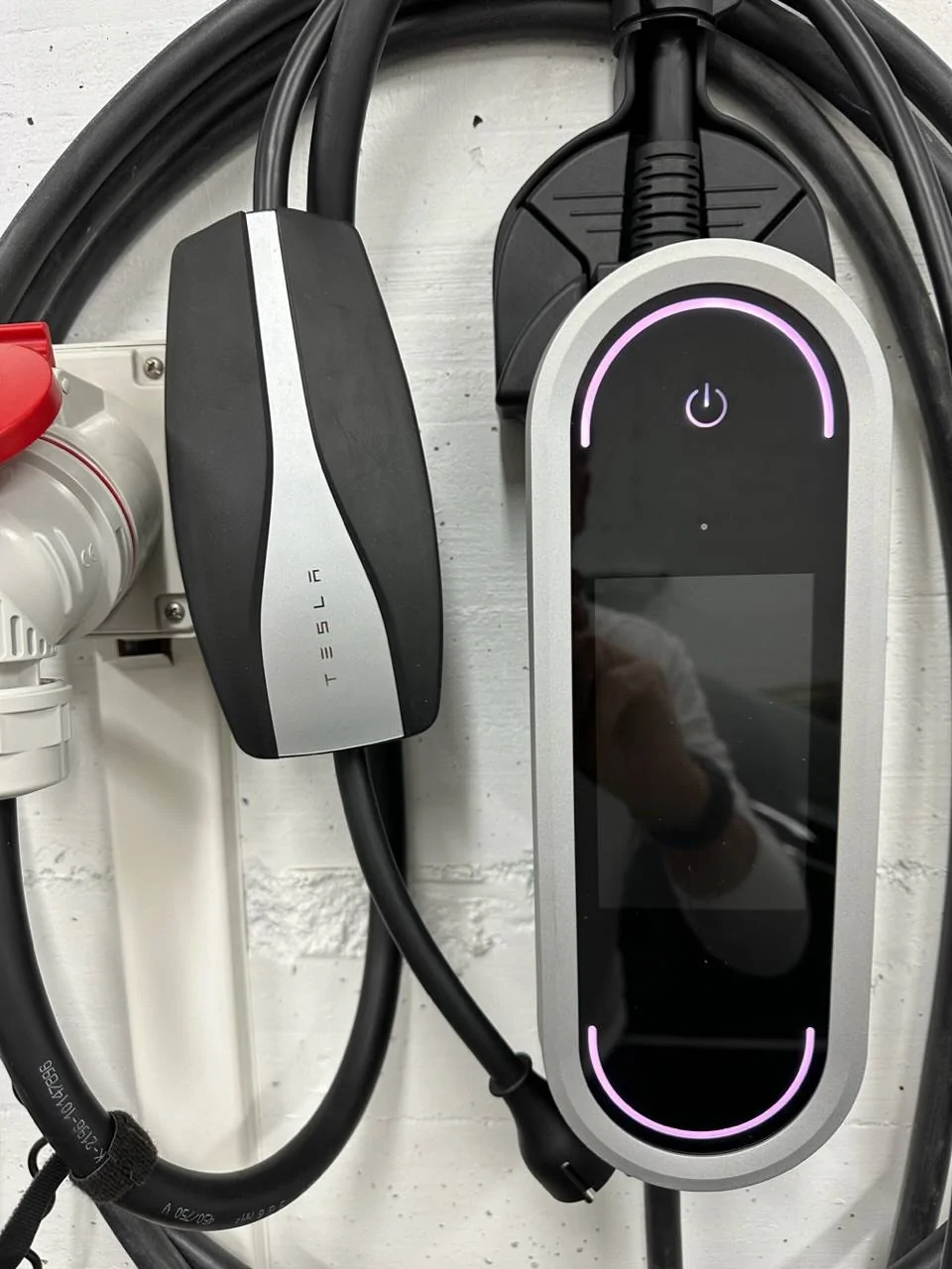

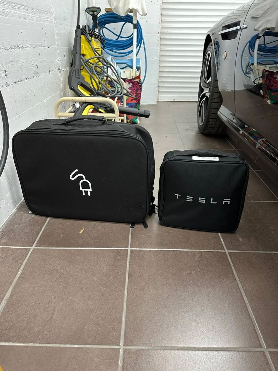

A size comparison picture between PMCC and present Tesla UMC.
The only thing missing in this comparison are a picture of each on a scale, and a thermal image of each while charging at full rate. :)
3,084
2,687
There is actually no difference in temperatures when charging. Remember this is Europe and with 3 phase at 11 kW. The PMCC cables are all cool at that level. Only 16 amp per phase. supply cable might be a few degrees warmer and might be possible to measure with an instrument, but insignificant.
The Tesla UMC only has one phase at 32 amp but runs cool.
The same at full 22 kW charging. Slightly warmer supply cable but nowhere hot. Could easily charge at 22 kW for 0 to 100% without issues. 32 amp per phase.
Benefit with the bags as seen is that the Tesla bag lies flat on the floor of the Frunk!
