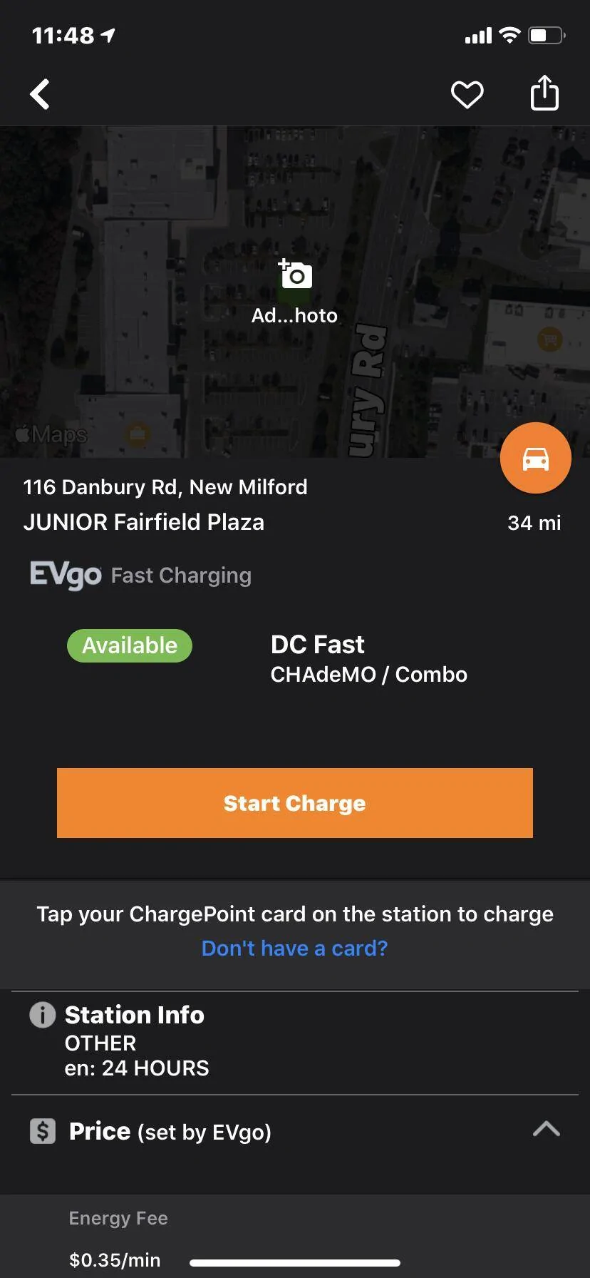

Yes you are correct - Sorry for the confusion. The EVGO location shows CHAdeMO/ combo and indicates this is a CCS supported charging station. I have the ChargePoint app and it says it’s cross network with EVGO - but you still recommend both? See pic of my target charger - I assume this will work?

Looks like you're all set!

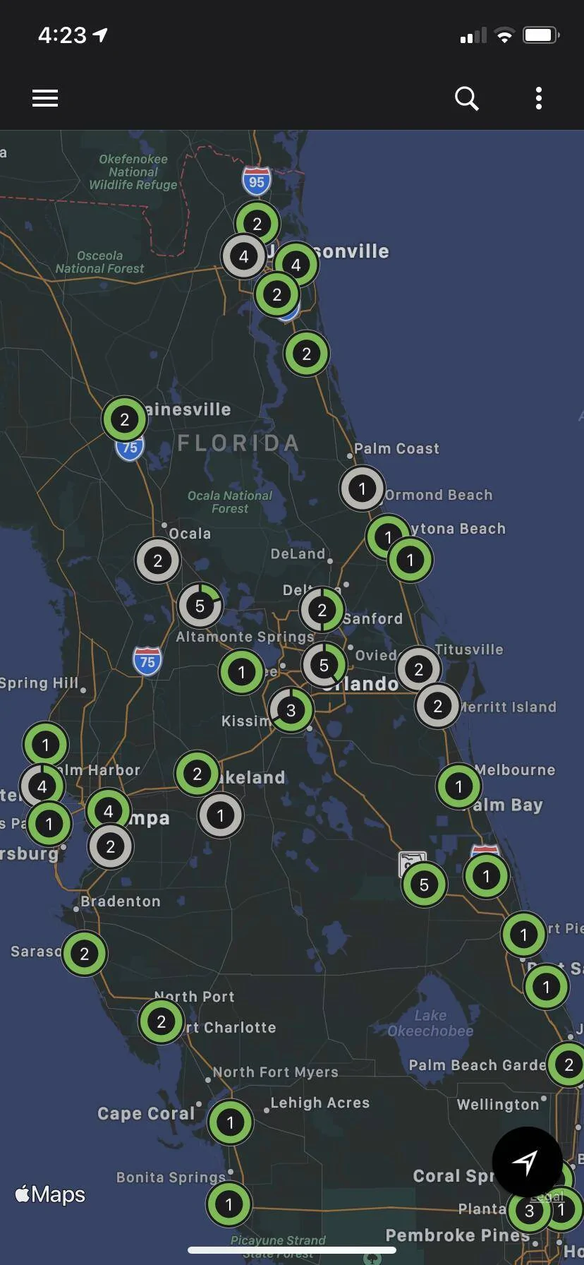

I used the new FPL evolution charging stations at the FL turnpike rest stops. The offer both CCS and CHAdeMO charging fast charging. I charged from 10% to 90% in 14 minutes. It was 265kW charging. By the way, I got 260 miles of aggressive highway driving on 100% charge.
@gasman93 what part of the FL Turnpike did you find the high speed chargers? Looking at the FPL Evolution app, most of the chargers near me (South Florida) are showing max charging at 6.6KW.

I found some on the app, the white circles are fast chargers
