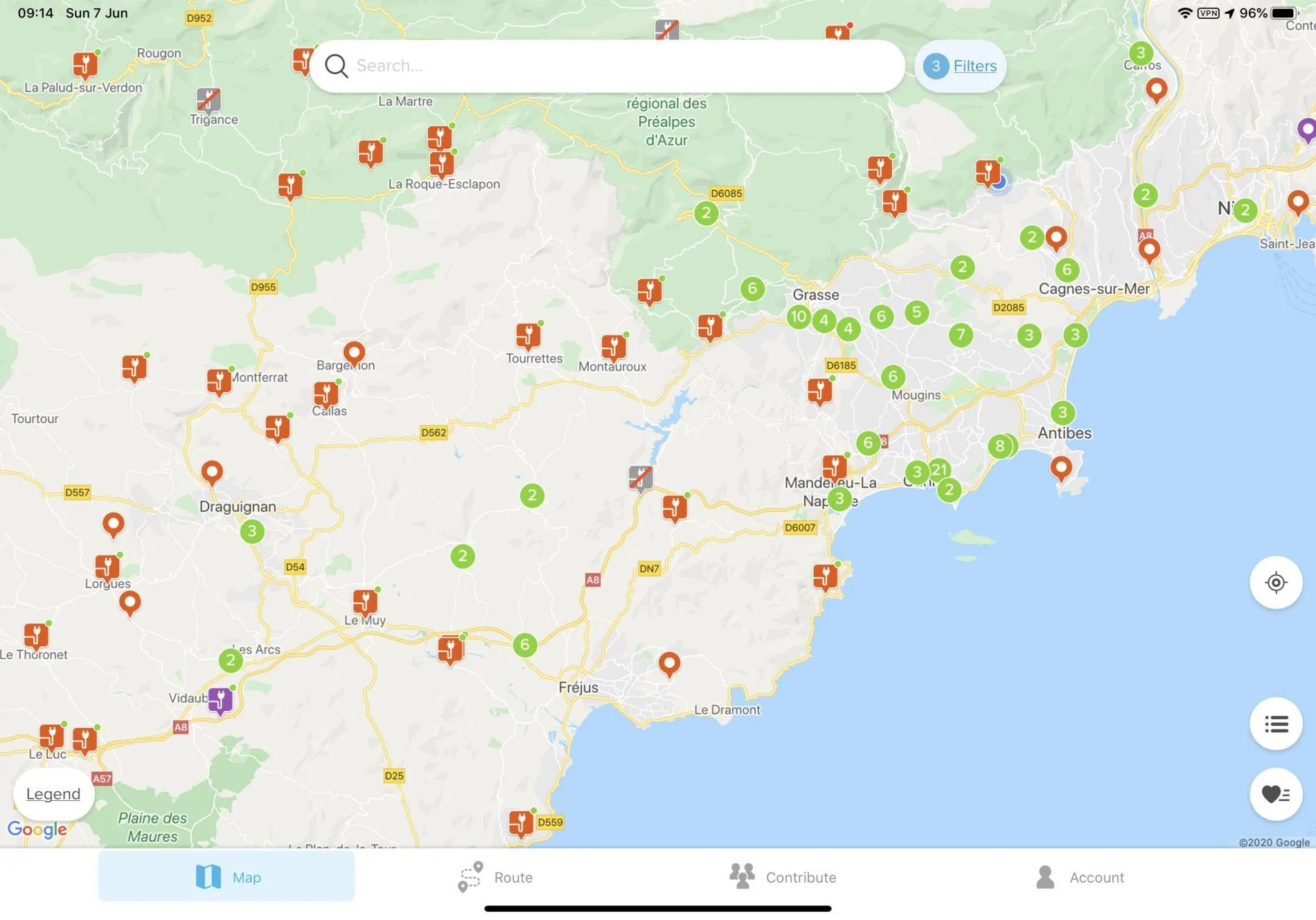

Well I for one would have loved to have a 22kW charger in my Taycan. I have 3 phase with 64 amp into the house and can charge a Tesla model S with 22 kW, if needed. But I fully agree it all depends on your use case. 11 kW is plenty at home if you need the car on a daily basis. It charges fine overnight at 11 kW.
But my use case is for longer tours with the car. Up to the Italian mountain areas (at least pre Covid-19!) or to the French and Italian vineyards etc. There are not that many HPC in Italy as yet, mostly up to 50kW, but very often out of service. Too often in fact.
in my screen shot below you can see the number of 22kW capable chargers there are around about a 1 hours drive from home. Hundreds! So if you need to top up and the 50 kW is down ( normally just one charger as well) there are options to get you going. And nearly all of these are covered by the Porsche Charging Service. And most of France and Italy have similar density.
Until such time that Ionity have built out a proper HPC network, which most likely will take 3 to 5 years, a 22 kW charger option is in my mind well spent money. I guess it would cost maximum 500 Euro for such a charger ( not Porsche pricing perhaps, but normal pricing).

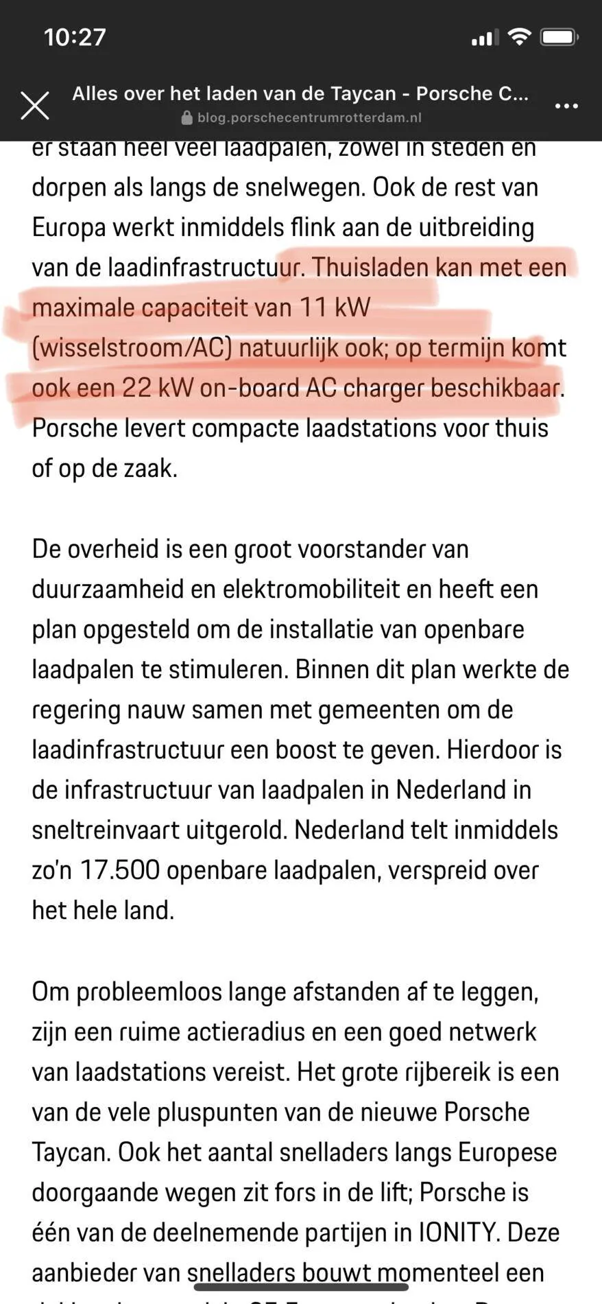

Hi all,
I got an update about the onboard AC-charger.
A information blogpost from a Porsche Centre in the Netherlands says the following:
Porsche Taycan Charger 2021 Taycan 4S Schermfoto 2020-06-11 om 10.27.12
The highlighted text says the following: 'Home charging is possible with a maximum capacity of 11 kW (alternating current / AC); in time, a 22 kW on-board AC charger will also be available.'
The MY2021 is therefore expected to have a 22Kwh AC charger!

Hi all,
Nice to have something in writing. But it does not explicitly say WHEN this 22 kW on-board charger will be available. It might be MY21, but who knows?!
I know from personal experience with the Audi e-tron that from the time it was introduced in late 2018 / early 2019 that they had promised that a 22 kW AC charger would become available. But to this day, it cannot be ordered. Allegedly, because of some trouble with the supplier of this part it's been delayed over and over again.
I have also an inquiry ongoing through my sales rep with Porsche Germany if and when this feature will be available. I hope to get some information by early next week. At least, that's my sales rep's expectation when he will get a feedback.
