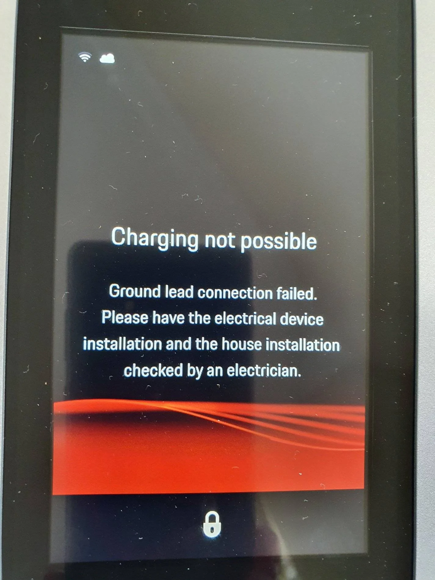

So after a few hours of charging from domestic standard 240v outlet (UK) with the supplied porsche charger it keeps stopping and delivering this message. My 7KW home charging point isn't installed till next week so this is my only current solution, so its frustrating to say the least. Whilst I cant guarantee this, I'm pretty sure there is no problem with my house wiring, and if there were a fault why would it start and run for hours before stopping.

There might be a problem with the grounding of your socket wiring? I would get an electrician in, since the car does draw a lot of power...

Try it at your office or someone else’s house. Might be worth filing out a small fault in the charger.

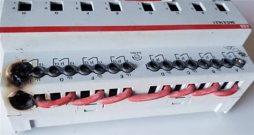

Wrong installation for electrical floor heating, which draws a lot of power, almost created a fire in my home. I would take the message serious.

This charger only pulls maximum of 10 amps as its plugged into UK domestic socket outlet which isn't huge and is on a protected circuit. I find it strange that it would even start if it feels there is an earthing problem. This happens after several hours of charging. Will get it checked but I'd be very surprised if there's an earth fault as wiring is fairly new and tested.
Unlikely to ever use this charger again anyway as the 7Kw charger is being installed tomorrow.

If there is a problem, it might not show up until the wiring has heated up and resistance is increased to the point that the charging station detected it.
You could change the maximum charging Amperage on the charging station. Maybe drop it to half whatever it is set to for now. Until you can have someone investigate.

Thats a good plan. Will try that this eve

I would heed the warning and have an electrician come out and verify the wiring. Sounds like you have one coming to hook up your charger, so until then consider only charging at locations around town.
