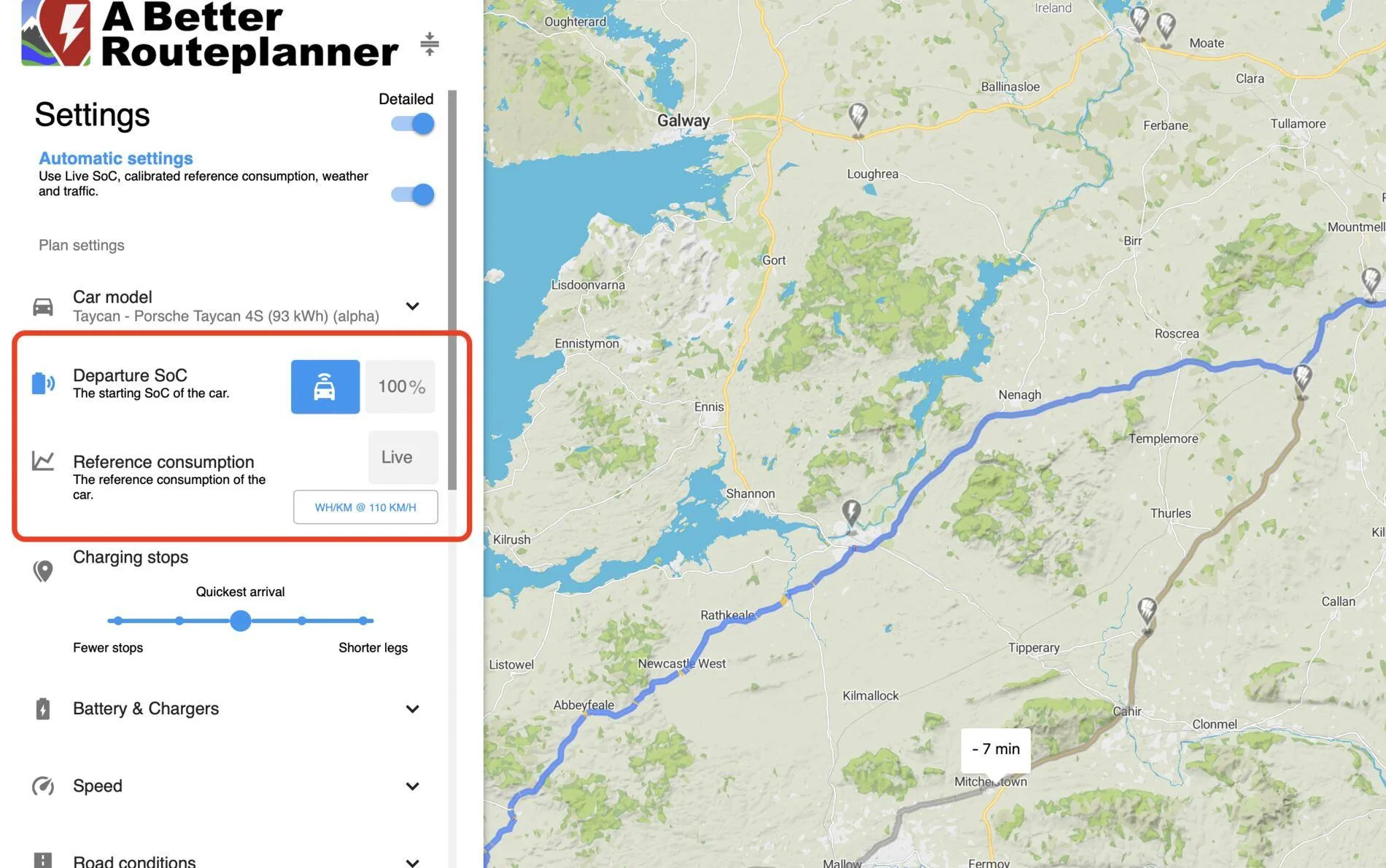

I do not have PIRM installed. But the Navigator does exactly the same for me. It can plot a route to a 50 kW charger rather than a HPC just down the road. The detour can be a few km’s even. I set it to the same as you have and tried other options as well.
In a trip report I made it got a bit to close to comfort as it routed me to a 50 kW charger that was occupied and the next HPC (Ionity ) was just within range.
I now have a procedure to plan the overall route to my destination, and then include Ionity chargers as stopovers. These stopovers are chosen with the help of ABRP and then searched for in the cars navigation system. If you turn on the feature to see your range, you will see if the car thinks it is possible to make the stopover. The battery is then preheated before arriving at the HPC.
I have ABRP Premium subscription and after adjusting the reference consumption in the app over some trips, it now is quite accurate. There is also a possibility to have the cars actual SOC and consumption included. That is however another subscription and I do not know how well it works. ABRP will also adjust to the outside temperature and wind conditions. Might be a feature of the Premium subscription_
