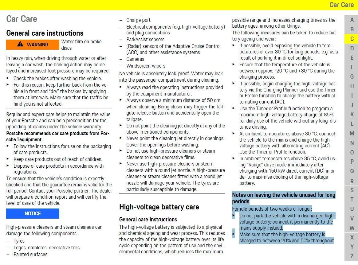

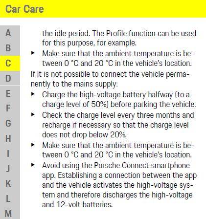

Have they not?
From the manual:
Porsche Taycan Charging at home 1596284935167
Porsche Taycan Charging at home 1596284958383
