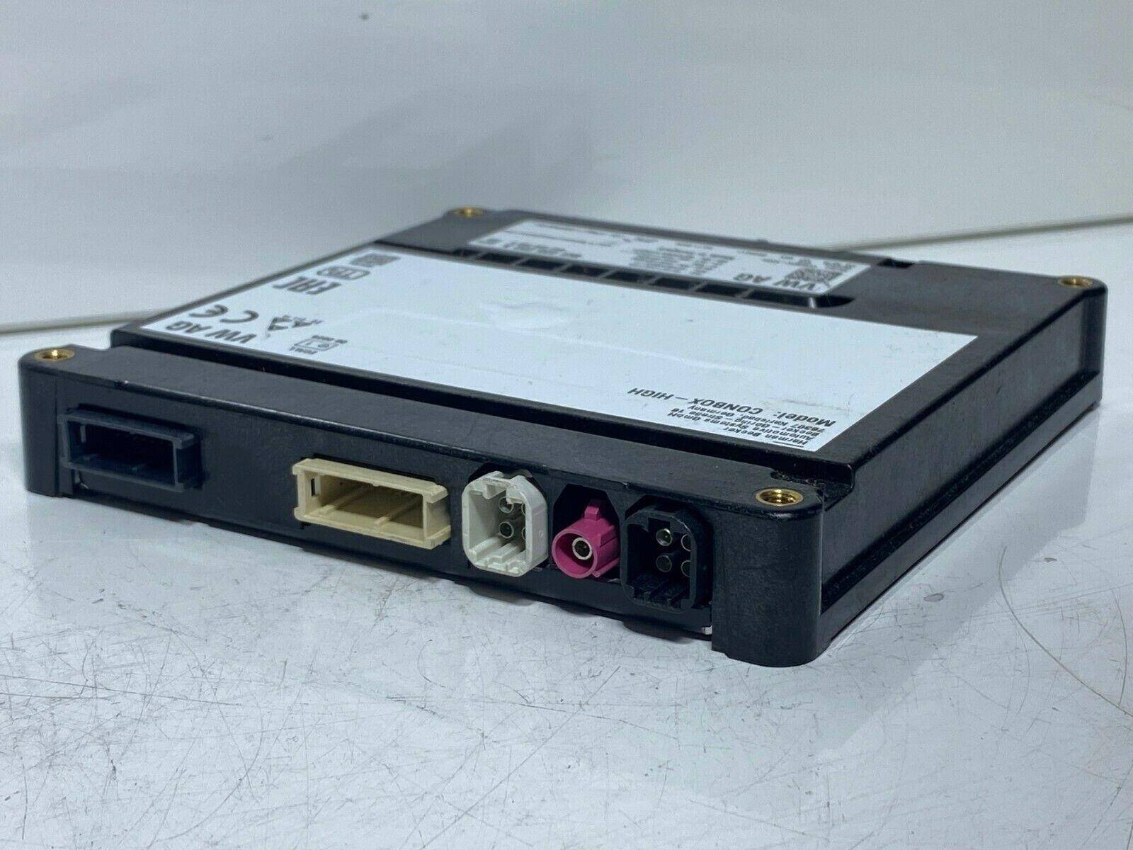

If you look on the Porsche regulatory page "Information related to Radio Equipment Directive 2014/53/EU" at the Used Frequency Bands and max. Transmission Power (PDF; 1,9 MB) file, you'll see that the "Communications Box" in the Taycan is called "CONBOX-HIGH".
CONBOX-HIGH appears to be a common VW product manufactured by a company called
HARMAN BECKER in Karlsbad, Germany. This company is owned by Samsung:
https://www.lamborghini.com/sites/i...022/communication_unit/CONBOX-HIGH_EU_DoC.pdf
It looks something like this:

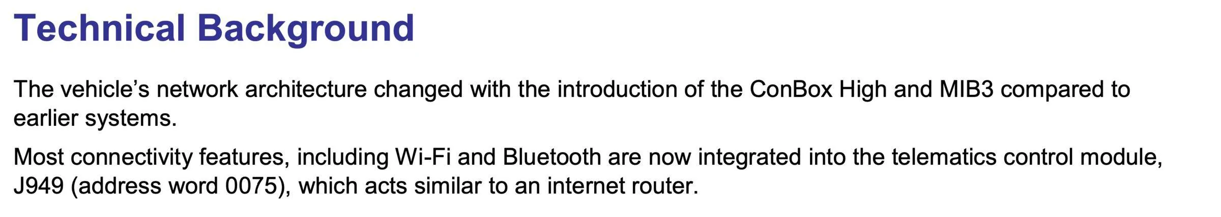

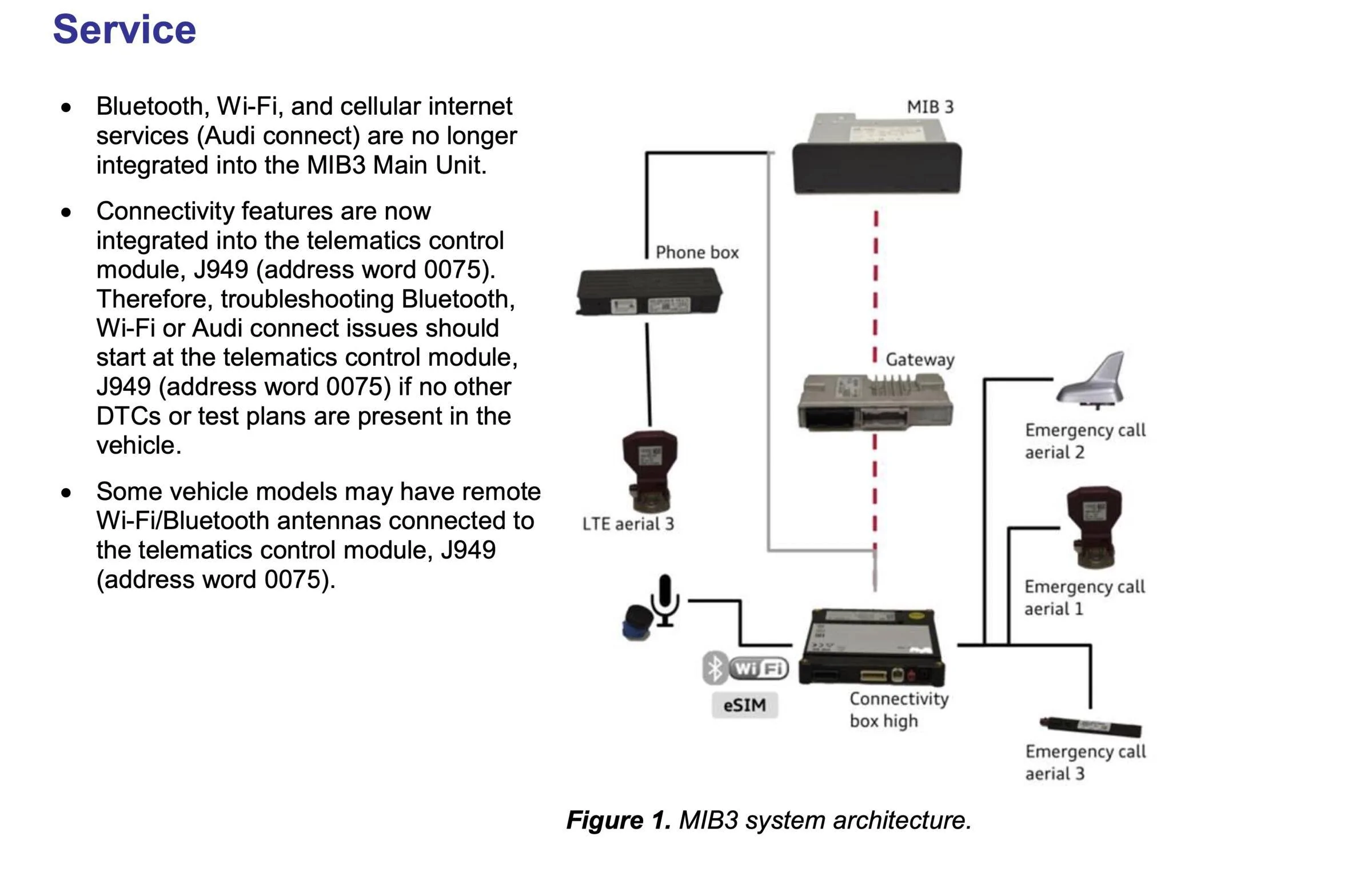

Here is an Audi Technical Services Bulletin that describes how this unit fits in with the wider MIB3 (i.e PCM) architecture:
https://static.nhtsa.gov/odi/tsbs/2020/MC-10183468-0001.pdf
Porsche Taycan Charging immediately to 85% Screenshot 2022-03-13 at 10.23.15
Porsche Taycan Charging immediately to 85% Screenshot 2022-03-13 at 10.24.02
FWIW, Audi puts out a lot more info on MIB3 than Porsche does. PCM 6.0 is Porsche's "marketing name" for MIB3 - which is the underlying VW/Audi technology.
And here is an Audi service bulletin from 2020 that seems to describe a very familiar issue with this unit not "waking up" correctly after sleeping:
Technical Services Bulletin – Vehicle cannot be reached
So it feels like various brands of VW have all been facing down similar issues – but I have not yet seen anything concrete from Porsche on acknowledging or resolving the unreliable communications that most Taycan owners – regardless if they realise it or not – have experienced.
