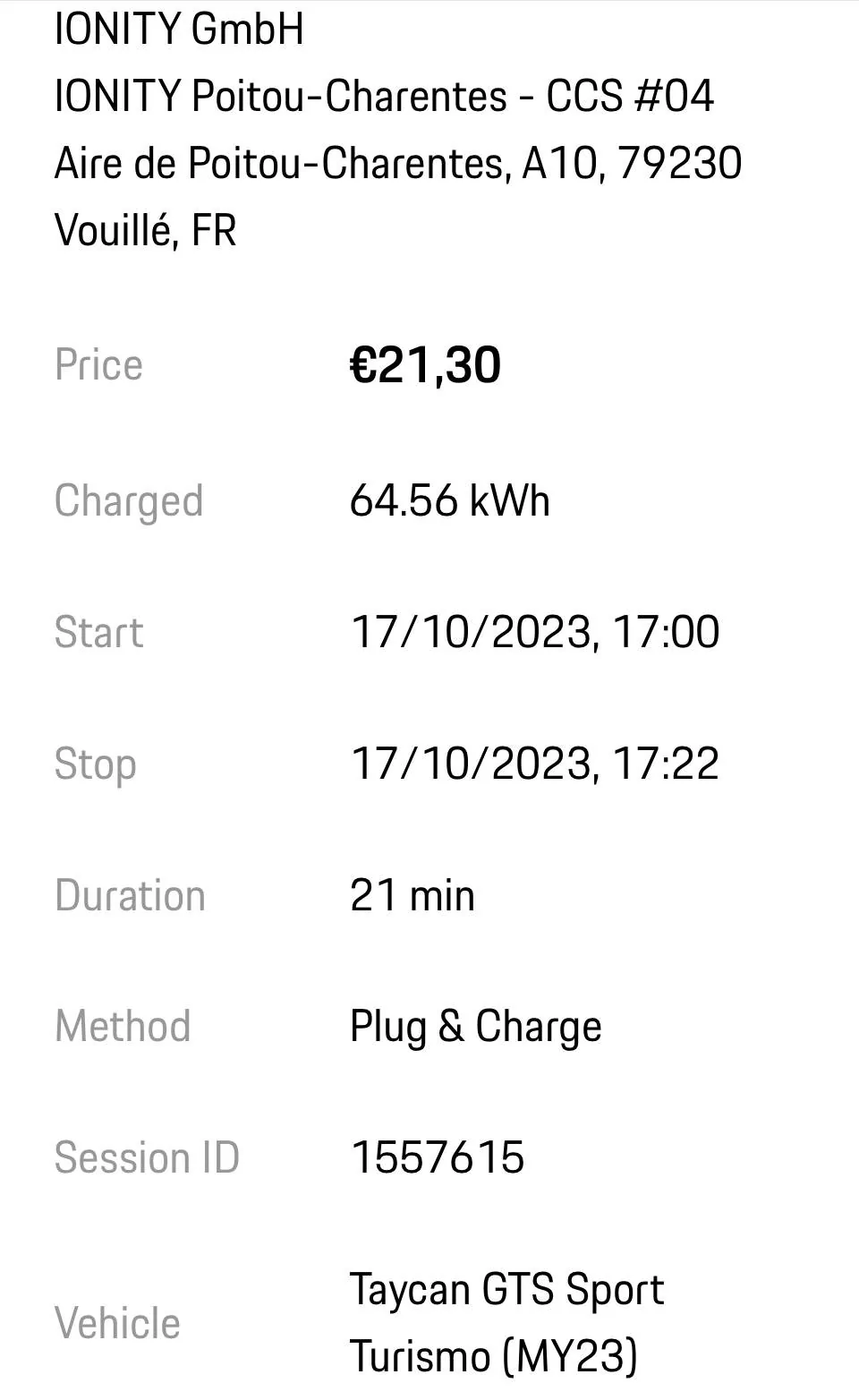

About prices: charging in France 0,3 eur/kW in ultra fast charging, amazing!

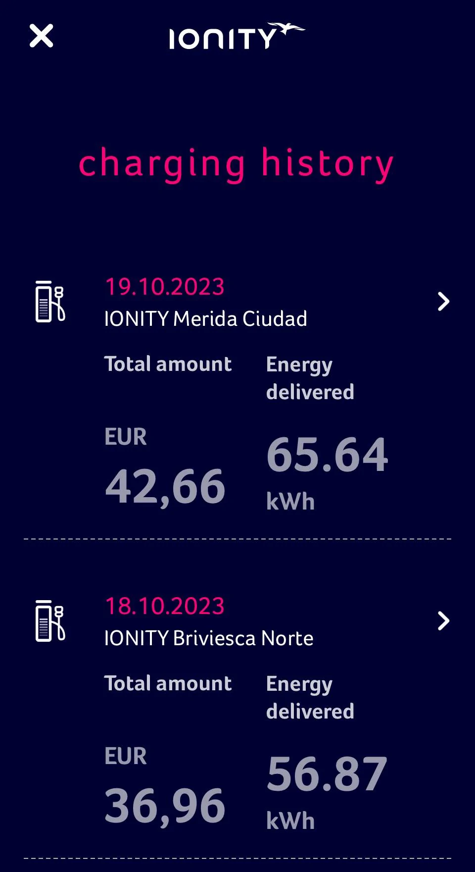

Charging cost is much higher in Spain or Portugal (Ionity Merida, 0.64 eur/kw, same Ionity Estremoz).

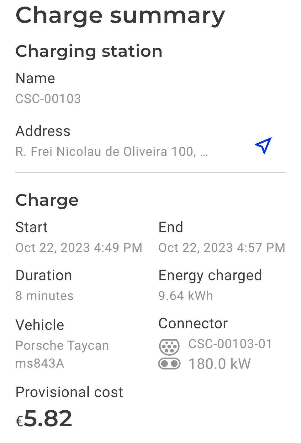

I cannot get those prices, see this quick test I did with Iberdrola:
Porsche Taycan Charging in Portugal: (almost) everything you need to know! IMG_0886
and in France I had this:
Porsche Taycan Charging in Portugal: (almost) everything you need to know! IMG_0887

Plug and Charge isn't supported in Portugal by design. Read my initial post. Every charging station has to support every energy provider. The user must be free to choose any energy provider he wishes independent of charger. Plug and charge locks you to a specific energy provider.
All Porsche destination Chargers are free. In Portugal, you can charge for free at any Porsche Dealership too (They never registered as charging nor energy providers here)
Btw, plug and charge works in Spain. I've charged using it everywhere I went aka Ionity between Huelva and Seville and Walea stations at Seville and further south when headed to Gibraltar. If porsche doesn't have an agreement with a certain provider in spain, then you're locked out of their network. That's the downside vs the Portuguese model where any contract will allow you to use any charger. The disadvantage is that you need to find the best contract. For foreigners passing by, you're limited to Miio and Evio which are the only ones accepting pay as you go by credit card and are generally more expensive then national contracts.
Sorry to hear that you had trouble with Ionity in Spain.
My car is one of the early ones and I do not have plug and charge. With the car I have the Porsche Charging Service card and the MyPorsche app. I have become so used to use these, that it feels natural now. Both come free with a new car to give access to chargers in the network for 3 years.
I saw you used the Ionity app, but then you will not avail of the very competitive Ionity pricing in the Porsche Charging Service. But the pricing of Ionity in Spain is the same as in France, if you check the app.

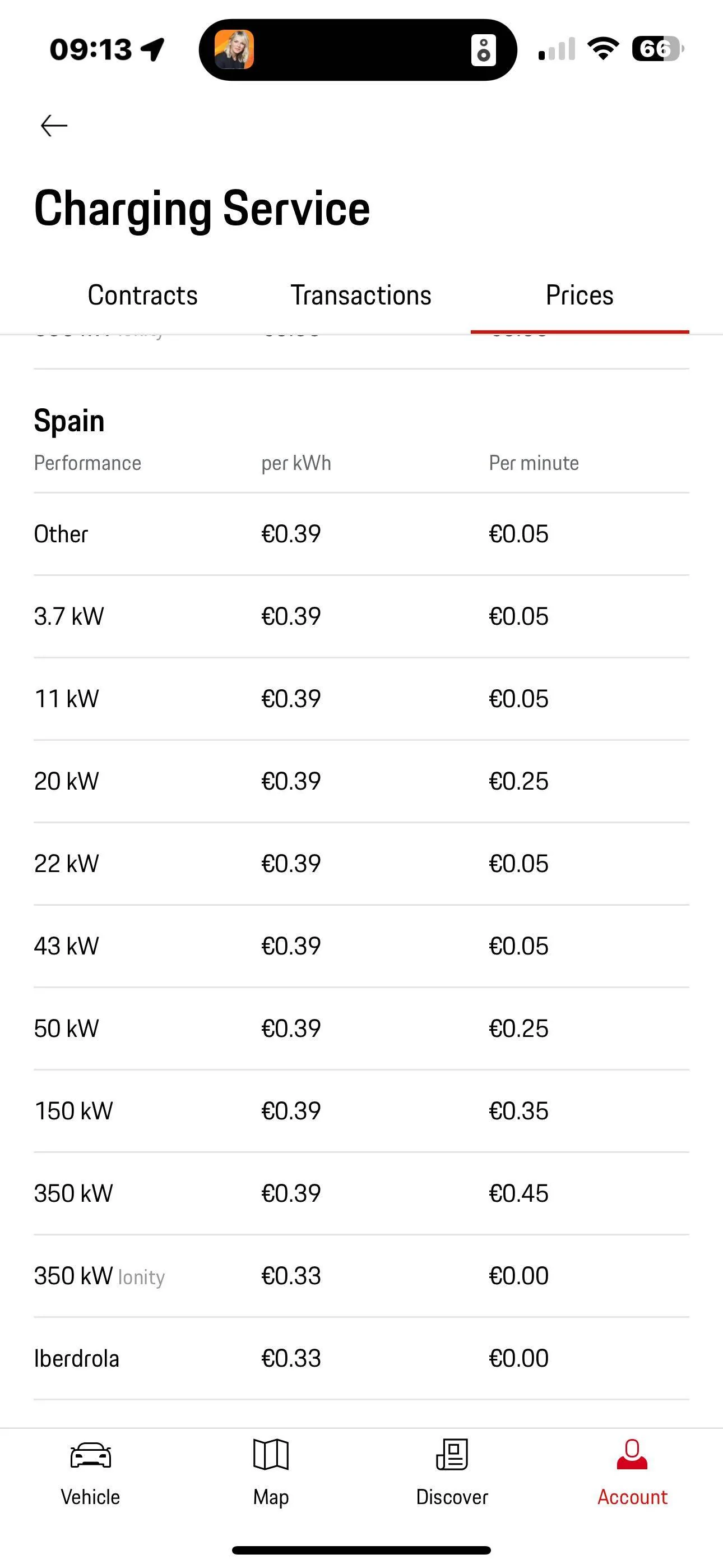

See screen shot of the rates in Spain! And Iberdrola should also work fine??
Porsche Taycan Charging in Portugal: (almost) everything you need to know! IMG_1002
