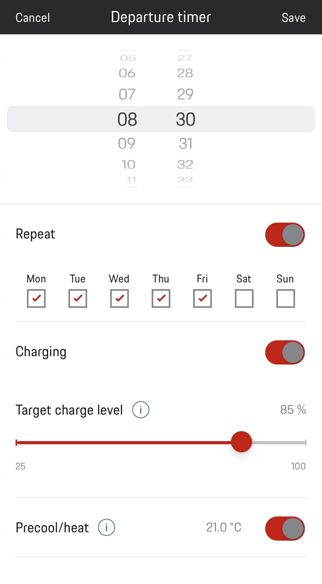

I have a timer set to charge the car to 85% by 8:30am on a weekday morning and to pre-heat the car to 21 degrees C.

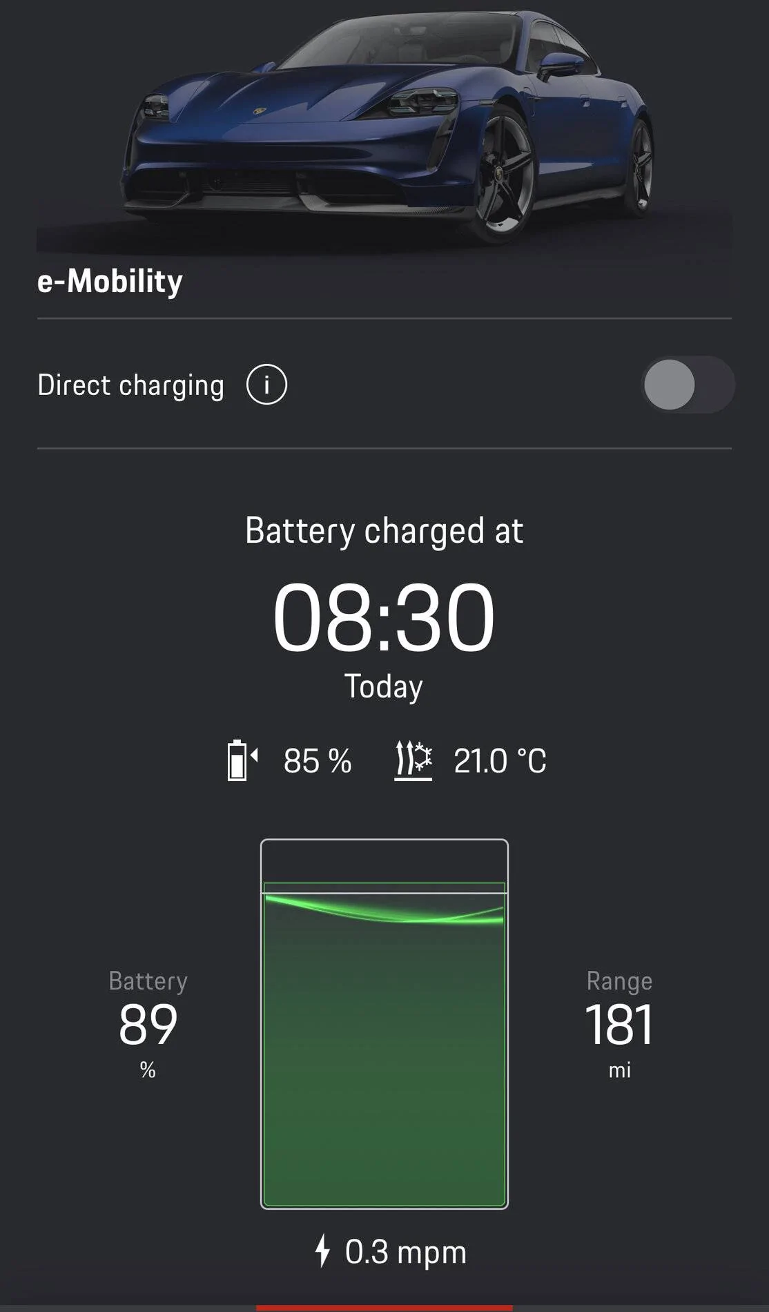

Every time I get in the car on a morning it is either still charging or has charged beyond 85%. I appreciate it is cold here currently (2 degrees C this morning) & I never had an alert to say the pre-heat was complete so am I right in thinking the car will carry on charging until the interior temperature has been reached. Or am I doing something wrong?
I’ve attached a screenshot of the car at 8:20 this morning still charging. I’ve also attached the timer.

I do not think you are doing anything wrong at all.
I have the exact same experience when it comes to preheating the car. I think I have seen by the power consumption that the charger will continue to charge the battery while heating. I have experienced a few percentage points above the set target before, but hve assumed then that it was due to the battery being heated and then showing a few more percent, 2%, above the target. I did also observe that the charging stopped at the same time as the precondition of the interior stopped after one hour.
I believe this is an error in the programming of the software.

Thanks for confirming.
When I got in the car it was at 91% so that’s a fair way above 85% target.
I may back the target charge down to 80% to save me regularly going over 85%.

I have the same experience. If the preconditioning is on, the required charge level is exceeded. The colder it is, the more the choosen charge level is exceeded.
It doesn't look like a bug to me as you can guess some possible explanations:
- I haven't seen my charger trottling down the output power. It always sends 11kW to the car. Heating the cabin doesn't take 11kWs. So the car takes what it needs to heat the cabin and sends the rest to the battery.
- The car doesn't use a heater to heat up the battery. That would not be efficient. It just charges the battery. I do wonder what happens when you leave the timer with preconditioning on every morning and don't use the car. (If I work at home, I usually disable the timer)
- The car assumes you want to have a certain range in kms. Keeping the cabin warm will take extra energy, so it adds a bit of extra charge (the actual additional % will probably be calculated to the milliWatthour :-D )

I didn’t need my car this morning so just set the timer to charge to 85% and it charged & switched off as expected.
Definitely the pre-heat/cool causing it to run on as suspected. So I think the answer is we set our target charge lower to allow for this anomaly.
Glad it’s not me being dumb.
I have actually seen the PMCC throttle down to about 5.x kW while running the preheat only. But the setting for this was a timer on the A/C.
Would be interesting to know how Porsche have designed this. I charged my battery to 80% this morning from about 45% or so. And at lunchtime I noted that the battery was still at 17 degrees C in a garage that only was 11 degrees! So somehow the battery has been heated, but could very well be just by being charged??
Here is a cut from some Porsche document about the battery:
Depending on the outside temperature, the battery is preconditioned to a certain temperature level when the vehicle is connected to the mains for charging. The interior can be preconditioned independently of the mains.
