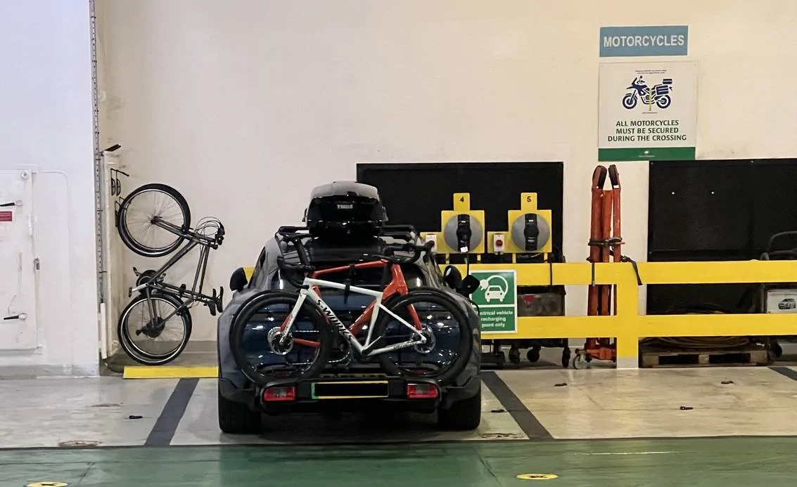

Just back from a half term trip to Ireland and wanted to say thanks for the heads up on the ESB card. Only used it in Kenmare on the 50kw DC there but did so several times over the week. Forgot to check if the Porsche card worked but it gave me a lot of peace of mind knowing I had the right card.
Despite roofbox and bike carrier I managed to get from London to Kenmare on 3 IONITY stops, Stafford, Kill and Cashel. I did 10 minutes at Tesla Flint to give the dog a walk but would have got to Kill without that percentage added anyway.
On the way back we left Kenmare on c.80%, charged at Cashel, City North and then as we were on the slow ferry got a very useful 33% top up which made Stafford reachable.
