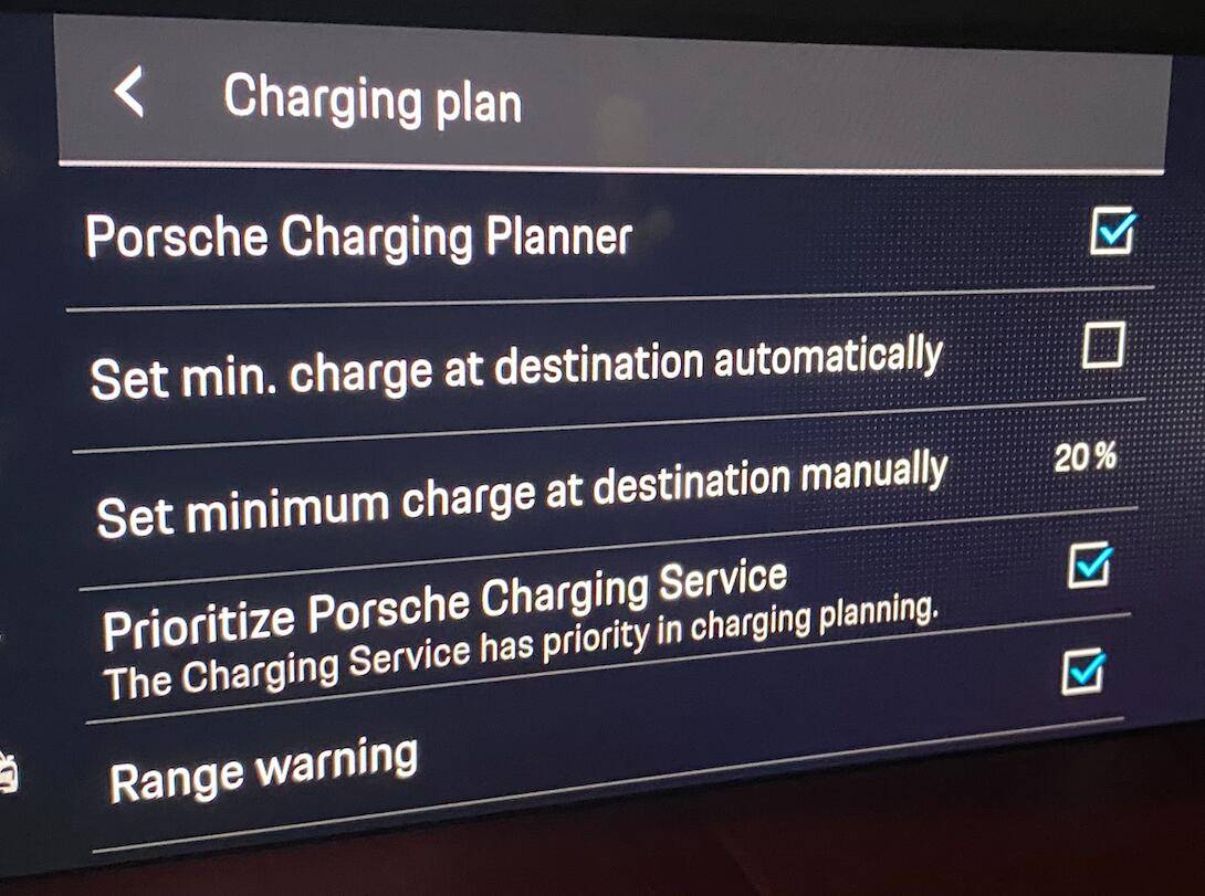

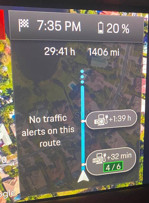

Curious what charging settings you're using under the navigation preferences. I was able to navigate from south FL to WI without it having issues looking for charging stations. Maybe there are just more charging stations along that route. It did take several minutes to calculate.
