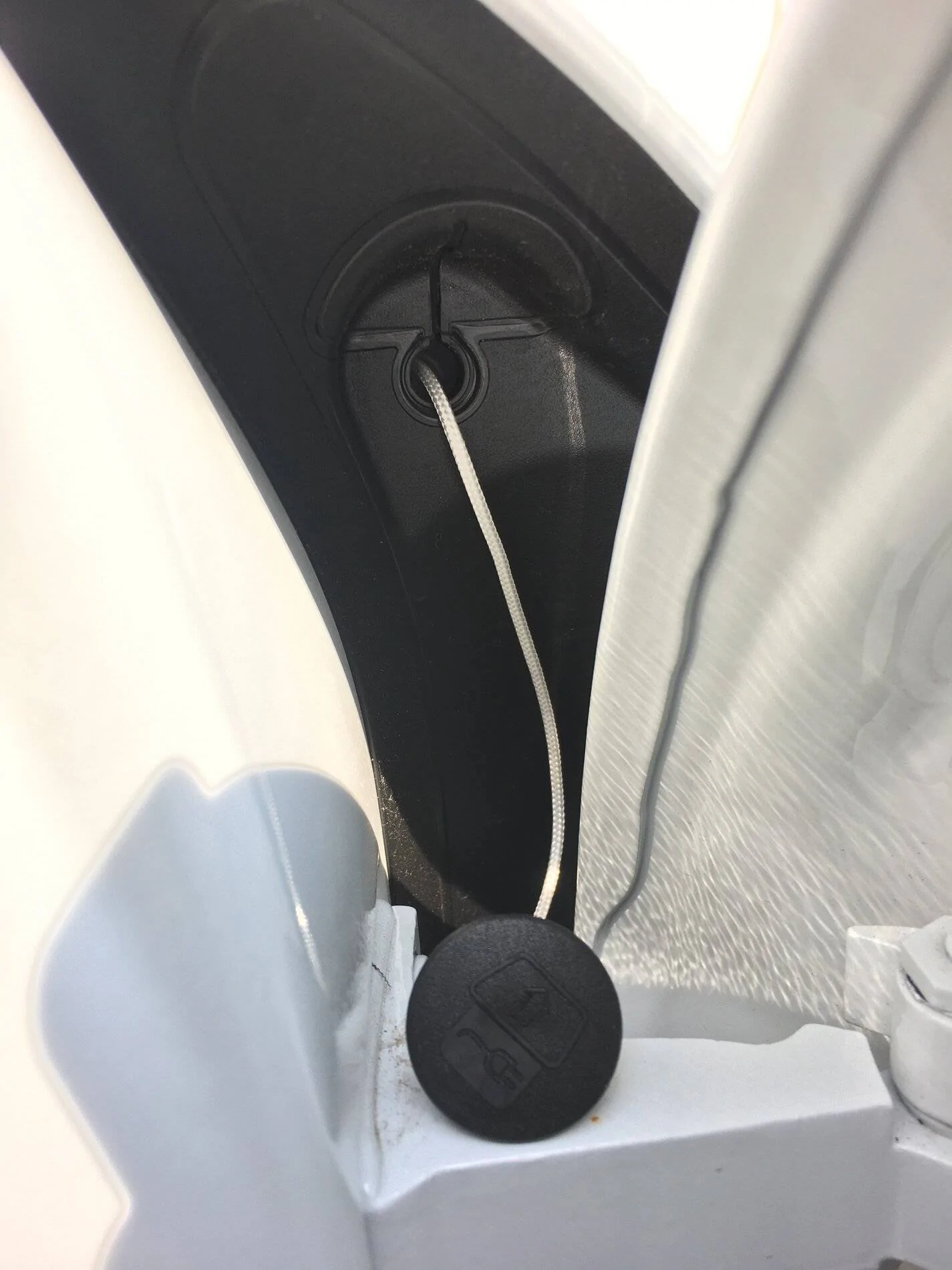

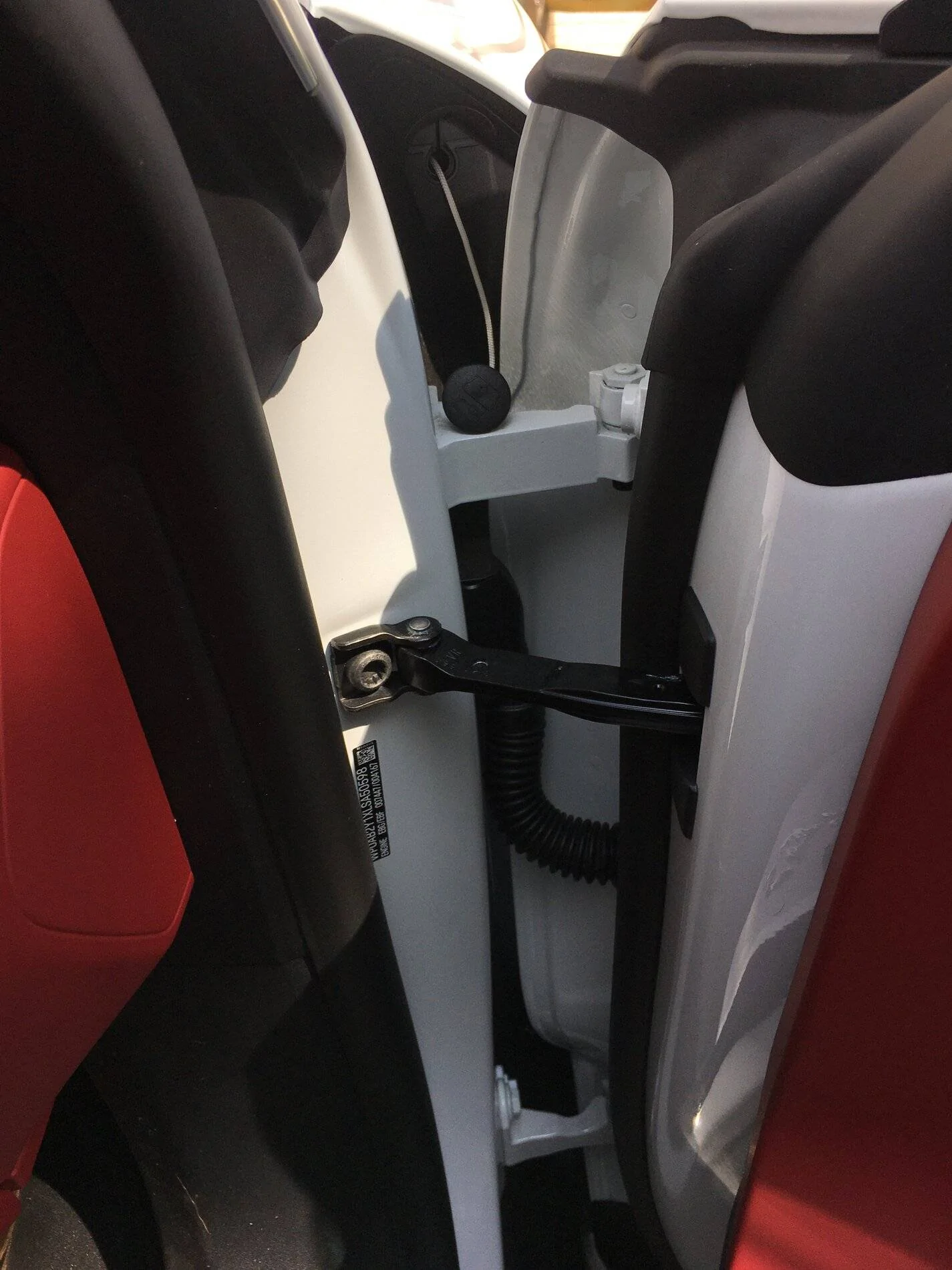

I have had my car for about a month and yesterday after charging overnight in my garage the charger wouldn’t release from the car. After reading the manual I was able to pull on the release that frees up the plug(see photos) I called the dealer to let him know what happened and when I should bring the car in as it was still driveable. He never got back to me and today the car Is inoperable. My guess is the 12v battery drained overnight which as I know now controls the electronics.
So pod1, can you please tell us if you altered the Charge profile the night this happened? That has been the finding by Don @louv is that charging profile changes while car plugged in triggers the issue.
Very sorry you are having the problem.
As with any new toy I may have been fiddling with the profile in the Porsche Connect app on my phone the previous night. But that’s not the first time I’ve done that.
Certainly I understand the temptation of playing. If you can refrain from profile updates you may find the issue does not recure, and just wait till a software update states a correction with charging and 12v battery issues.
