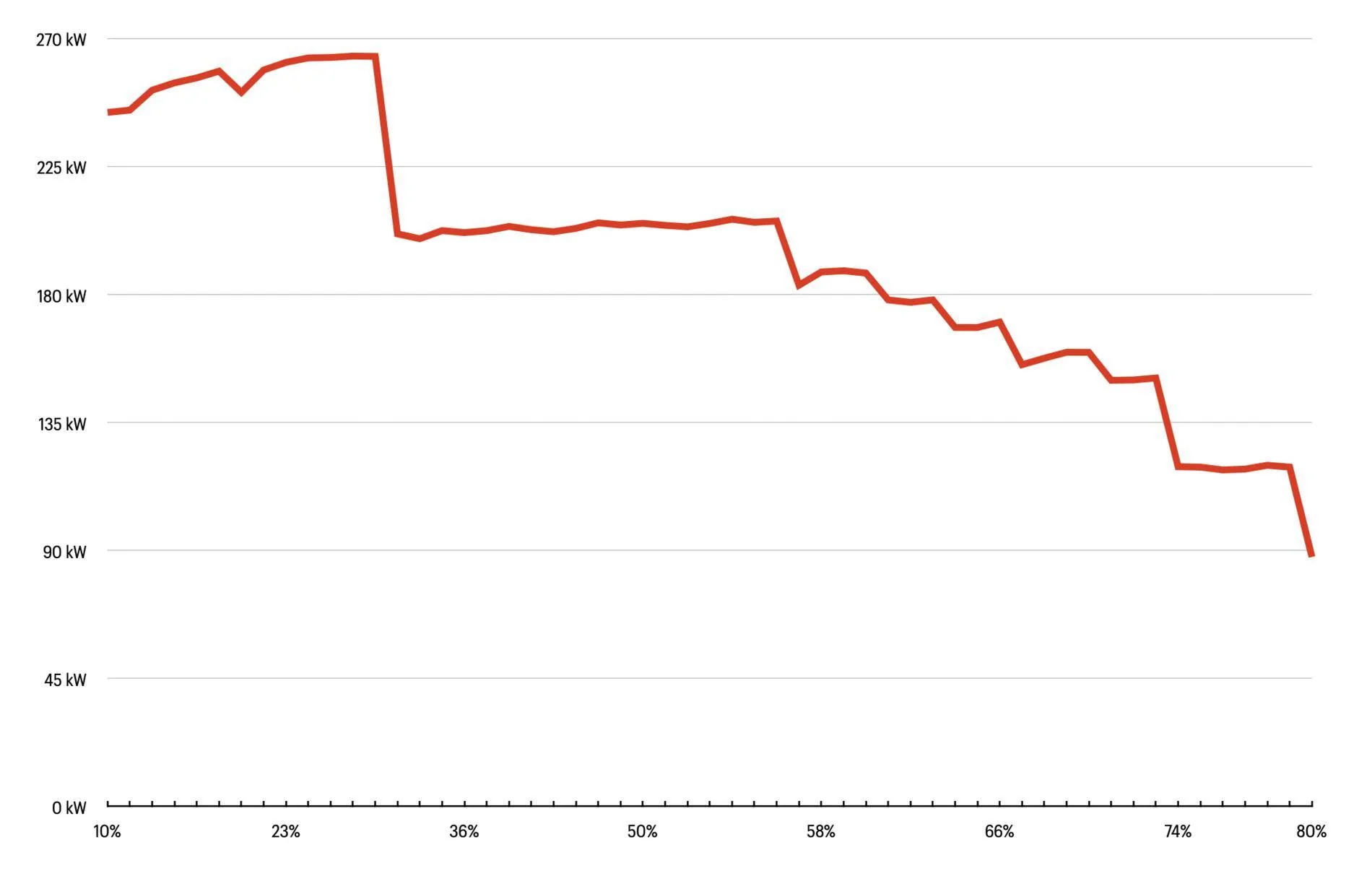

I made a trip last night for the express purpose of testing 350 kW charging from a low SoC in my Taycan. I've visited 350 kW chargers before, but never with a low enough SoC to really expect peak charging rates.
A few bits of background/observations:
  • The trip from my home to the chargers was about 50 miles. I entered the charger as the destination in nav to get the battery pre-conditioned
  • Battery temp on arrival was 85°F
  • SoC on arrival was 6% (FWIW, Porsche nav predicted arrival SoC at 6%)
  • Outside air temp on arrival was 44° F (a bitter California winter's night)
  • It worked! Charging initiated without issue using the ChargingAmerica app on my iPhone
  • Peak observed charging rate was 263.81 kW when I was at 27% SoC
  • Charging plateaus at just over 200 kW for quite a while (the long flat part of the curve runs from 32% SoC to 56% SoC, and averaged 203.58 kW)
  • The charge rate remained above 120 kW up to 79%
  • During charging, the battery temperature was as high as 124°F, but cooled quickly when the charge rate dipped below 200 kW
  • Recorded measurements started at 10%, but the charge rate ramped very quickly when I first plugged the car in. It was essentially the same over the 7-10% interval.
  • I tried to measure the charge rate at least every 2-3%. Most observations were in 1% intervals
  • I unplugged at 80% SoC
  • Total charging time from 6%-81% (it inched up 1% as I walked to the charge port to unplug) was 22 minutes, 14 seconds
Here's a graph of the charge curve:
Porsche Taycan Charging report: EA 350 kW at Gilroy Premium Outlets, Gilroy, CA 11-8 Gilroy EA charge curve

Interesting graph. The charging time etc is just what Porsche have said also. From about 5% to 80% in 22 minutes!
How did you manage to plot the graph? By manually reading or ....?
I took a photo with my mobile phone's camera for each data point, then entered them manually into a spreadsheet...
I'm not aware of any customer-accessible data logging facility. But boy I would love one.
